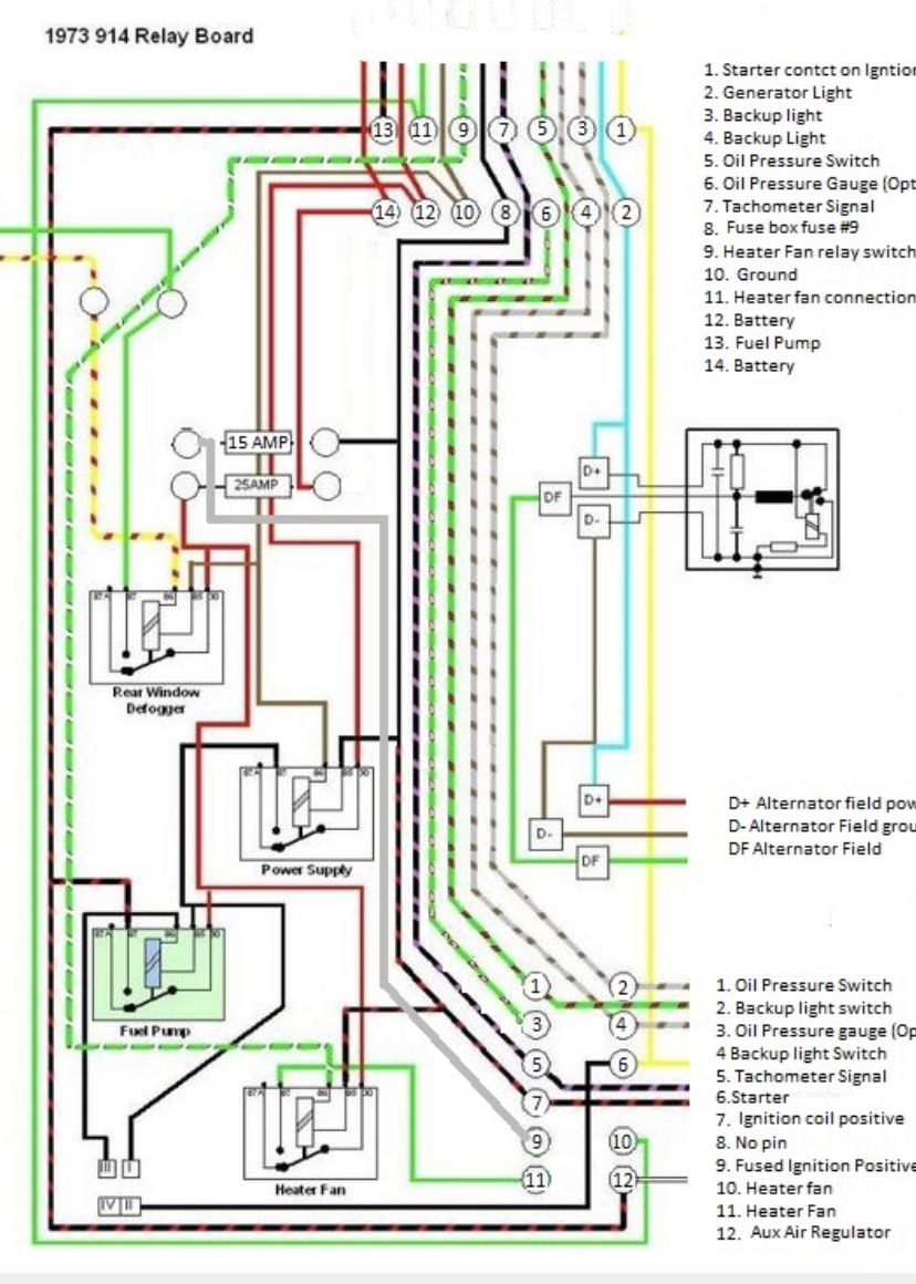

We've been trying to figure this out for a couple of days. The car was converted to carbs by the PO and was running and starting fine before I took it apart.
Now, nothing happens when key is in start position but we can start if we touch pole 2 (powering fuel pump) and 4 together from open FI harness plug receptacle.

Here is the relay board schematic
When key is in start position you should have 12v coming into the board on the top pin 1
And it then goes out to pin 6 to the starter. Via trace on the board.
Both are the fat yellow wire
If I understand the 4 terminal FI plug as you’ve labeled them - you are basically jumping 12v from the power supply relay to the starter motor pin 6
Eventually if you keep doing this you may damage the relay board. The trace from the relay to what your calling pin 2 isn’t sized to support the current your probably drawing through it.
You need to figure out why you don’t have 12v coming into the board from the cabin / ignition switch on the big yellow wire on pin 1

You probably have a bad interlock relay. You should h1ave 12V on the yellow wires into and out of thr relay with the key in the start position and drivers seat bellt latched.
No power out means a relay is bad. They are known to fail.
Easy to bypass by connecting the two big yellow wires.

Great result. I assume this is 4752900696 since 1974 had two relays, one attached to the side of this one. hat is the part # on the relay you just removed? Would you be willing to map the wires for me if I supply a drawing to fill out? I have the 74 drawing filled out, and nearly have the 1976 finished, but need the details for 1975.

There is a very small gauge wire from the interlock assem that is screwed directly to the chassis. A ground for the relay? Without the wire attached you can turn the engine over with the screwdriver trick but not with the key.
