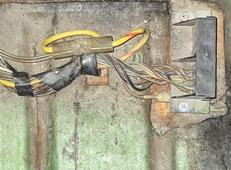

Regarding seat belt bypass-I pull the passenger seat, it looks like the bypass has already been addressed? Photo attached
Unfortunately it is FI, have to love 70s FI electrical gremlins….

Yes the interlock relay is bypassed. Check to see if you have power in the yellow wire as is comes from the ignition switch and then out of that connector. If you do check the fuel pump fuse on the replay board. It is the fuse closest to the back of the car. rotate all the other fuses in the fuse panel They often corrode and loose contact.

Thank you for the detailed suggestions. I gently pushed the AFM flap but no fuel pump. I moved to the yellow wire, no power or continuity. I figured I need to focus my efforts on the ignition switch and I found the relay was unplugged. I now have power to the gauges and the fuel pump kicks on when I push in the flapper.
If I’m reading the wiring diagrams correctly the yellow wire goes from my ignition switch to the starter. So next step I should think is the lack of continuity or power when the ignition is on? The starter does turn over if I jump the terminals.
The previous owner left a bunch of parts including a steering column so, along with the oddly unplugged ignition switch, I’m guessing they had identified this as a possible issue. Any advice on how to identify the source of the issue with the yellow wire?

No start with key. I should get some voltage on the yellow wire under the pax seat with key in the acc/on position? I ask because I’m seeing none. Thinking there may be a short in the wire between ignition and starter or the ignition switch is acting up (which could explain the spare parts and unplugged relay)

The yellow wire should be getting power only while the key is in the "starting" position. In "run" it should not, otherwise you'd have your starter engaged while driving the car, which is not what you want.

In the starting position I do not have power in the yellow/red stripe wire, I do have power in the yellow wire. Looking at the wiring diagrams I think the yellow/red wire comes from the ignition switch. So either the current connection of the two yellow wires is bad or the ignition switch is bad?
How would you have power in the yellow wire when it isn't in the yellow/red wire? It sounds like something is connected wrong, or we are talking about different wires than I think we are.

You have power, key in start position, to the yellow wire in this picture and not to the yellow wire with red stripe, in this picture? At this specific location?
