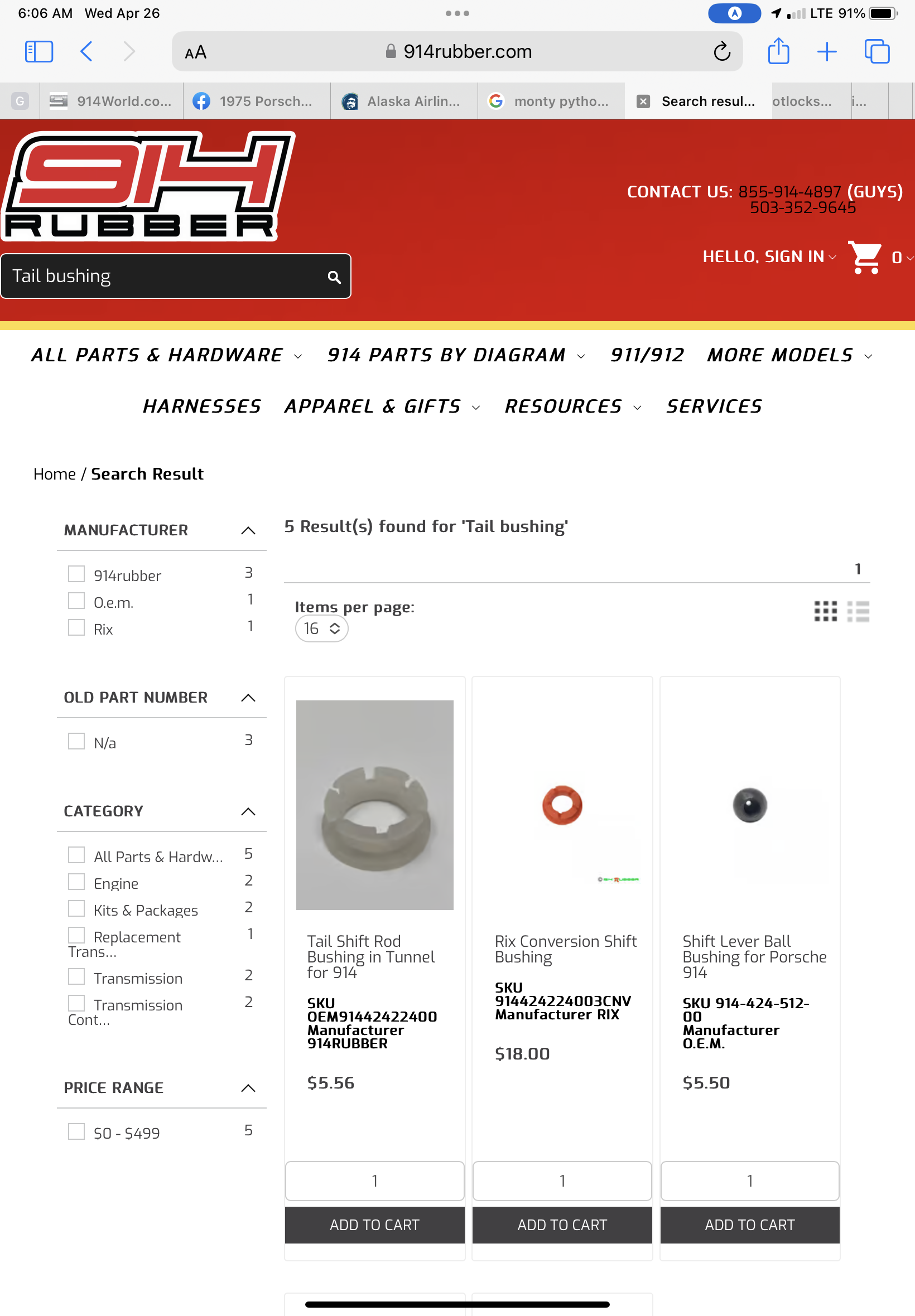

https://914rubber.com/tail-shift-rod-bushin...-tunnel-for-914

Thanks for the replies everyone. @Mikey914 , I intended to install OEM91442422400 but discovered that the ID is larger for the tunnel bushings than the rear bushing at the transmission. Wish I would have realized this prior to removing the old.

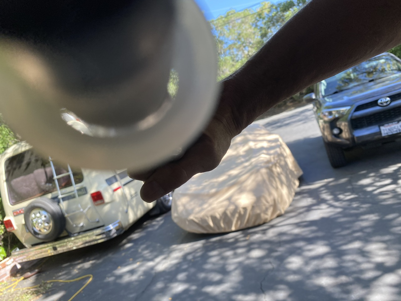

Here’s a pic showing the rod in a new bushing. There is a gap for sure. @fixer34 , thanks for looking up the part number.

QUOTE(markhoward @ Apr 26 2023, 09:18 AM) *
Could you take a photo further back, something doesn’t look right?

I spoke with George at AA. He confirmed that the 3 bushings are the same part number and that I should get German made ones. I may do that but for now, I’m doing this hooptie fix using Nashua aluminum tape to build up the thickness of the rod. Now it is a tight fit and should last a while. My plans for the car involve moving to a side shift with Chris Foley’s shift rod kit so this is definitely a short term solution. The play at the rear is not attributed to wear on the rod as I have the same problem when moving the bushing past the wear area and on to the original painted surface.

Member No.: 24,334
Is the bushing still loose on the rod even after it’s pushed into the bracket? Just thinking the fit might compress it quite a bit…

Of course, I can't find the order paperwork now that I offered, but I see you have a 'backyard fix'. I suspect there was wear on the rod, it appears that section in the first photo is shiny. As for trying it further down the shift rod, I believe it is slightly smaller diameter so that is not a good test. The last picture even appears to show it necked down a little past where you added the tape.
I will tell you from experience that the extra gap between the bushing and rod doesn't make that big of a difference; tail shifters are a bit loosey-goosey anyway.
