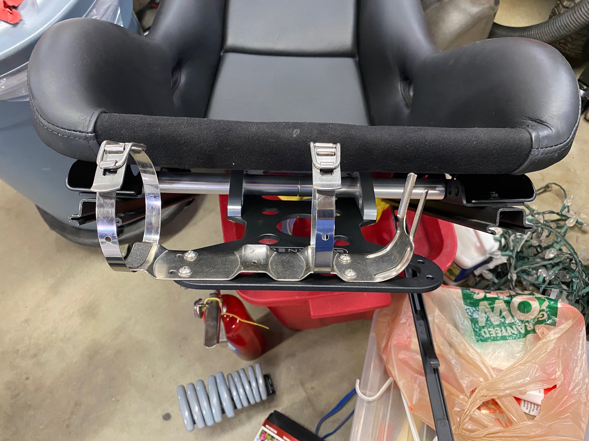

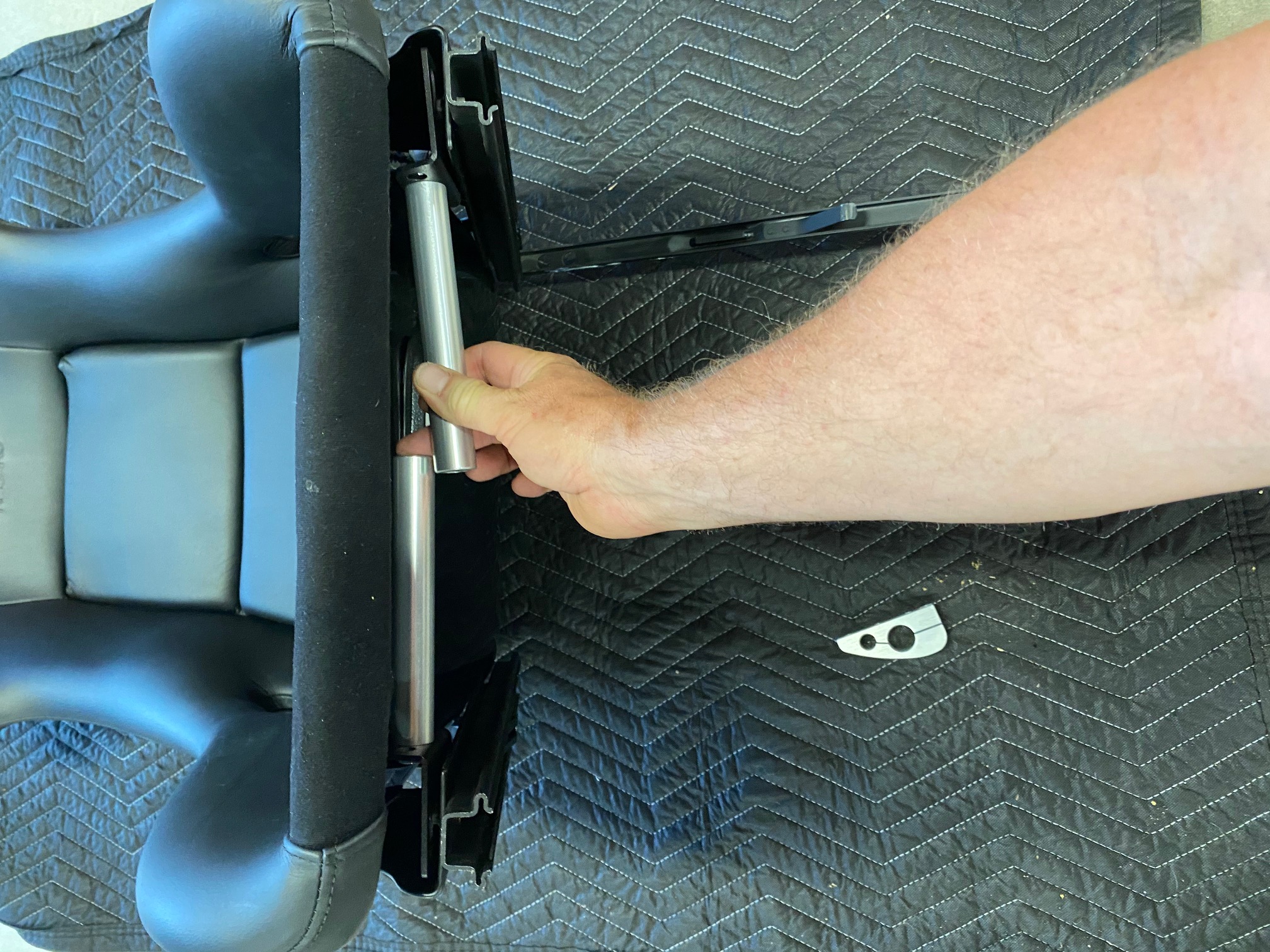

I did one a while back, no permanent mods to the 914 needed, did have to cut down the two solid mounts on the FE mount side then joined them with a dowel, worked out well, super solid--my "non-stock" seats are on stock seat rails:

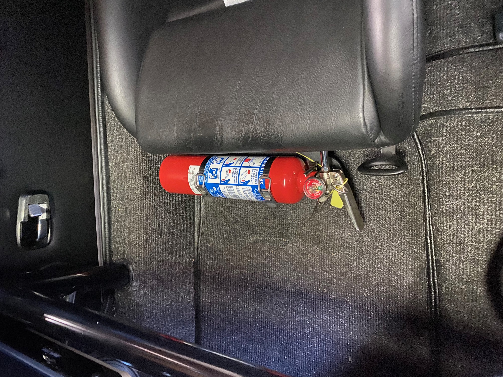

@Stef914
Here’s my hobo setup. Pics below. 5lb Purple unit.
I think I’ll replace the board with one that has a rougher bottom and is longer to extend past handle and bottom.

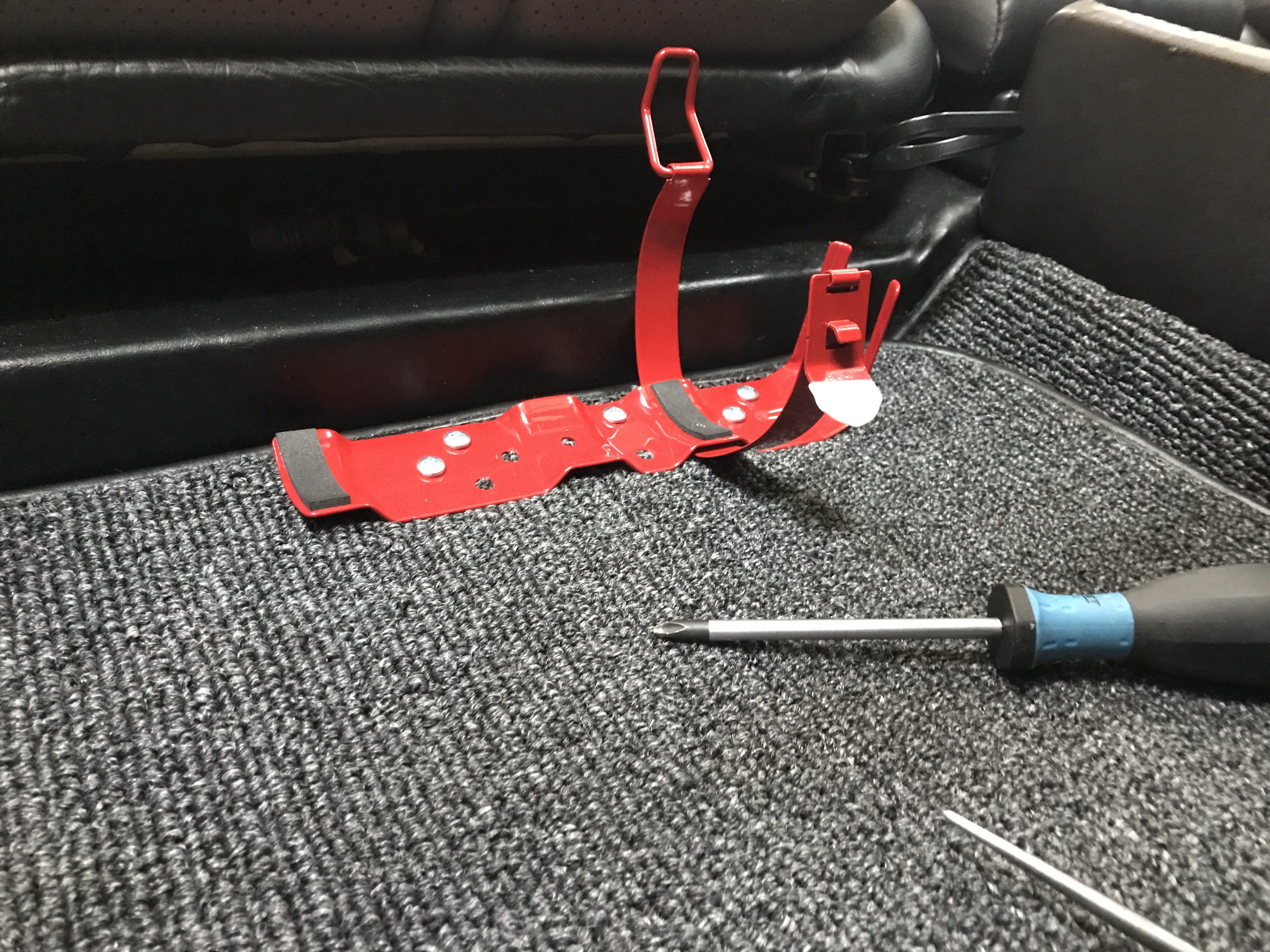

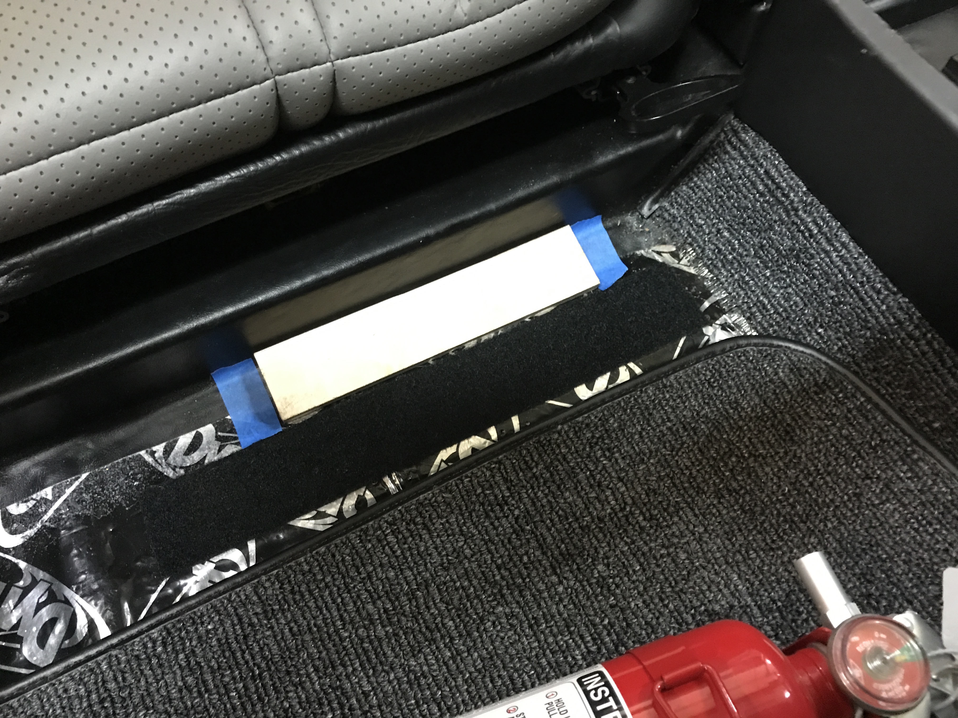

I glued a strip of plywood to the floor under the carpet, and then screwed the stock extinguisher bracket into that.

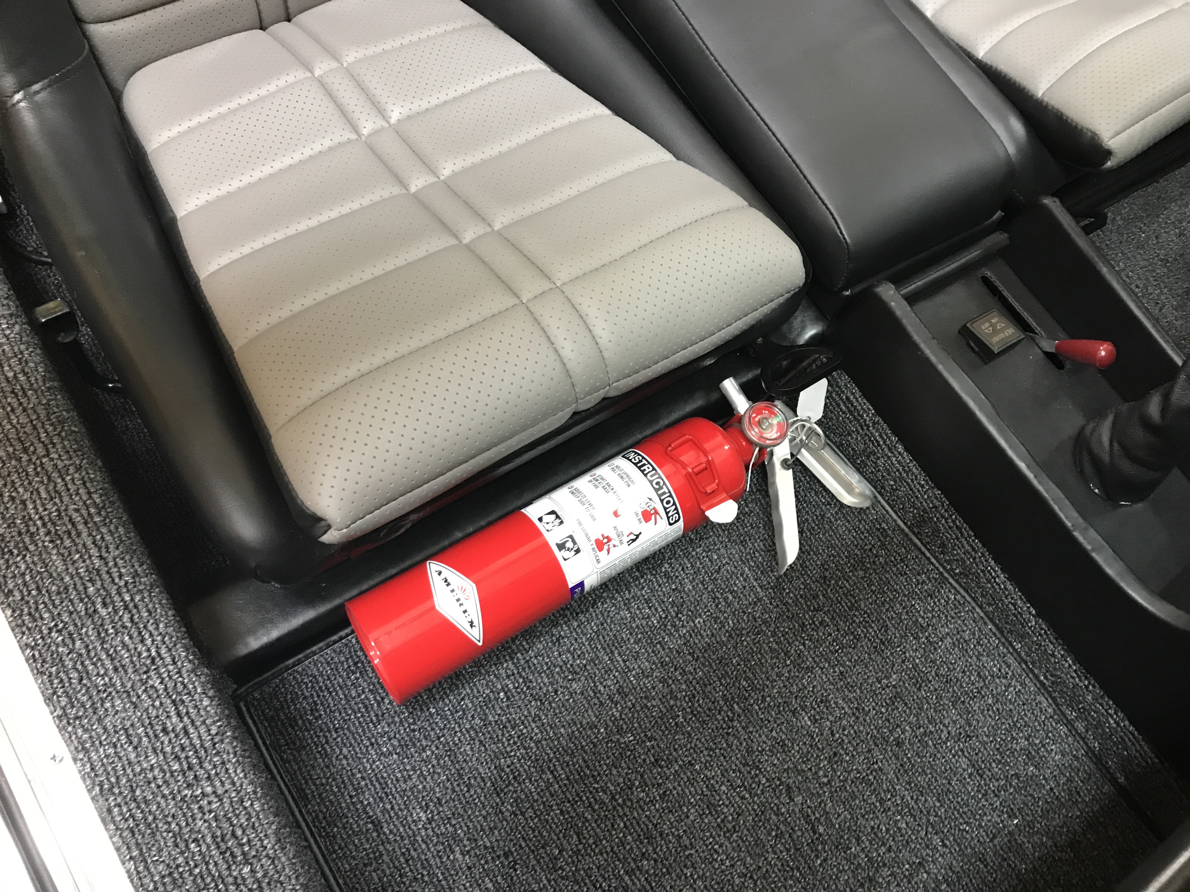

And this

For this

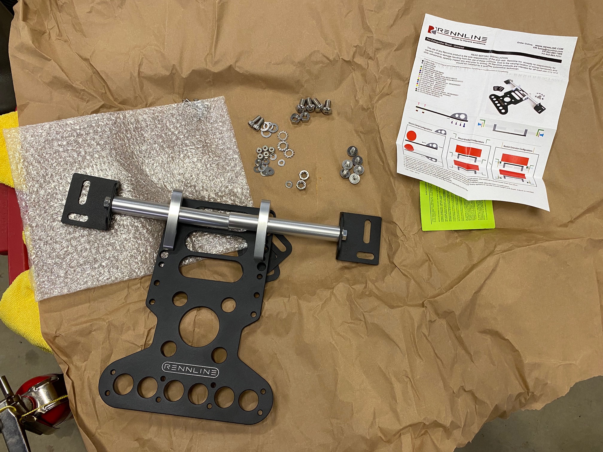

It's a Brey-Krause mount.
