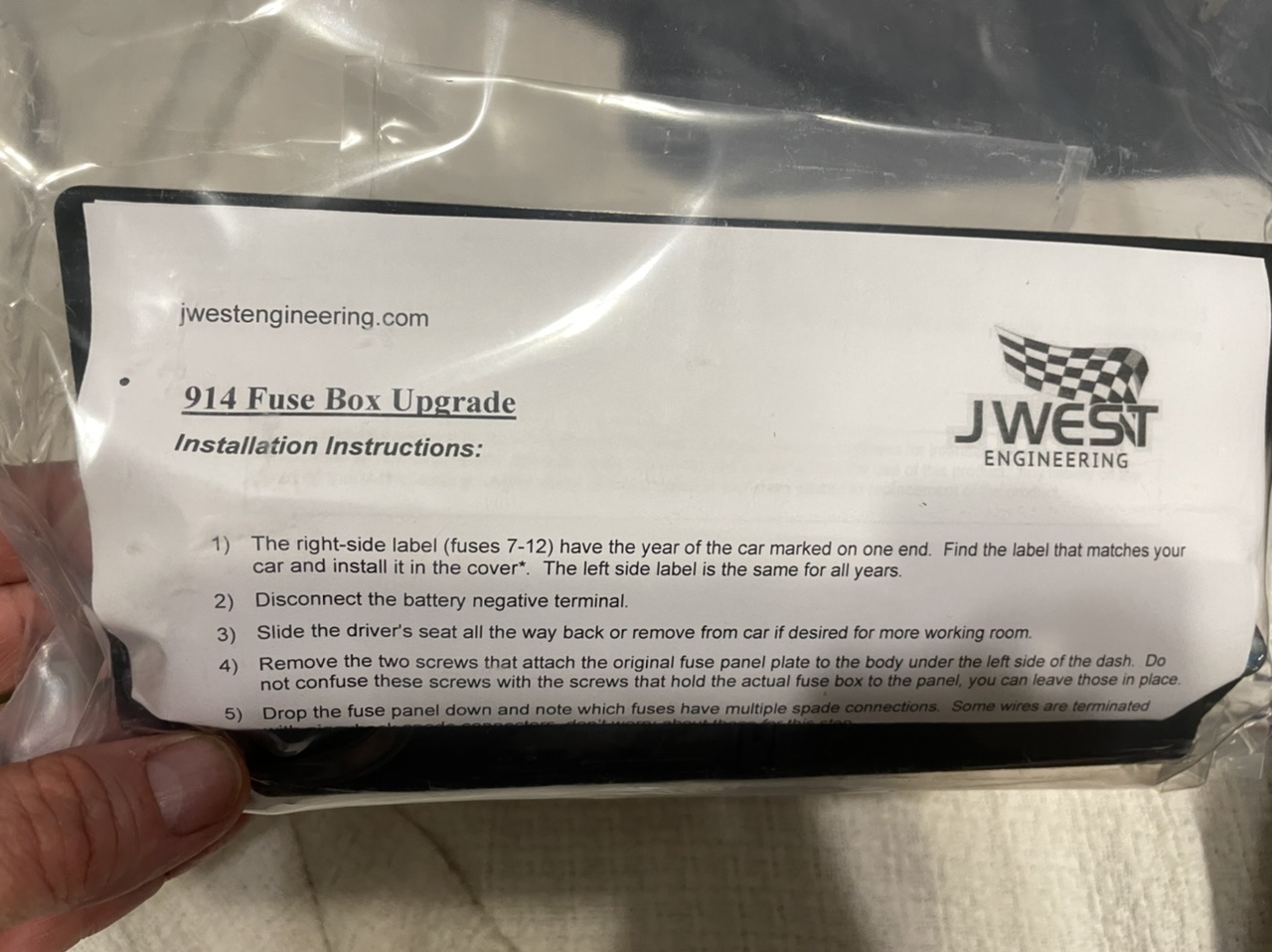

new board arrived yesterday.
Thanks J-West,
@jwest
