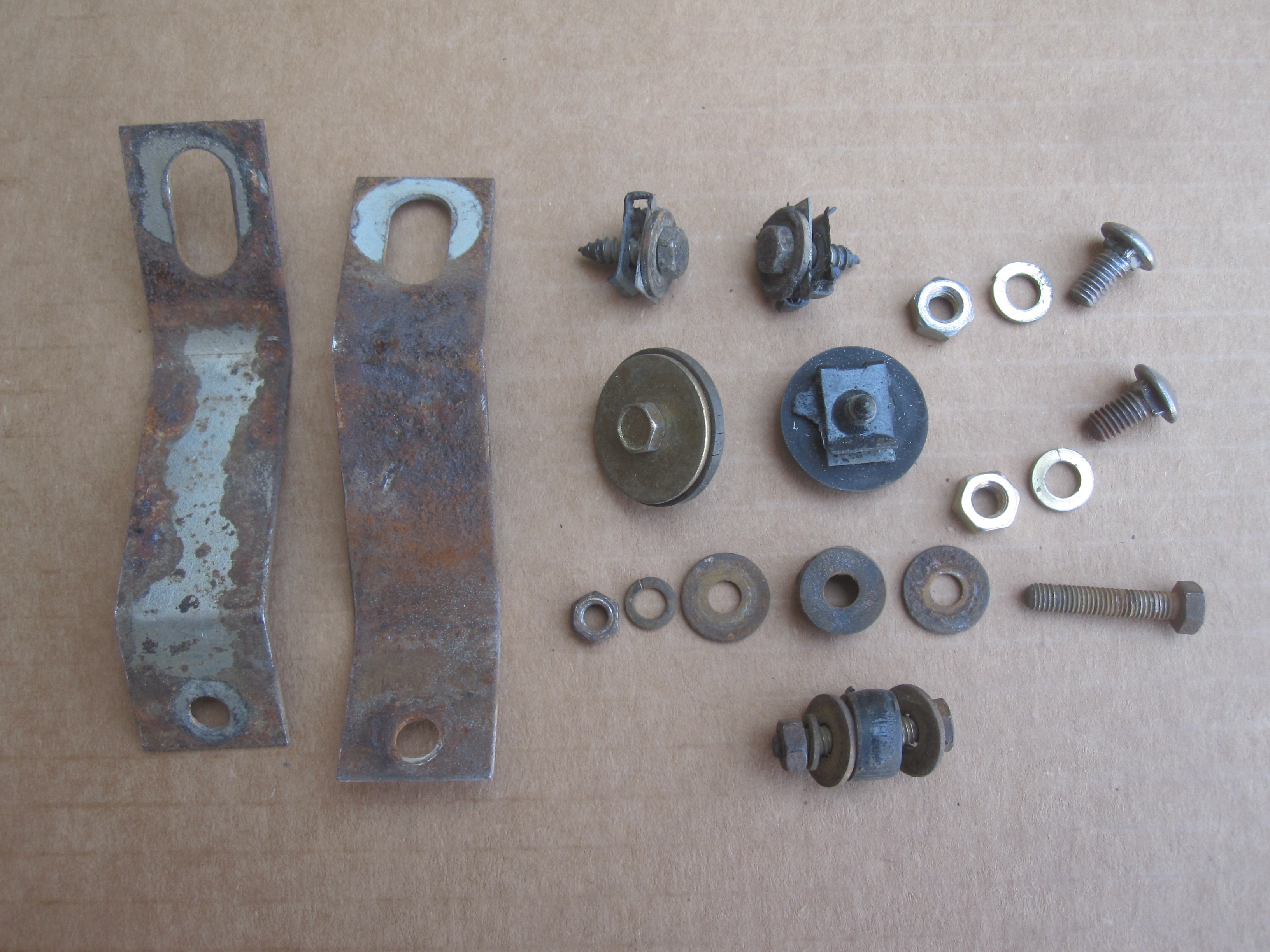

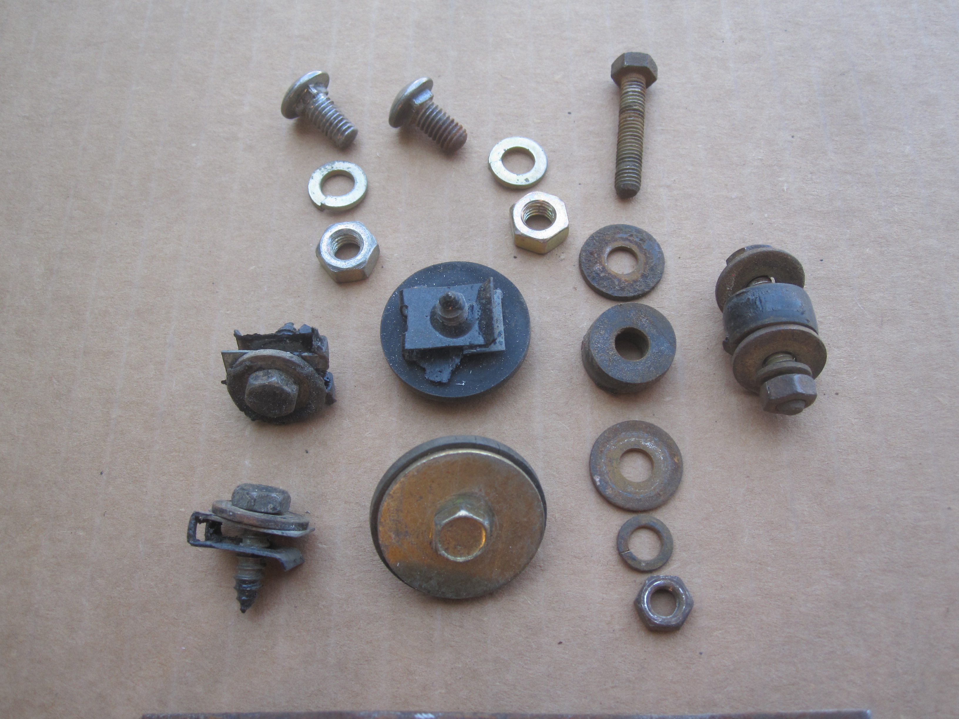

Complete original hardware.
Note color of plating on brackets and width of opening on tin clips.
The clips slip over thick edge or spoiler easily.
These brackets are bent 'square' at the small hole end, Marks are bent at an angle

I have seen 3 versions of the bracket. One version was in primer, one yellow cad and silver cad. The variation occurred as to when they were made.

Thanks for the detailed picture.
Where do the 10mm headed cad plated bolts with the large flat washers and the rubber washers fit?
These are in the center of the pictures.

Those two are tightened from inside the front trunk through the latch panel.
The rubber discs and large flat washers are to keep the interior of the trunk dry.
Actually an 8mm tool.
The two smaller ones are tightened from inside the front fenderwells through the latch panel as well. Same screw as above, just shorter.
All four pull the spoiler against the body with the tin clips slipped onto the edge of the fiberglass.
