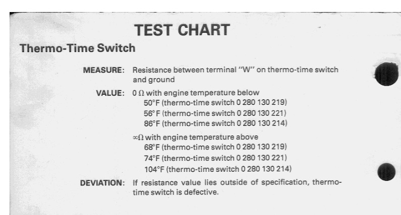

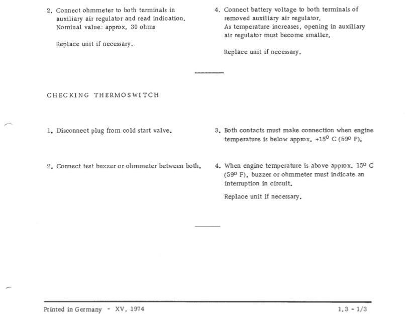

Now if I could find the test for the TTS, while I’m in there... (IMG:style_emoticons/default/smile.gif)
