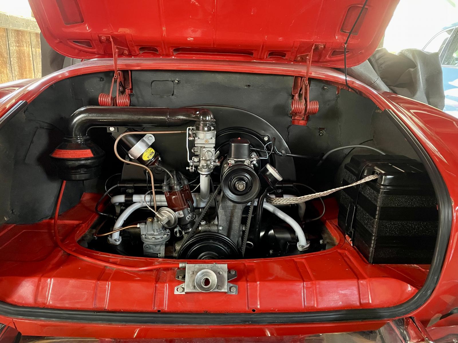

Here’s a walkaround video of the ‘59 Ghia.
I brought it back to 6 volts:
Craigers17

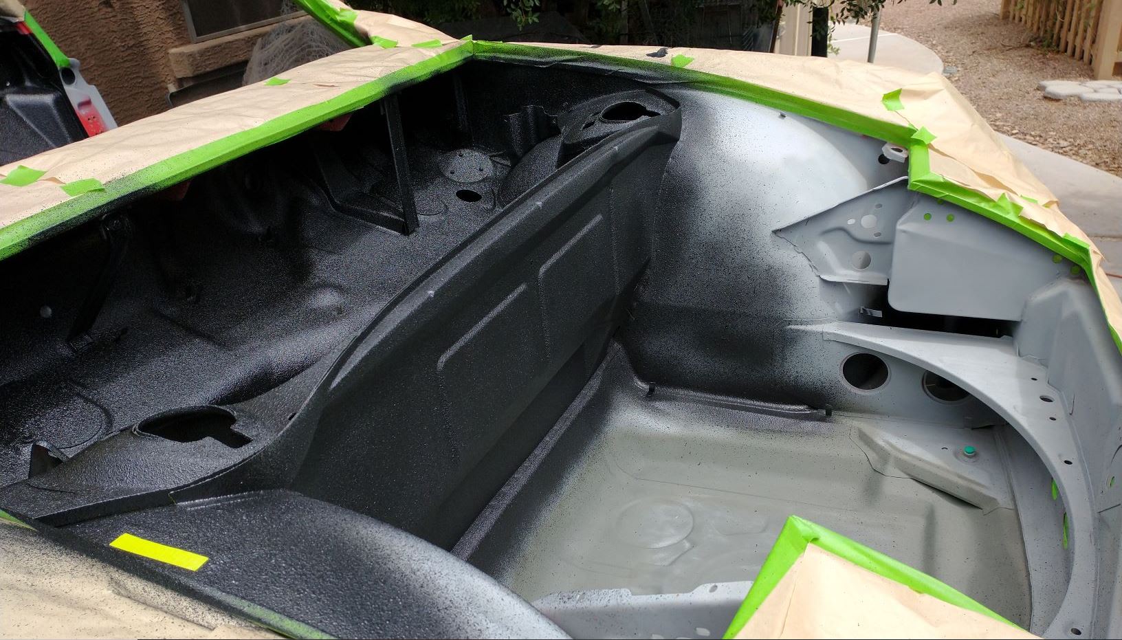

I'm in the East Valley (Chandler, AZ) not far from Scottsdale, but I'm not sure I can really add much value beyond what has already been pointed out. I've never driven/ridden in a 914, so no help with what it should feel like, etc.
I personally would focus on the front end hit/damage. It really doesn't look right, or like it was repaired well.
Here's the same areas of my '74 for reference. You can clearly see it almost looks like a new "half-circle" support was welded in - the support that wraps around the spare tire. It really doesn't look correct to my eyes! I'd be asking a lot of questions about the damage & repair (IMG:style_emoticons/default/confused24.gif)
Just a thought - the PMS work on the car was just in July. Might be worth trying to call PMS and see what they can tell you about the car. Mr. Patrick took a good 20min to chat with me when I just purchased some fiberglass flares from them...
