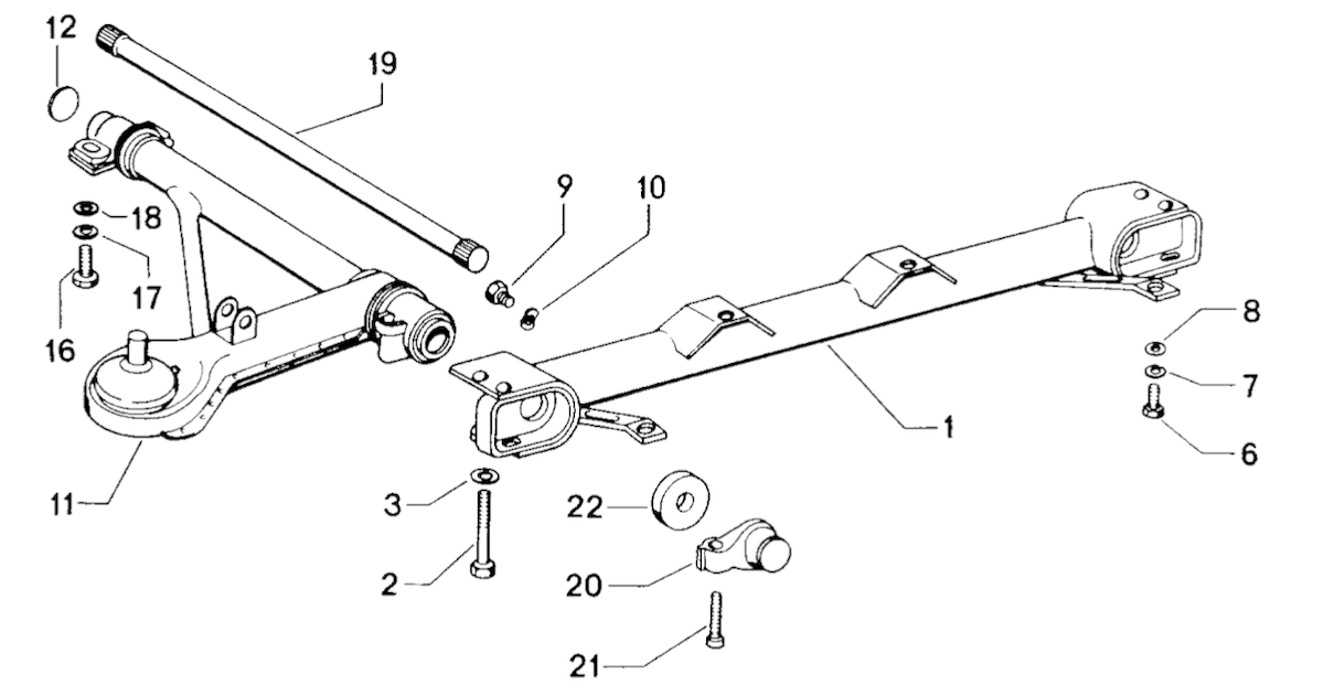

QUOTE(barefoot @ Aug 27 2023, 10:01 AM) *
By all means replace at least the rear bushing in the front a-arms. That will have sagged to the point that the torsion bar is rubbing on the ID of the arm, loosing paint protection thus leading to corrosion and torsion bar fracture.
Thanks for sharing. Had not read about this. Are you referring to #22 in the parts catalog?
While in this section, I see a note that front stabilizer is 73-. Is that correct? No front stabilizer on 914-6? Ours currently has one. I assume that since I removed the rear I should remove the front as well. If removed, what goes in its place? Is there a plug for the mount?

Is #22 the foam disc that goes on the torsion rod? ICRS. That screw shown holding the Sway Bar housing/bushing to the wheel well is incorrect.

QUOTE(DennisV @ Aug 27 2023, 07:22 PM) *
The bushings are not broken out in that diagram. They are located at each end of the A-arms. The front are under the two flange brackets directly behind #12 and the rear are under the single loop bracket at the back end (#9 is closest).
If you're going through the BS of changing the rear, you also change the front.

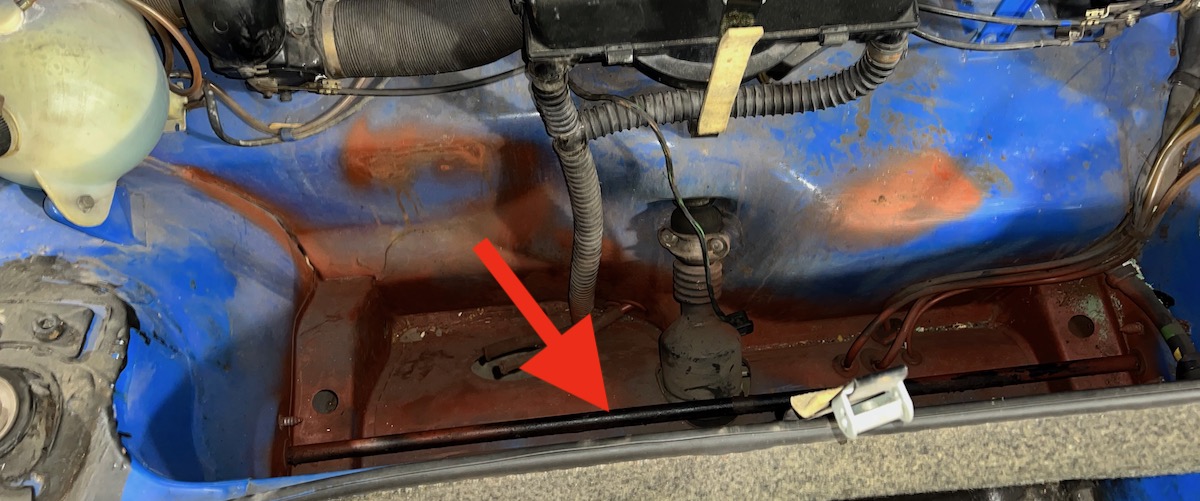

The holes in the body that the bar passes through were not cut into a car that didn't come with a sway bar. Extensive metal work is required to patch those holes and it would be difficult to restore the factory "look' as the patch panels would be evident.
The A-arms have also had tabs welded to them that would have to be removed. These are actually shown in the diagram, the little u-shaped bracket on the top of the a-arm.
Personally, I'd leave it in. The front bar usually helps the stock cars handle better.
It is a normal period correct mod and will be very difficult to completely erase from the car.
The rear, not so much. Some folks don't like the rear bar at all.
No, it's the big bushing hidden inside the A-arm.
The one you show is just to sort of seal the cavity behind the bushing.

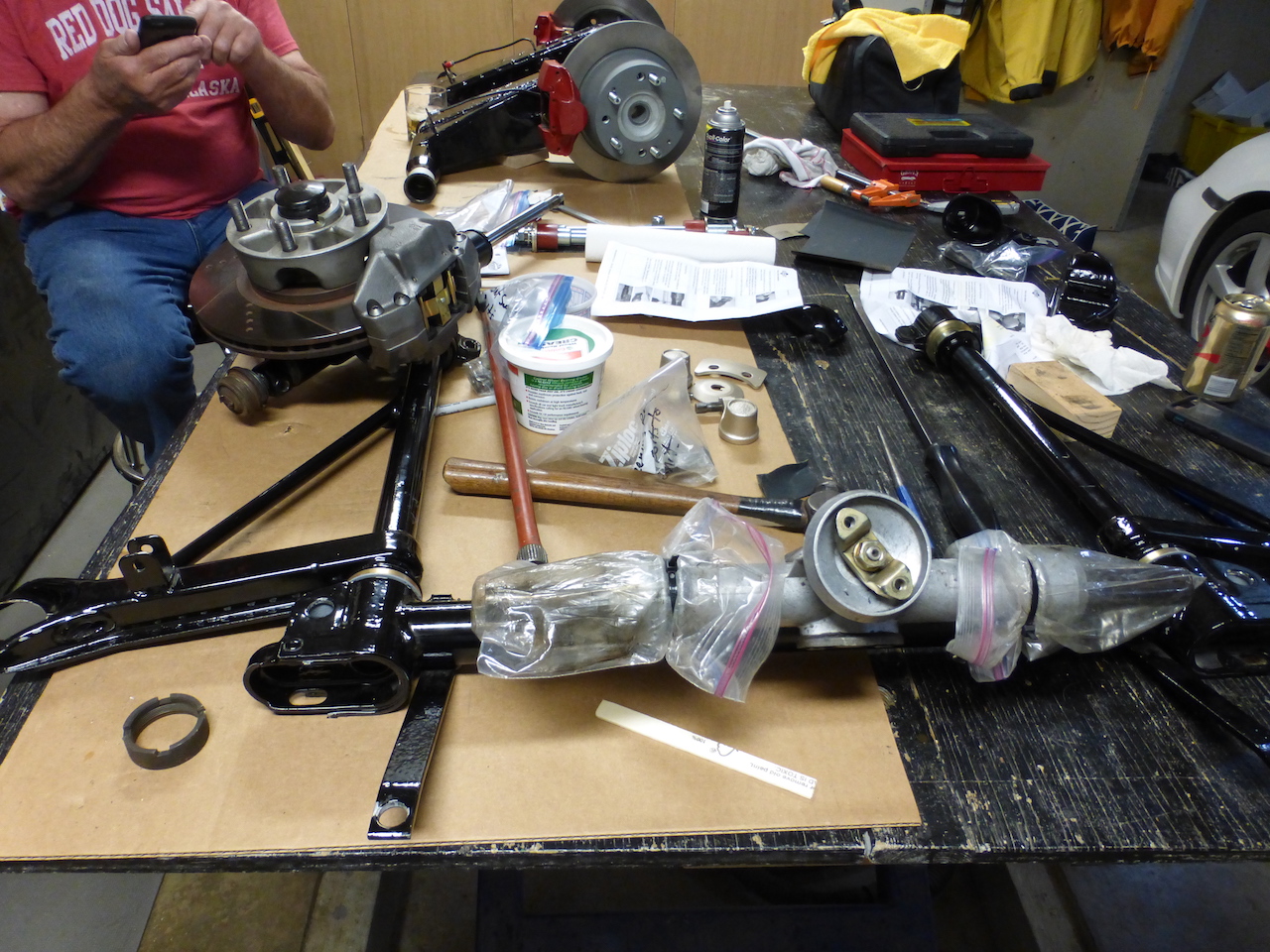

This is what a bunch of front end parts look like for a 6
Bob B

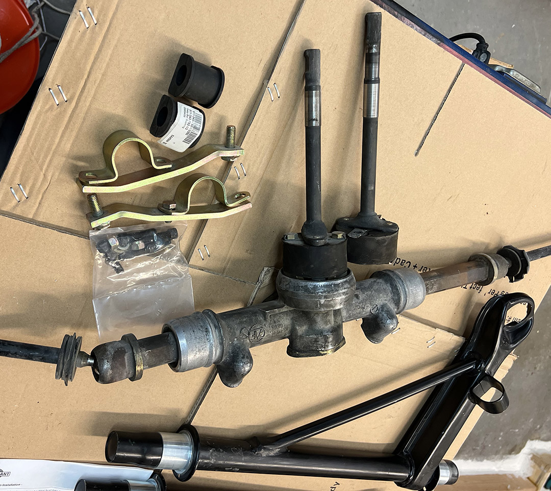

Dennis, Does your rack and pinion come from a 914 or since it was assembled in the Porsche factory does it have a "ZF" box like a 911. My reason for asking is because our real 6 has been apart for 35 years and I have 3 914 R&Ps and three "ZF" with a large ZF on the casting. Al
burton73
post Aug 28 2023, 04:22 PM
Senior member, and old dude
Posts: 3,989
Joined: 2-January 07
From: Los Angeles
Member No.: 7,414
QUOTE(Al Meredith @ Aug 28 2023, 02:45 PM) *
This is the ZF rack and pinion that came with this 85 Carrera suspension I bought 14 years ago. Note there is a difference in the length of the part that goes up to the steering wheel in case people are swapping out a whole front end from a SC or Carrera, they need to change to one or the other I just don't remember what which was longer? I went through the same thing when I put a SC full front suspension in my 1974 2.0 back in 1979. It was a super fresh one and it worked great Under sway and all.
Bob B
