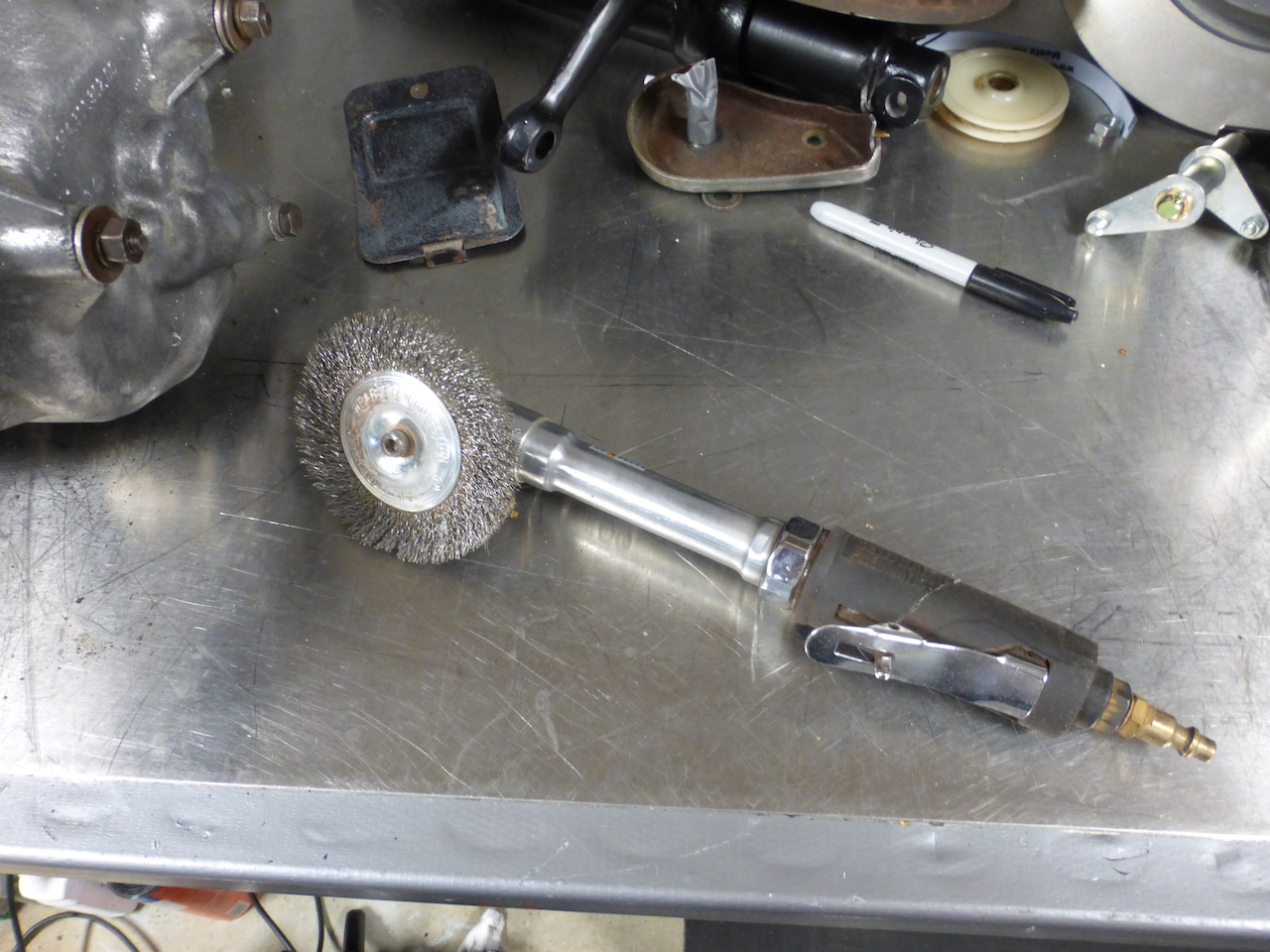

Sounds like you have a good handle on it. I had to beg the painter I wanted for almost two years before he said yes (start early). Also, best tool for removing under coating and loose rust ever ( HF extended cut off tool, but instead of the cut off, take the two inch wire wheel and cut off the 1/4 inch drive post and drill and mount. I cleaned the entire underside and all four inner finders in a after noon. Need eye and face protection . Best, MarkAttached Image

Member No.: 24,877
QUOTE(mlindner @ Nov 24 2023, 12:07 PM) *
" in an afternoon" when did you accomplish this" in your 20's? (IMG:style_emoticons/default/chowtime.gif)
