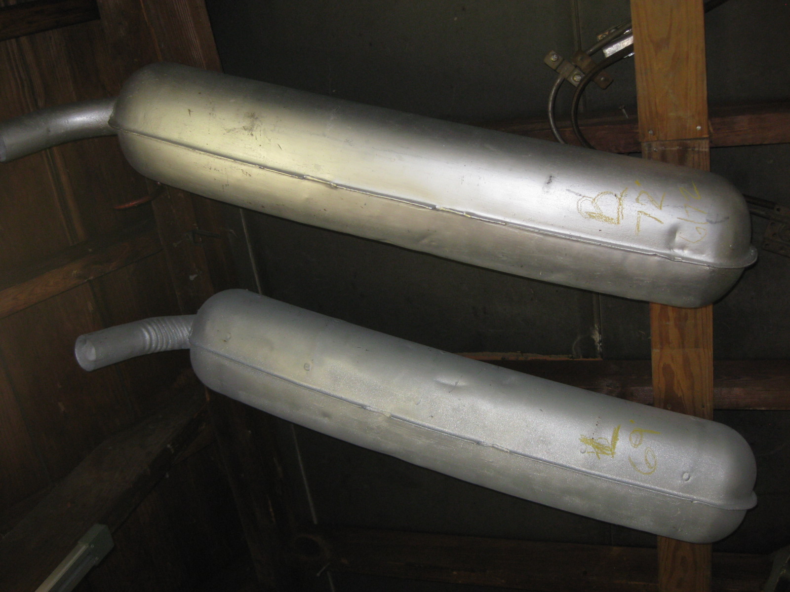

Looks like the Leistritz muffler I have which has a 1969 date code...the one on the bottom....Leistritz and the Bischoff mufflers were factory installed....you can usually find a date code and model # stamped in on the bottom of the factory muffler....the 911 models tip have a downward and outward angle....the 914-6 model tip is more straight backward. You can see the the tip angle better on the 1972 Bischoff muffler on the top and the tip is a smooth pipe like most mufflers.

The date code is usually located on the bottom... on the side opposite the outlet tip and near the inlet pipe
Your muffler looks in pretty good shape so you should be able to find the numbers.

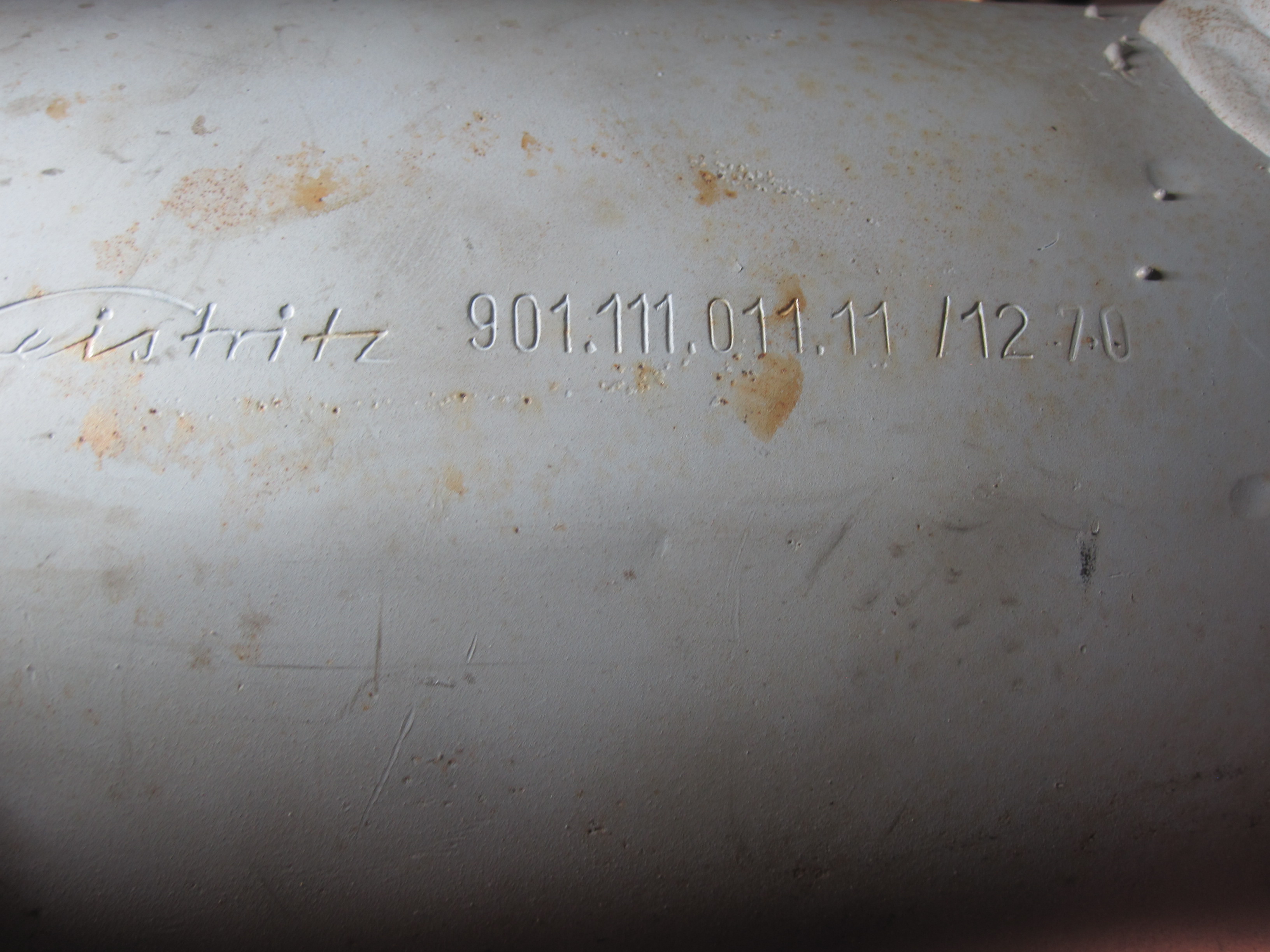

Good eye John. Thanks for your suggestion regarding date code and model. I took another pass and found this obscured by a lot of dust.
901.011.08/04 70
901/1
I guess this makes it a Leistritz for 911/12 from April 1970.

I'm surprised to see such a wrinkled tailpipe on an OE Leistritz.
It is 911 only. 912s are quite different.
OEM '6' Leistritz shown. Found on bottom of muffler toward tailpipe side
