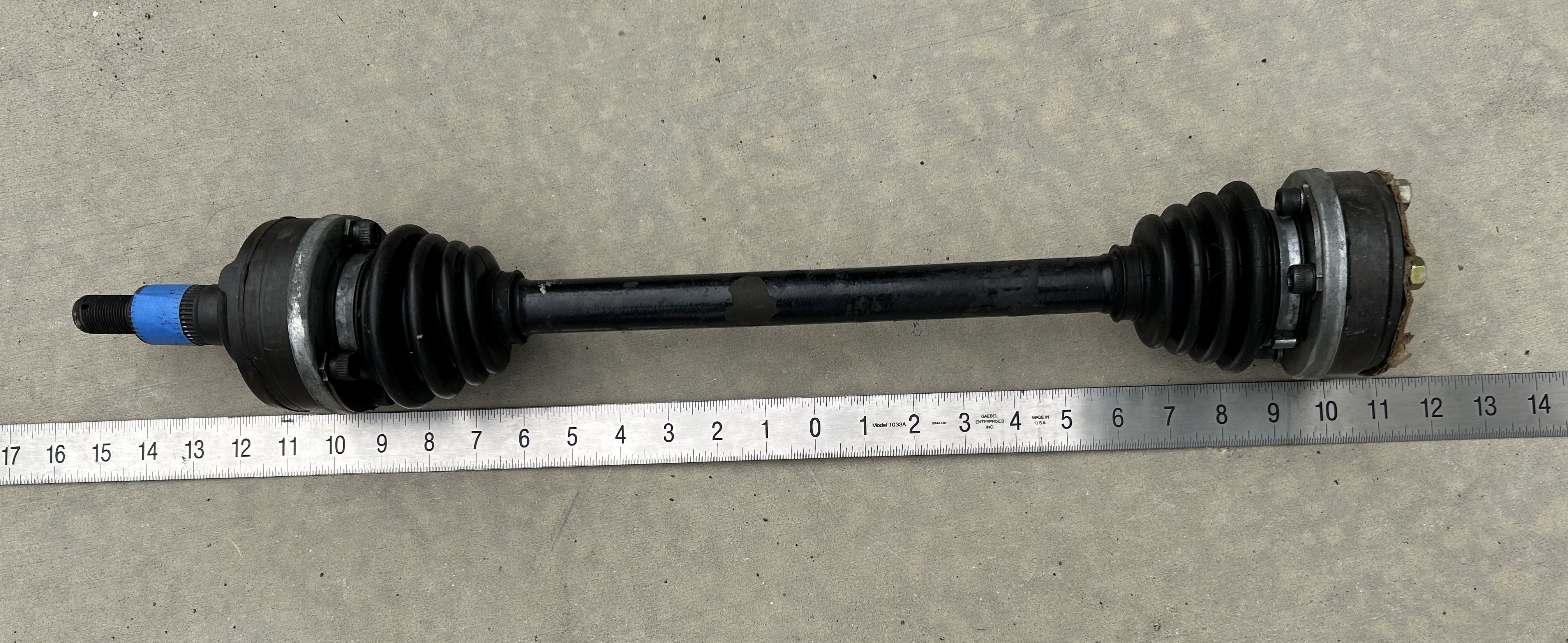

I want to verify this axle combind with CVs is for a 914.
There are 37 or 38 splines on the stub axle.

Can we assume this is in the 27" range?

24 1/2” from end to end; 25” if i pull on one end

Those look 4 bolt to me.
Did other Porsches use 4 bolt CVs?
I thought 911 stuff was all 6 bolt.
My 914 axles (75) are also 24.5 relaxed, tip of stub axle to rear face of cv.
Mine have 37 teeth.
Looks like you have a winner there!

Thanks ! I recently bought a matching set, but will be putting up for sale. Just wanted to verify they are 914
