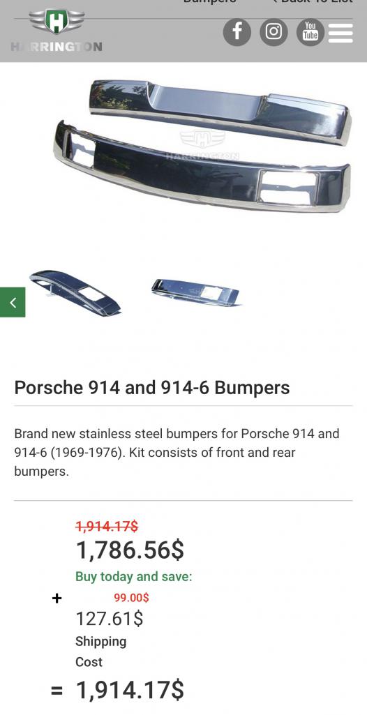

Inquire at Group Harrington
for Stainless Steel Bumpers..
Buy from the Manufacturer….

I know the SS bumpers seem pricey, but in reality, the cost to buy bumpers, have them straightened and chromed, you would be better off with SS. We really need some update photos of the car with you working on it. (IMG:style_emoticons/default/beerchug.gif)

You have to buy these from George at AA as he has the distribution deal in the USA
His price is a number of $100s more that shown on Harringtons site. Look at AA for the price. He has them in stock
So that is out as far as the price shown from Harringtons site. Ask Oscar what he knows, he is a super nice 914 Buddy and has been a source for chrome bumpers for a while

Dear Robert,
Thank you very much for your interest in our products.
I am afraid that the bumpers we supply are the same as Auto Alanta.
Also, we have given exclusivity of US market to Auto Atlanta http://autoatlanta.com.
Saying this, we can only supply you when the bumpers is sent outside of the US.
Should you have any questions, please don’t hesitate to contact me.

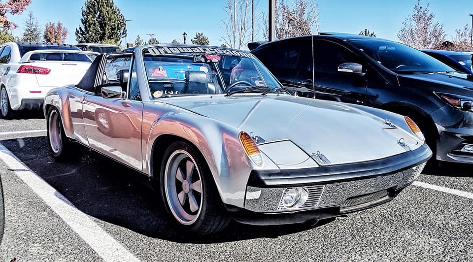

When we restore our old cars, the tendency is to pack as many ‘options’ in to the finished car as possible, forgetting that most of these cars didn’t come all optioned out. I am guilty of this myself. Consider the painted option? Done right, they look great! I like the flat black look.
As others have pointed out, sourcing, chroming, is expensive. Here’s mine, I think these cost me $2000 or so by the time I bolted them on. That, was 20 years ago!
