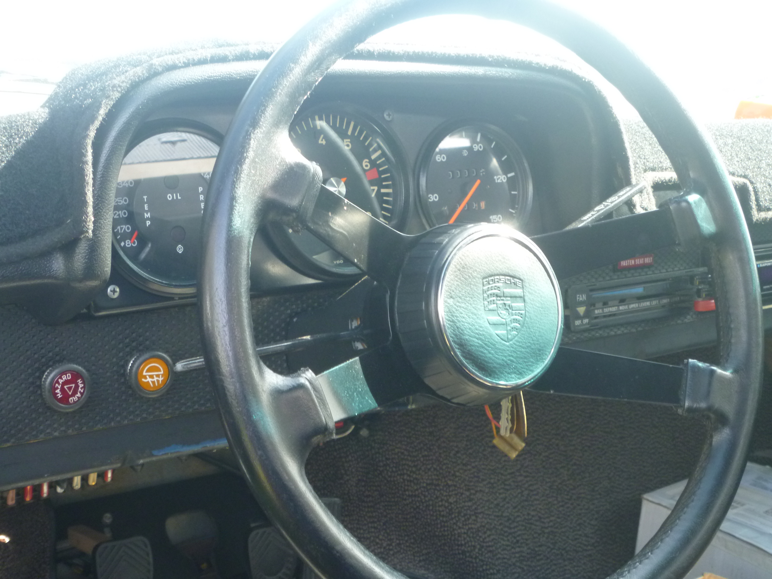

emerygt350
post Sep 3 2024, 05:48 PM
Posts: 3,842
Joined: 20-July 21
From: Upstate, NY
Member No.: 25,740
Mine keeps you from hitting the horn and still looks better than the bat wing. Which is waiting in the bat cave for when I would like to hit my horn at random moments.

My dimensions at the base are 100mm OD 95mm ID and I have a 19mm depth cavity where I mount the metal base for the horn mechanism. The fit and clearances are all good.
