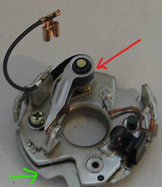

I am usually good with instructions, however, I am at a loss in this conversation.
Can you point (no pun) them out to us within this picture?

Superhawk996
post Oct 9 2024, 07:30 PM
Posts: 8,102
Joined: 25-August 18
From: Woods of N. Idaho
Member No.: 22,428
Circled in green, thin arrow in red. Should be self evident which is which. (IMG:style_emoticons/default/biggrin.gif)
