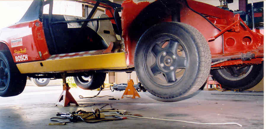

Here is a picture of my car on two, yes two jack stands. I had it on three until my 7 year old girl picked up the front end, so I did a little shifting around and got it to balance on tow.
Don't try this at home. This is kinda a stupid thing but a finally found a subject that I could post this picture with. Paul Attached thumbnail(s)

great pic --
that's exactly what i'm gonna do! i can't wait to crawl under it...... (IMG:style_emoticons/default/wink.gif) |
