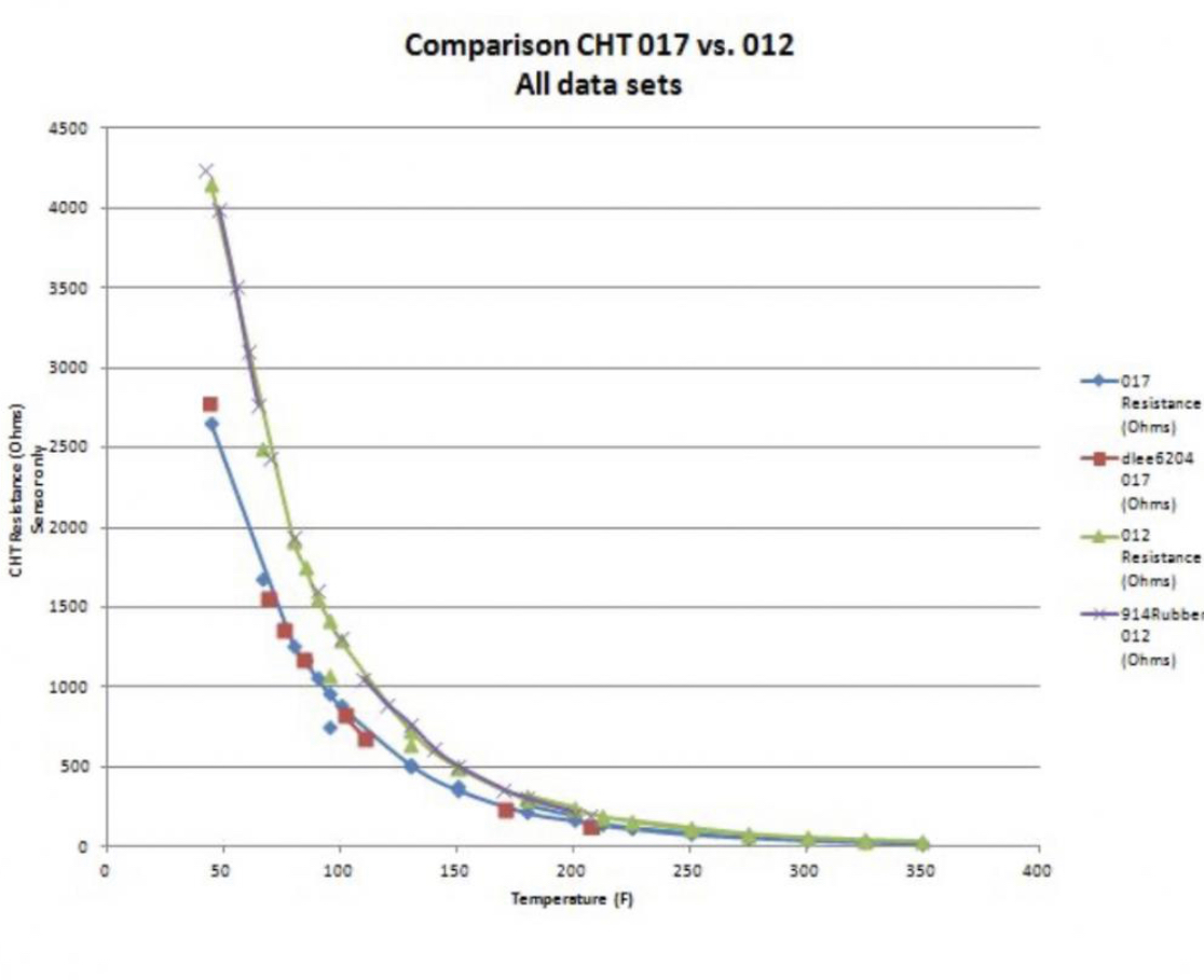

The ballast resistor works against you when the engine is at ambient by raising resistance by 270 ohms higher than the already high value (approx. 1300 +270 vs 2500 + 270)
However, when the engine is warm and the CHT goes to say 100 ohms, the engine is going to run lean(er) without the ballast resistor present. At that point not having the 270 ohms in the circuit is a much bigger difference as a percentage (approx 100 ohms vs 370 ohms so almost 4x more)
See attached plot for CHT 012 vs 017 (correct for 73’). Not how they converge when hot.
The way you’ve measured CHT so far is fine but be aware that you could still have an open circuit between the wiring right at the CHT and the ECU. Do not assume the wiring is OK. There are a lot of very crispy 50 year old harness's out there. I’d be looking at the wire very carefully. Chances are it’s probably not broken given it was running previously but at some point you may have to measure it at the ECU to verify.

To get rid of the question about the CHT. Get a 1300 ohm 1/2 watt resistor (or dial in a potentiometer to 1300 ohms) substitute that for the CHT. One side to the harness, the other side grounded to the block (fan shroud, or battery negative OK too). The adjustable potentiometer is the better way because assuming it starts you can dial the pot down as the engine warms to keep it running.
