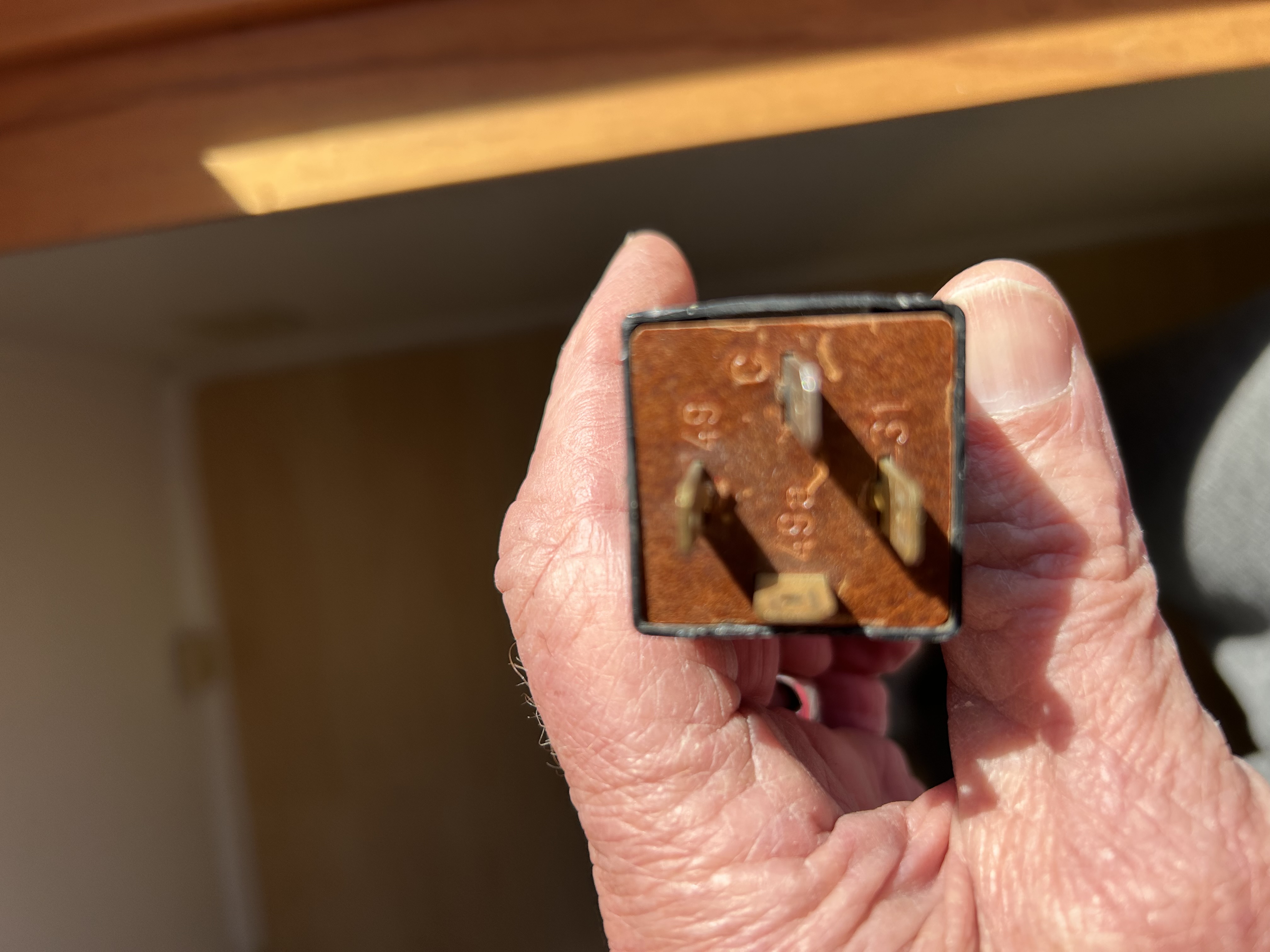

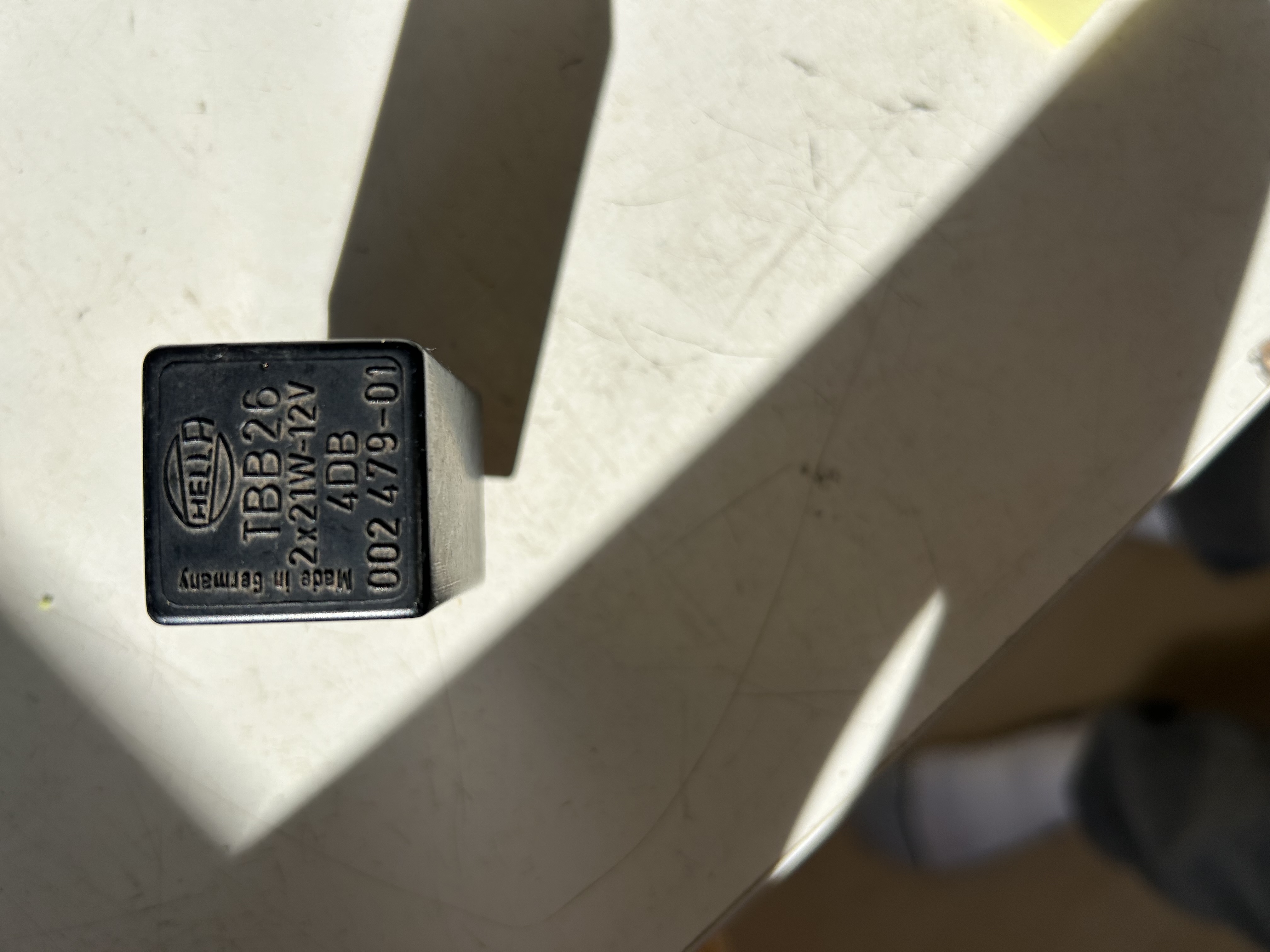

I have a couple of Hella TBD 26 flasher relays that I would like to test out on the bench.
The pin outs are:
31
49a
49
C

Is there a diagram on one side?
jim_hoyland
post Jan 15 2025, 07:46 AM
Get that VIN ?
Posts: 10,138
Joined: 1-May 03
From: Sunset Beach, CA
Member No.: 643
No diagram
