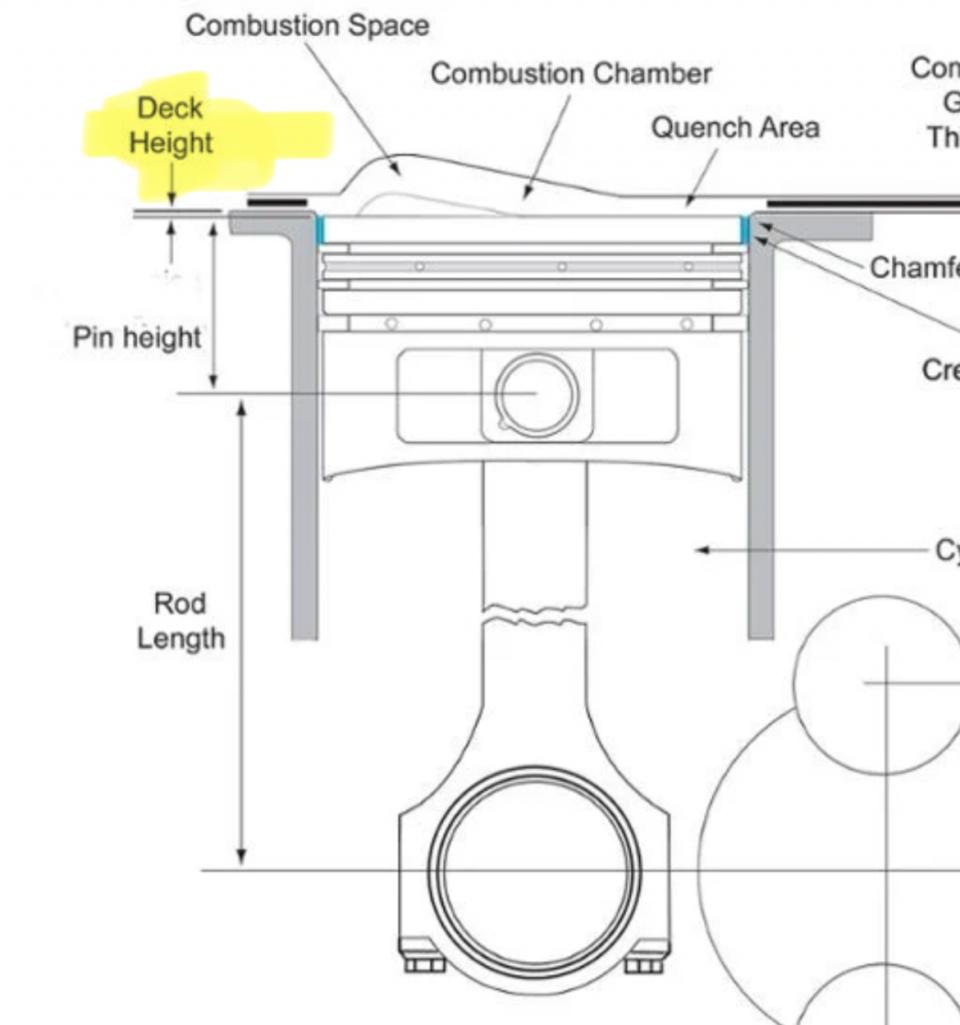

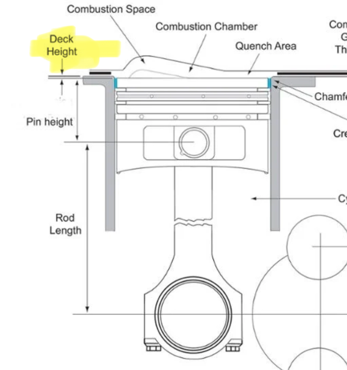

You need AT LEAST .036 with cast and .040+ with forged pistons.
This is piston top to cylinder top (deck height).
I am assuming you are not using fire rings (shims on the head side of things).
Any less and you risk piston to head contact.
This is fatal!
The compression difference will be tiny.
Now, for proper quench action you want "as tight as possible without P-H contact".
The deck height MUST be measured in line with the pin.
The more piston to wall clearance you have the more deck clearance you need.
Run tight cast clearances and you can go tighter than .040.
Run loose forged clearance and you will need more.
Larger bores need more as well.
For performance engines I want to be ALWAYS less than .045...

Sounds like you are playing with fire.
Without seeing how you are measuring or the heads I wouldn’t start an engine with .6mm of deck height.

By definition, deck height has nothing to do with the head.

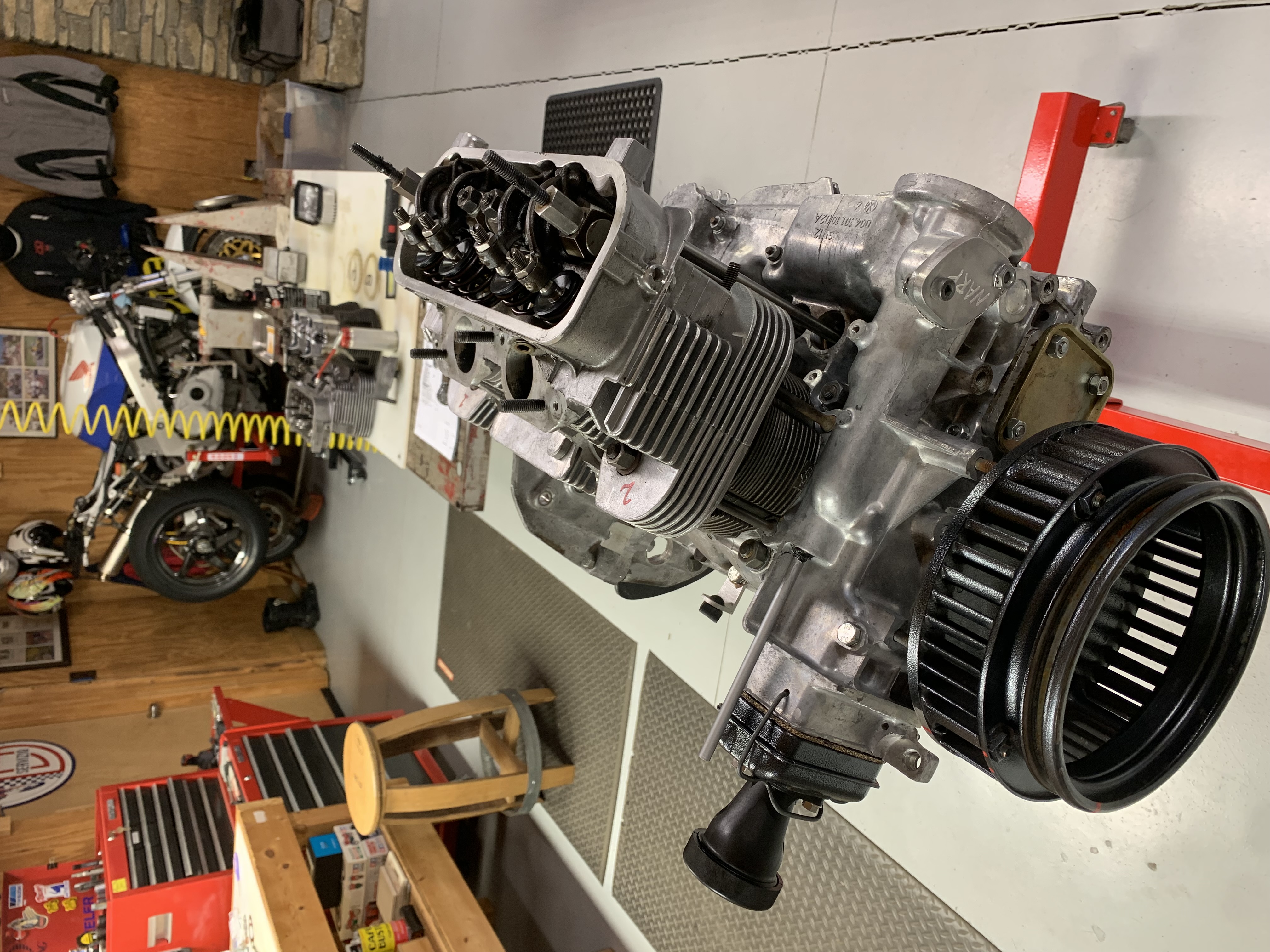

Measured valve lift a bunch of times today. Worst case I am losing .036" of lift at the exhaust valves, and .018" of lift at the intake valves. Best case I am achieving slightly greater than advertised lift on this cam (.435). So I am good with it and am not going to bother measuring for new pushrods. The geometry at half lift looks really really good, things are lined up well.
Will proceed with final assembly.
I will have questions about oil pressure verification soon.
A pic, because pics help everything (and 914 world autorotates my pics for some reason)...
