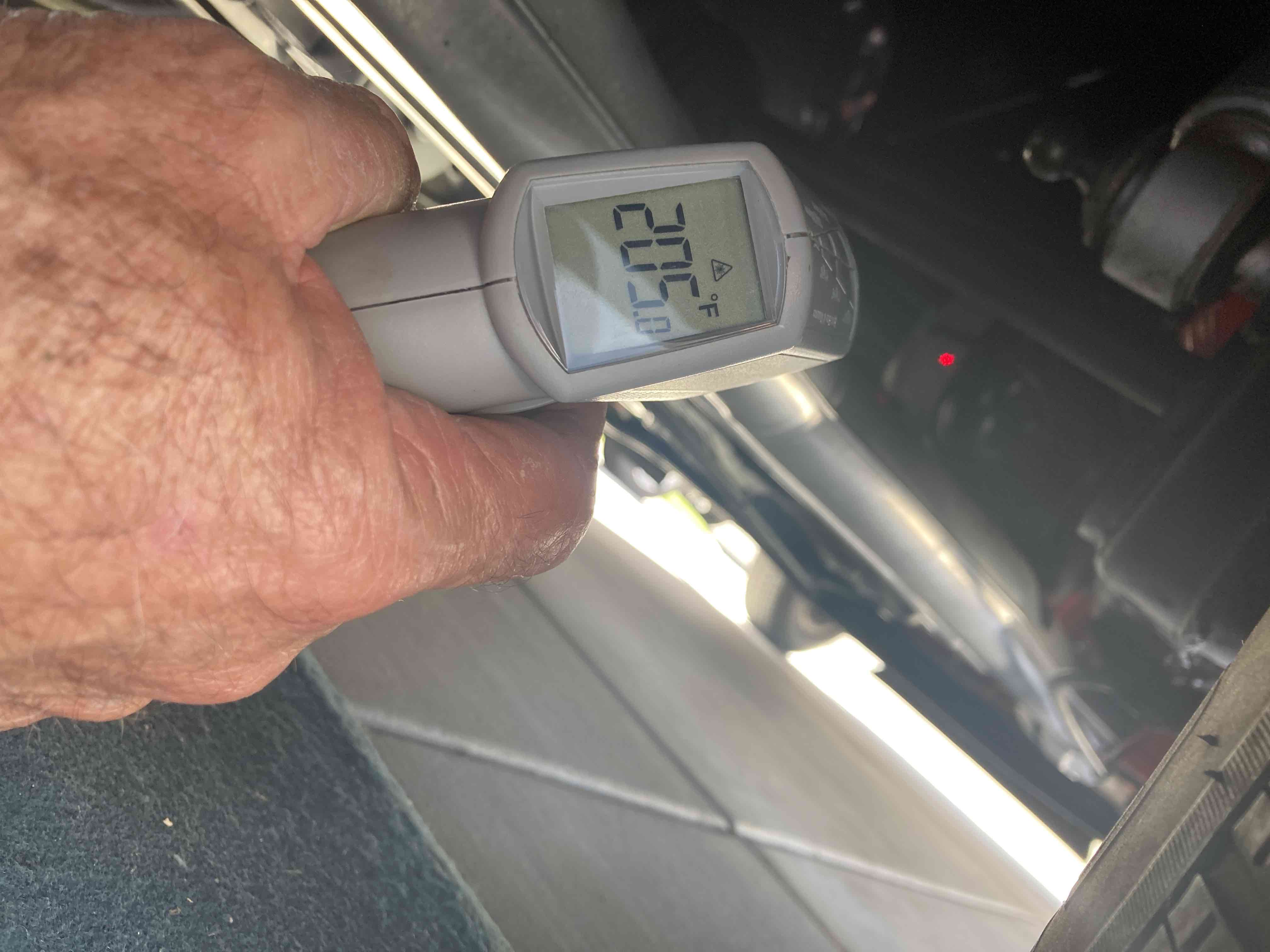

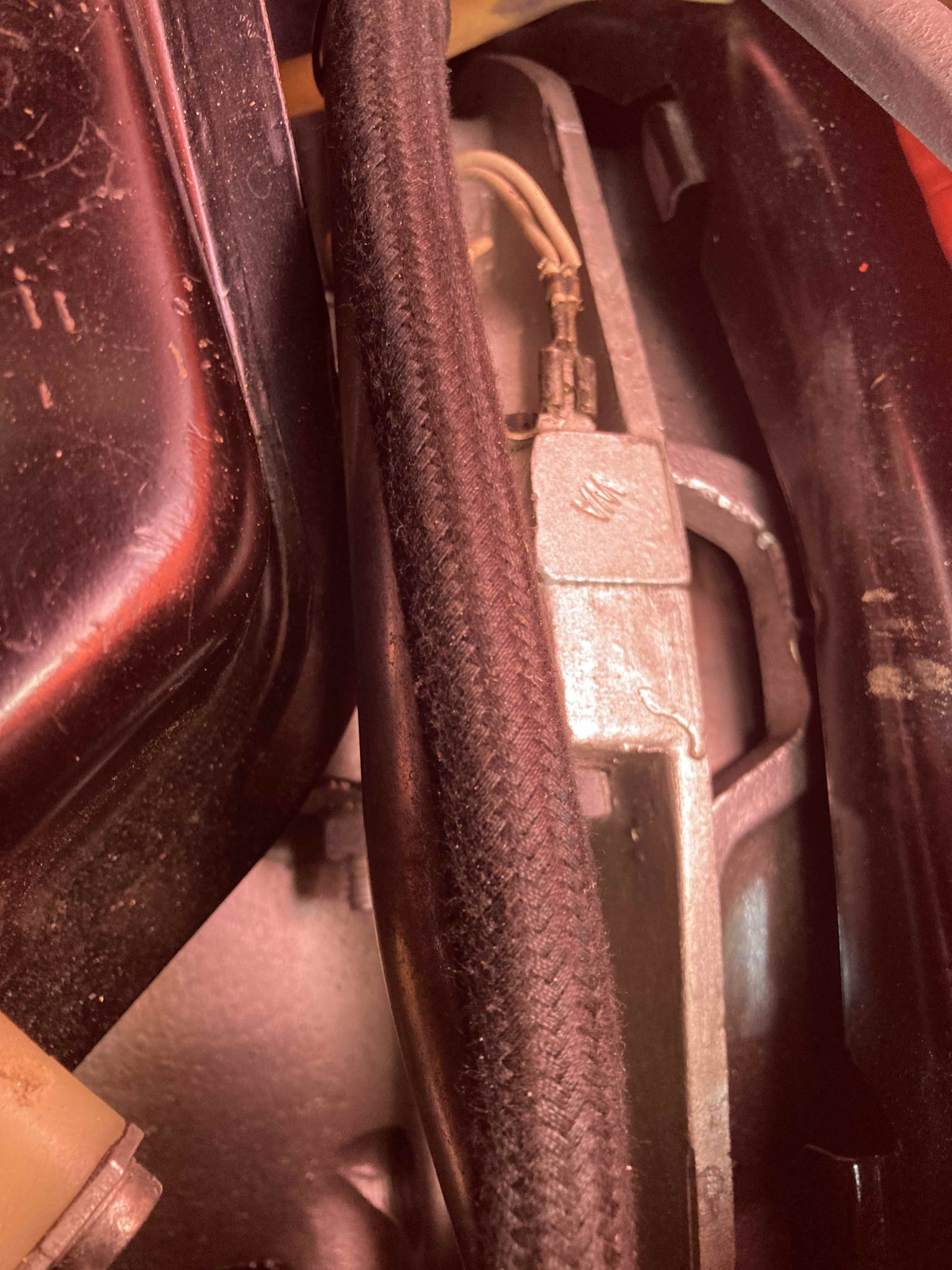

Good morning Emery @emerygt350 ,
I finally had a chance to get time to work on my car yesterday .
As before when attempted to start it ,it just cranked over but did not want to start until
I slightly turned the dizzy CW to retard a bit then a quick 2 cranks and it fired up .
As always I never seem to get the same results . I let it warm up .
then I plugged the 10mm that went to the decel & the 5mm then plugged the 10mm that goes to the MPS
connected a 10mm to the MPS and connected my vacuum device ,added 22mmHG to it
when I started the car
Now the car seemed to be idling a where I would expect it to but the motor seemed to hunt a bit 950-1100rpmand if I revered it up say 1800 it seemed to take a second or two to come back down.
I checked with my infrared thermometer to see if gauge was reading correctly
something came up so I had to stop my testing and have not got back to the car so maybe I can get to it today .
I did not remove this from my in line connection for the CHT to the ECU
once when I turned off the car it made a shutter type noise rater than just turn off .
Car still hunts a bit 1-250rpm
My neighbor thought it smelled funny but I just think it was an exhaust smell not hot .
Maybe I can try and figutre out how to post a video but I would have to get a YouTube account I believe.
I did notice the vacuum 22mmHG added to my MPS bleed off
I had tested previously the MPS by pulling app 10-11mmHG

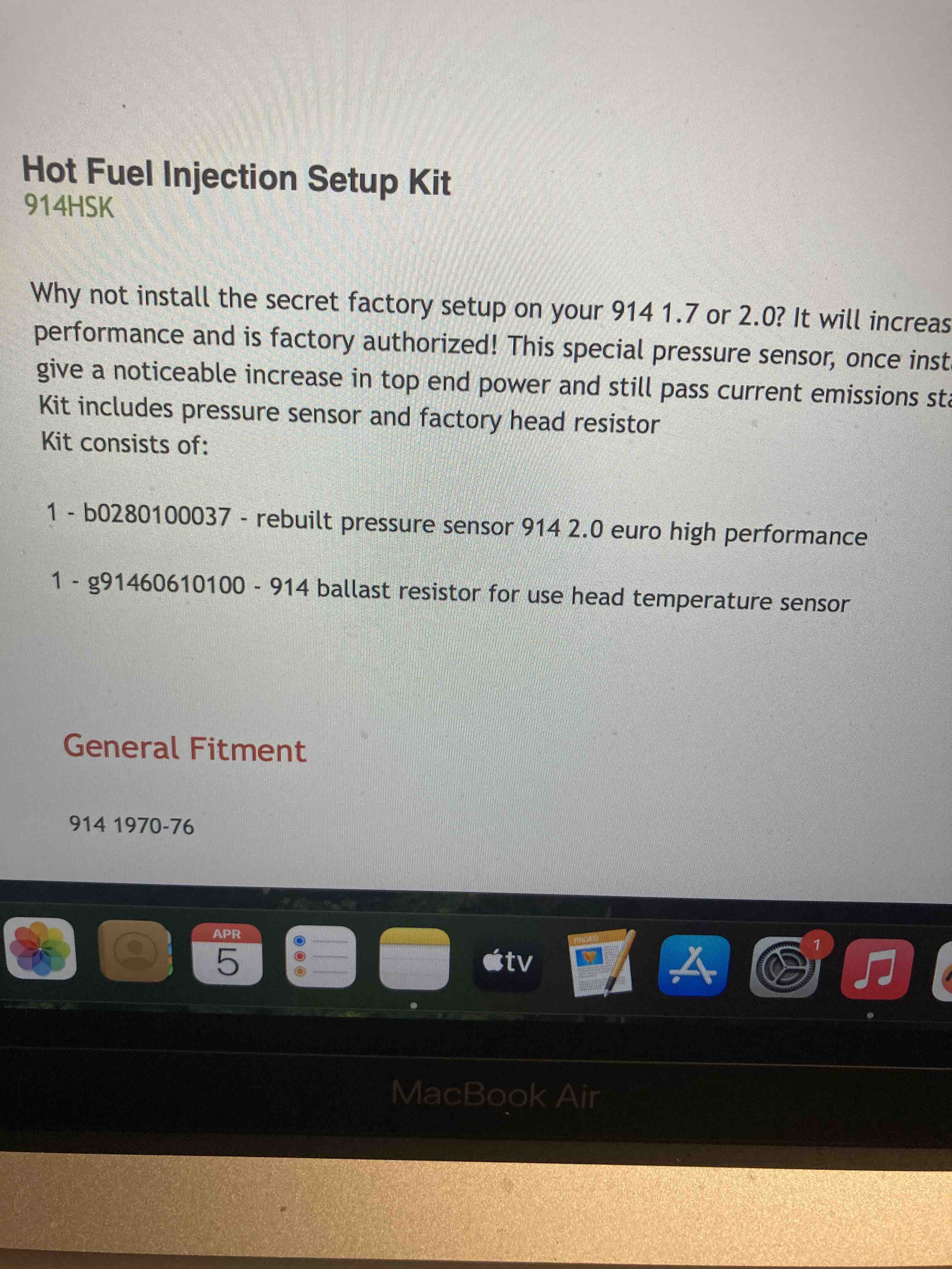

Thanks Emery,
all good suggestions . My day is growing short as we have a dinner party to go to @5:00 so I might not be able to do all this today .Lots of great suggestions . That would great if I didn't have to worry about adjusting the valves today . I am going to have to look up and do some studying it's been almost 50 years since I last did this on my VW's and I read somewhere that I will need to remove my HE's for access this might take a while and I still need to have a TDC mark I can trust . I do have this to help There is a mark on my flywheel and I can see it . Maybe tomorrow when girlfriend is here I can get her to look for the mark when it is aligned where the cases meet and hold my accelerator to 3500 for me . I believe Blue Lighting used this mark in one of his posts . I will jack the car up and put in 5th and turn the rear wheel while she looks for it . Not sure how once aligned I could use that to add a paint pen mark to my cooling fan as I cannot see any marks in the V cutout on my fan.
I only ordered that hot set up resistor because the box of stuff that came with the car had a homemade thingy that looked like an inline resistor ( it feel apart on me ) I had no idea what it was for so I searched and found this on AA site.However the motor was the stock 2.0L although Im not sure why it was in box with the other parts of the motor or if was even connected inline with the CHT. I have the ECU adjustment knob set at 9:00 position as I read somewhere
I am pretty sure I warmed up the car with everything connected then I removed the 10mm & 5mm hoses that went to the decel and plugged them, I removed the 10mm that went to my MPS and clamped it close and added another hose to my MPS and added 20inHG to it and then started the car again.
