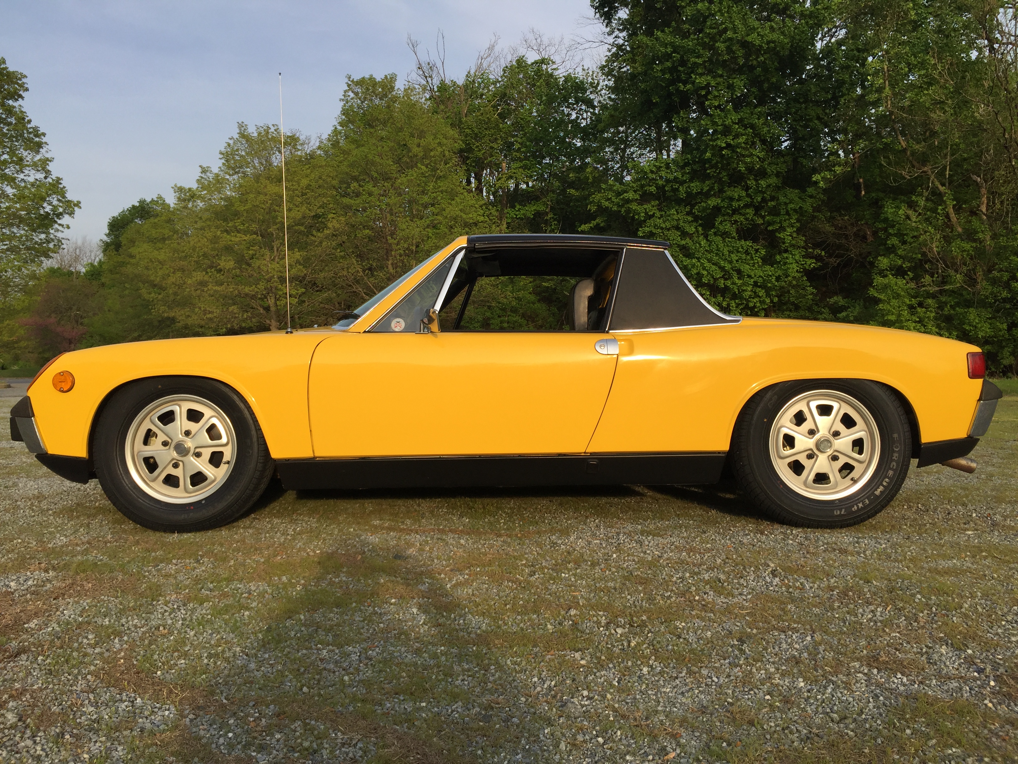

205/70 installed no rubbing issues (8.2-inch section width, 26.3-inch overall diameter). 5th gear 3000 RPM is 71 MPH per GPS, 69 MPH speedometer. Attached Image

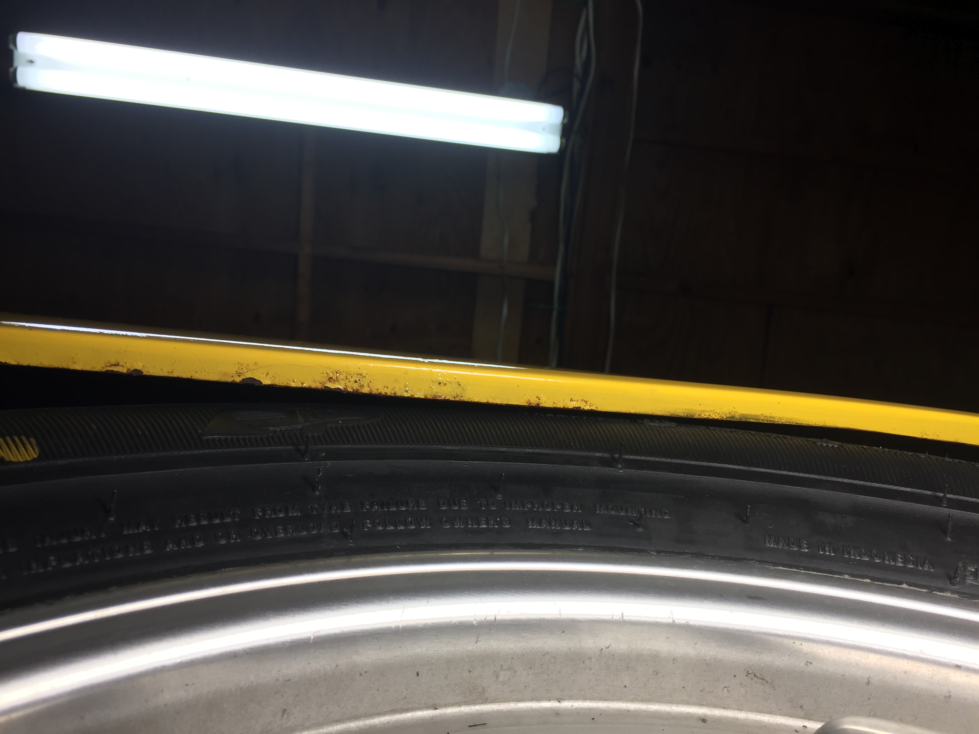

Left rear is close, but no rub, plenty of room on right rear. Attached Image

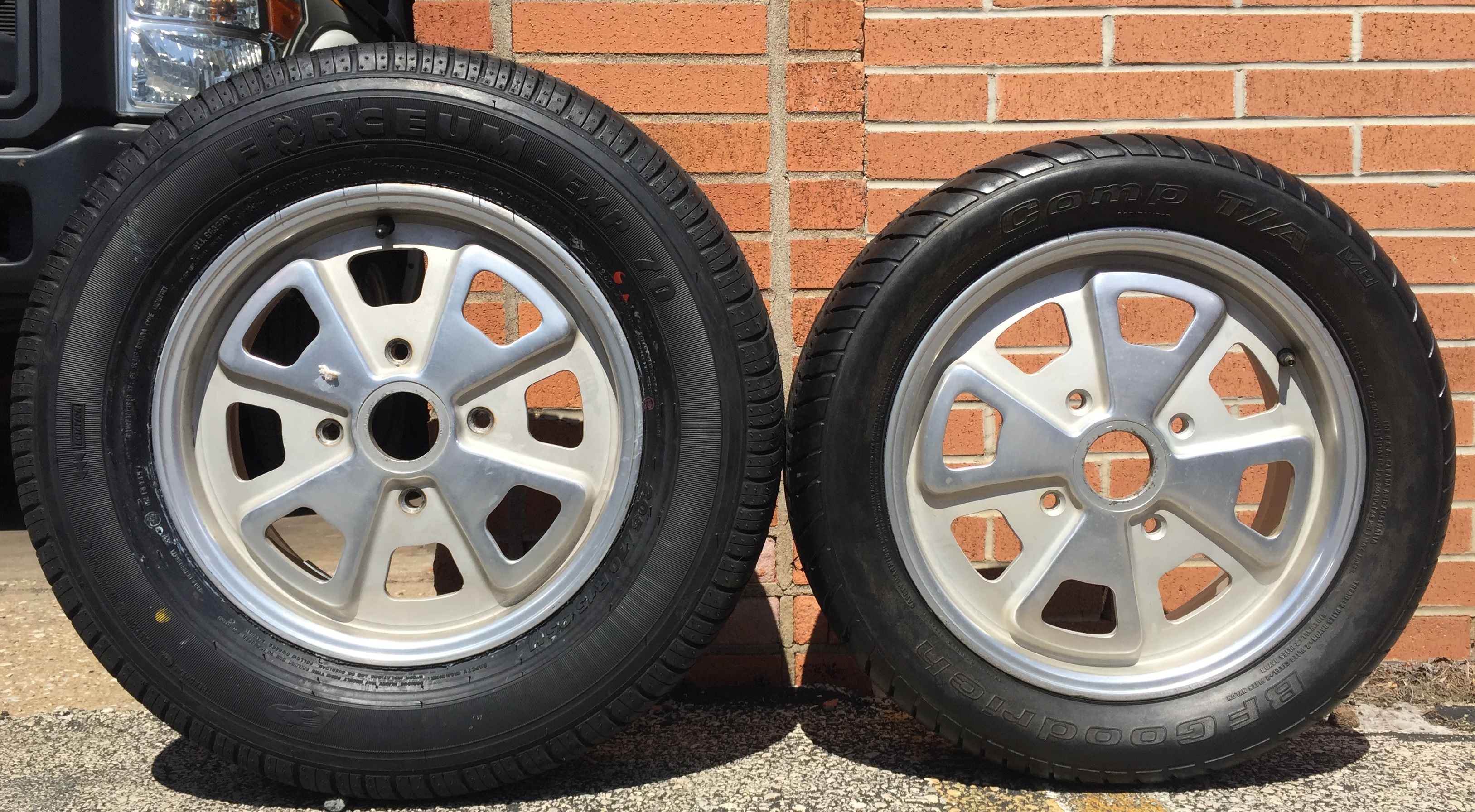

Attached Image 205/70 vs 205/50
