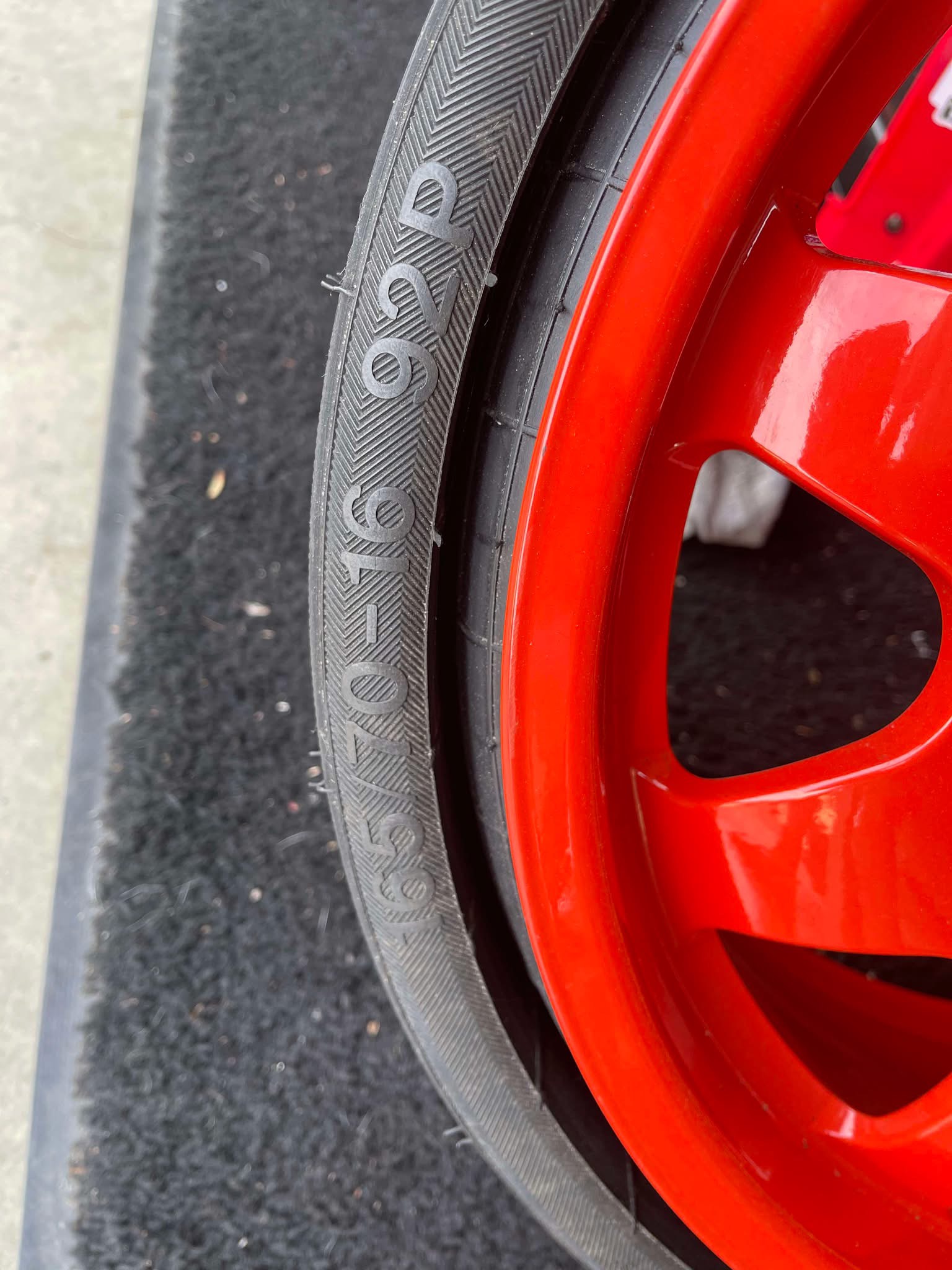

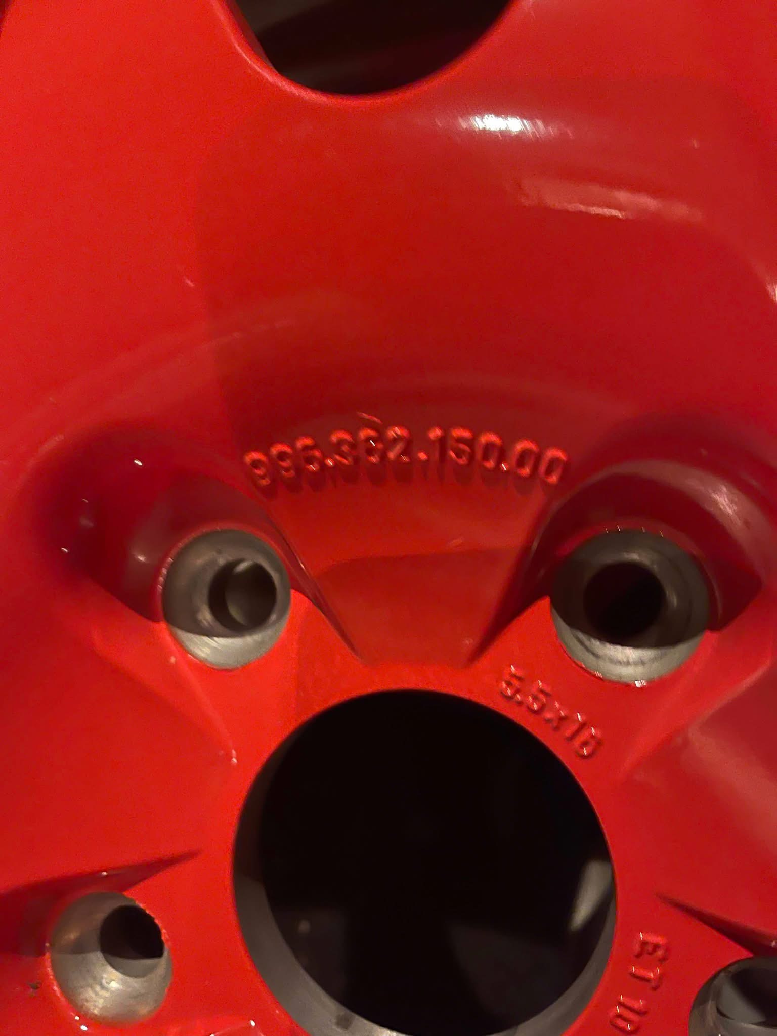

Hello, needing a compact spare for my 914 six with flares. Currently, I’m running 15 inch wheels but I think in a pinch this could work. I think my rears are 225/ 60 17. Front 195 65 15 Pirelli cn36.
See pictures for rim and Tire six. To get me out of the boonies and back to civilization do you think this wheel would work?
Very reasonably priced under 100 bucks and basically new.

Looks like an ET 10 for this wheel.
I’m running 7x 15 upfront with a 21 mm spacer and 8x 15 in the rear with no spacer. Have Boxster brakes

Thanks ya'll for the the feeback. Going Cairo style with the wheel storage- frunk mounted on the wall at the gas tank vertically. Will this fit mine Cairo?
With the tire flat, is the diameter of the compact spare much smaller than a common 15" wheel/ tire combo? I'd guess so otherwise whats the point....
I'm replacing my funky front oil cooler shroud with a proper Getty 914-6 shroud with the goal of having the space for the compact spare up front.
Wheel...no problems with the backspacing for both front and back I hope...
I'll go for it...the price is right.

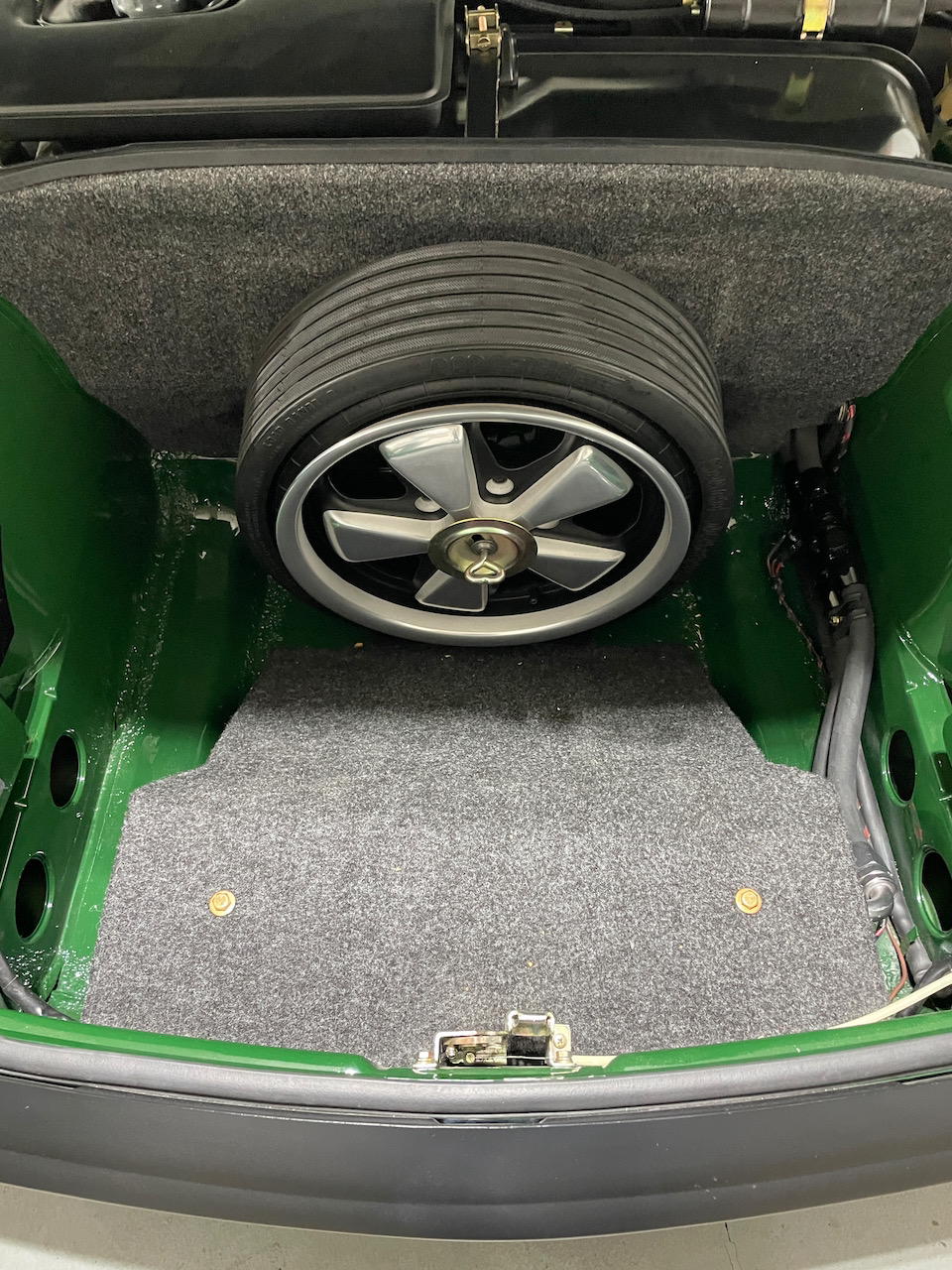

My factory 6 with front oil cooling and a 16in x 6in factory Fuchs and spacesaver. You can see how much space that there is above the tire to the top of the wall in front of the gas tank. This should give you a good idea of the fit.
Best Bob B
By the way I have had this polished 6x16 real Fuchs for sale in 914world for some time. $350 del. to you
