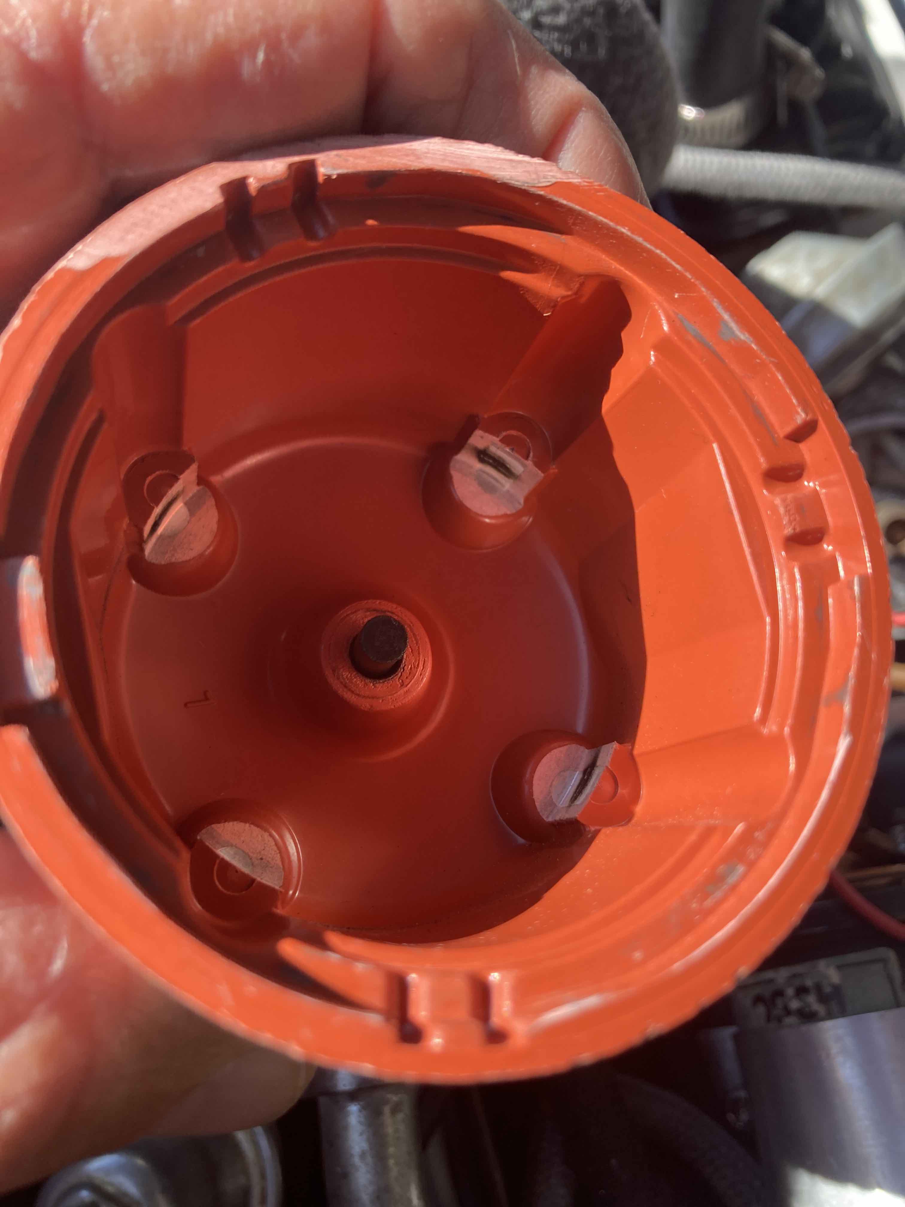

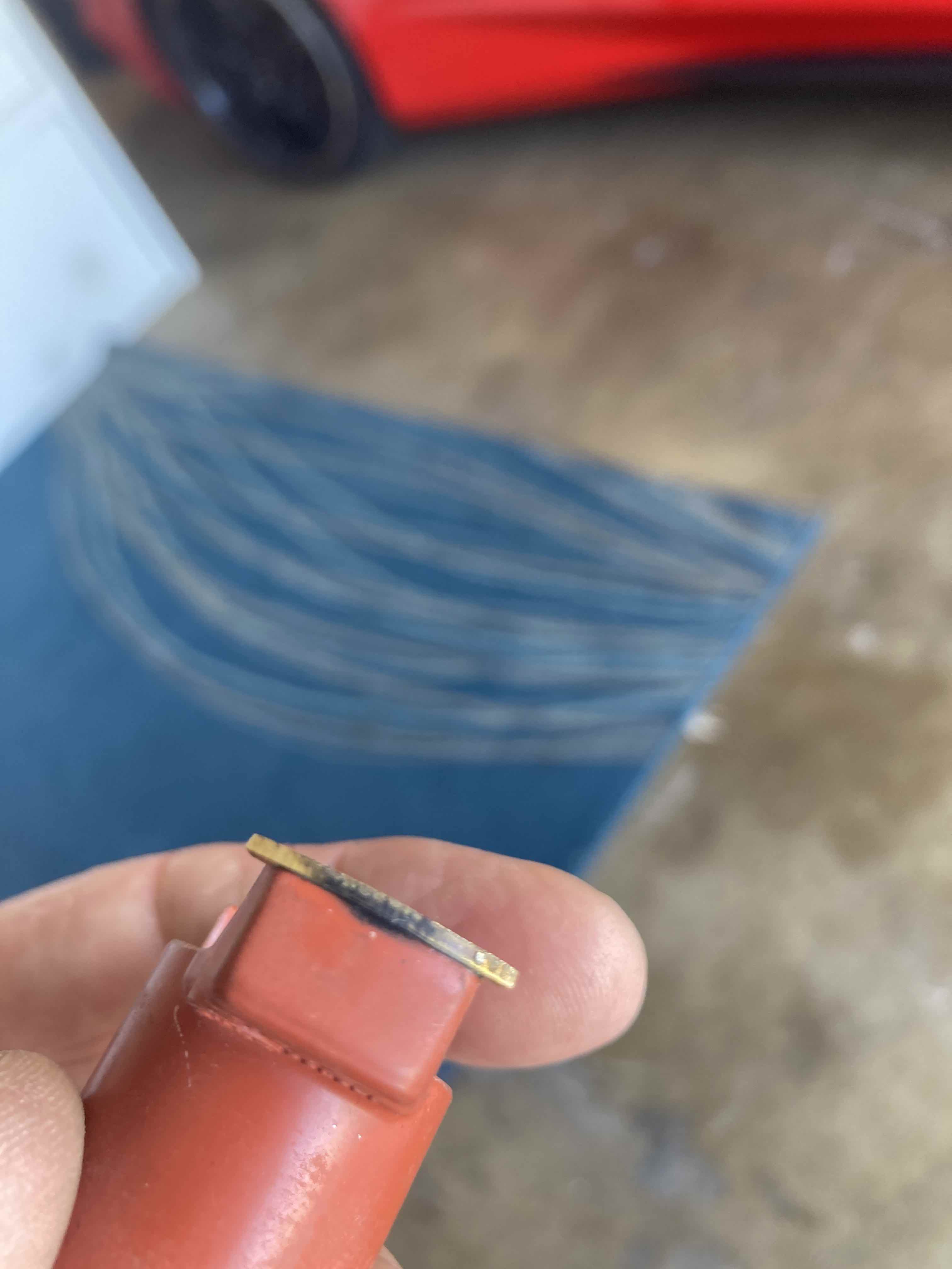

1) Spark - I checked all plug wire connections and then (not sure if this was correct) used the timing light on each plug 1-4 and checked for a pulse ( Had a pulse on all four).
Pulled cap/rotor ( it was not disturbed ) and checked ,that's when I noticed the black arcing marks on the four plug connections and on the rotor I cleaned the contact points and reinstalled the cap/rotor but I still had rough/shaky idling.
Here's where I squirreled and decided to change the Pertronix unit for points/condenser (new point and condenser set gap to .016), this made no difference.
Now for a bigger problem I think I have created for myself to correct , this is when I did my worst squirreling around.
When I tried to start car after reinstalling the distributor I did not have the distributor seated all the way as I had thought by rotating it so that it seemed properly seated . I know this because I again pulled the cap and discovered the rotor would turn telling me it was not seated properly before I turned the motor over , this is why I assume I need to get establish TDC position and reinstall the distributor . I need some guidance here before I proceed .
Since I have to pull the distributor I would like to install the pertonix back before I proceed any further .

QUOTE(emerygt350 @ May 12 2025, 06:50 PM) *
Don't worry about TDC, the distributor only goes in one way, it has an offset on the shaft. You can put it in wrong and clamp it down so hard it will spin but don't do that.
I would go back to the pertronix for the moment.
Did you double check your trigger points connections?
If you can get it back to where it was when you tried running it, that would be great.
Hi ,
yes I rang out the wires from the trigger points plug to the ECU plug and I have continuity on all three ( I must not have had the probe inserted correctly (I added resistance values for the individual wires for both the MPS and the trigger points .
Also checked the resistance of the CHT wire without that added resistor in circuit and it was
000.2 ohms.
I will reinstall the Pertronix back and follow up here on this post .
What about the bad bushings in my distributor you mentioned ? Can I purchase parts and replace them or do I need to look for a new distributor . If only I didn't live in California I would buy a 123 .
