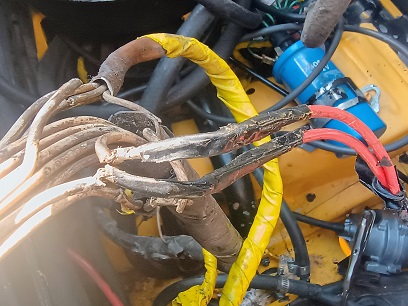

For folks don't know where the Three Groung Thingie.
Root_Werks
post May 28 2025, 12:56 PM
Village Idiot
Posts: 8,693
Joined: 25-May 04
From: About 5NM from Canada
Member No.: 2,105
Zoinks, the wiring in the picture looks sketchy at best.
Check your grounds, they seem to cause all sorts of issues.

QUOTE(Root_Werks @ May 28 2025, 12:56 PM) *
Ya think!?
Very Sketchy indeed.
I did recommend new harness.
Steve a Newbie but ready to learn 914 FI (IMG:style_emoticons/default/lol-2.gif)
emerygt350
post Jun 3 2025, 03:32 PM
Posts: 2,917
Joined: 20-July 21
From: Upstate, NY
Member No.: 25,740
You need to start putting these pictures under my early Halloween thread. I don't think I can unsee that last one with the dangling mps and vice grip. Oh my eyes!
