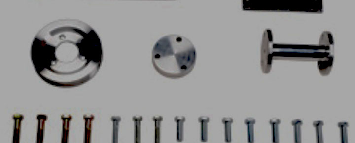

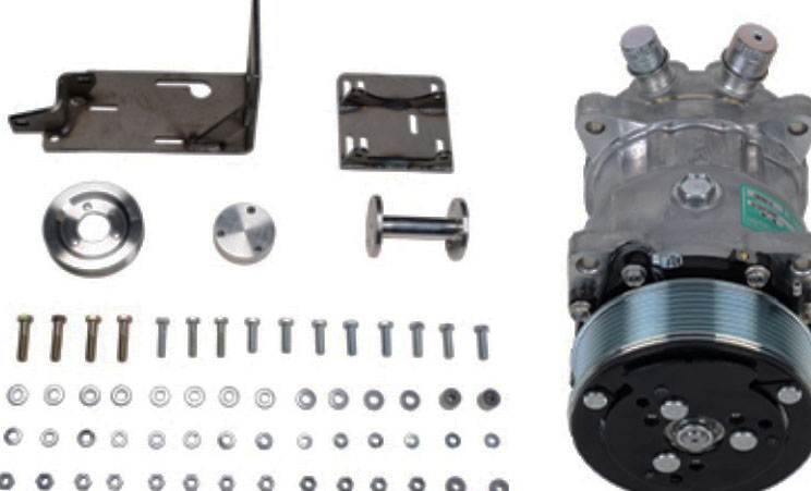

Classic Auto Air has a 912E kit. Note the pieces that they use to fit the pully to the front of the fan. No sacrificial rubber piece. A smart guy could have these pieces fabricated and make something work.

Yeah the factory parts are all wasted to speak of, but these parts are just metal, there is no sacrificial rubber on it. Just have to worry about what would happen if you're compressor froze
