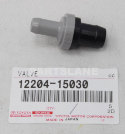

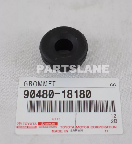

Well, we tried to find a Fram 279 equivalent. This is what’s coming…
Definitely a Toyota part according to the images. No idea if it will fit, the car is not here.
And yes, the PCV valve is at least part of the problem as far as we can tell.

I know I had a conversation with one of the old hats on this but but I am sure it is buried among those threads. This is not an equivalent. The original had specific levels of flow base on vacuum etc and you can only hope the spring in this matches those. A Toyota is going to have a much softer job pulling vapors than an air cooled 50 year old engine design. So buyer beware. I really don't think it will matter, but just a heads up.
Again, you say it is the problem but the pcv is a intentional leak on these motors. Before I dumped 30 dollars to get a pcv I would just plug it and see where I am at. If your engine is not doing something it shouldn't be it should drop to around 750ish without the controlled leak of the pcv. If it isn't doing that then this is a waste of money.
What is your high idle?
