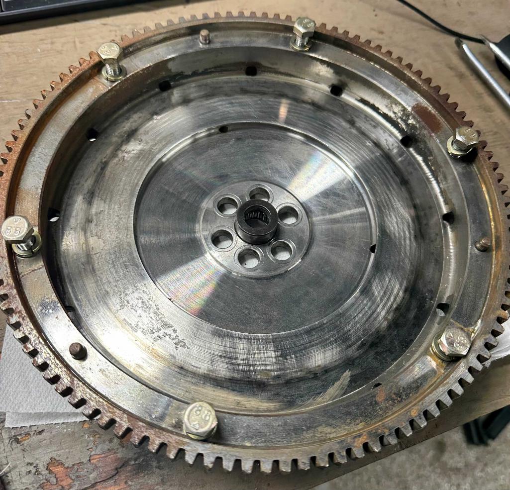

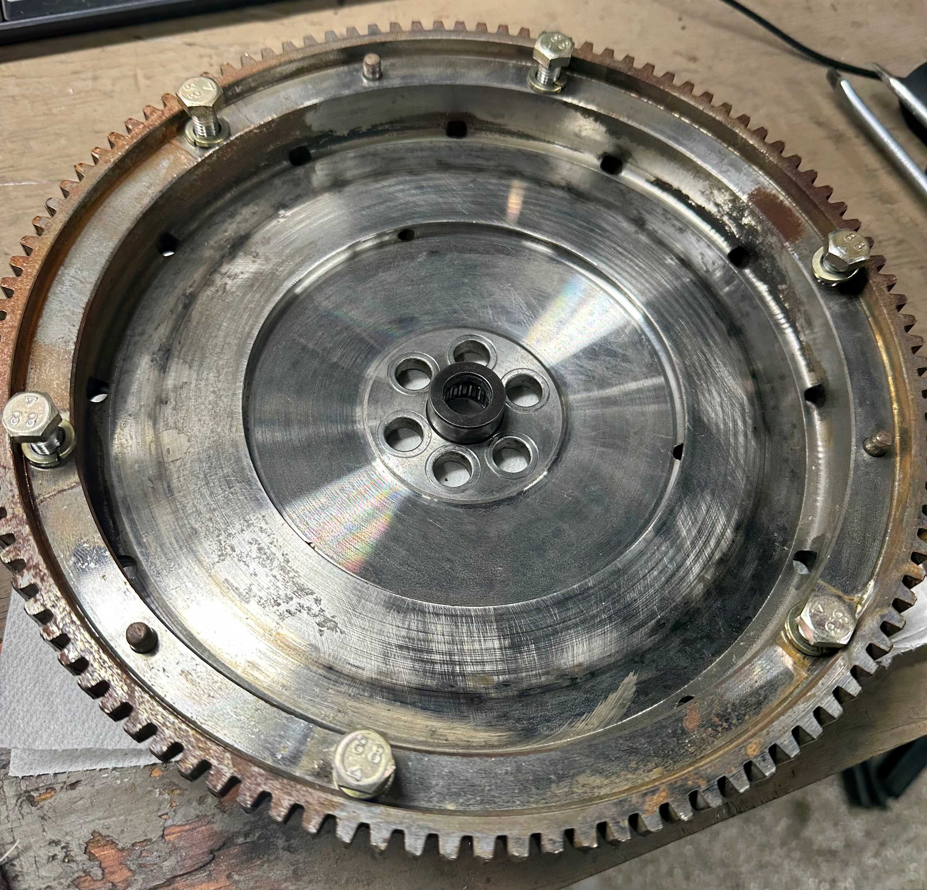

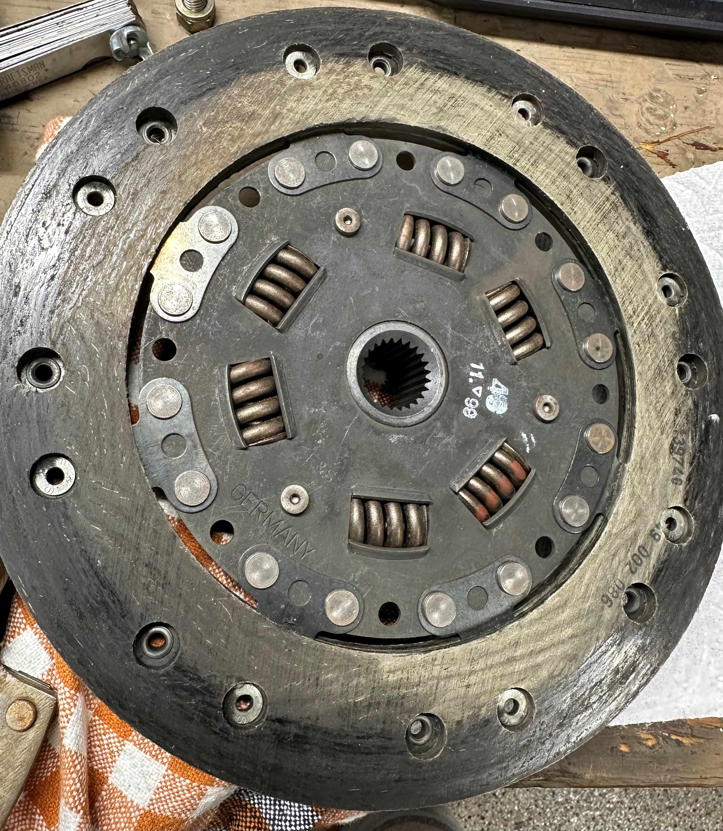

Clutch disc only shows wear on the outside half on the flywheel side. Is this normal? Normal for a new clutch disc?
Clutch disc measures at 9.7mm so thinking it is pretty new based on new ones being around 10mm. Flywheel surface looks good and appears to be flat using a small straight edge.

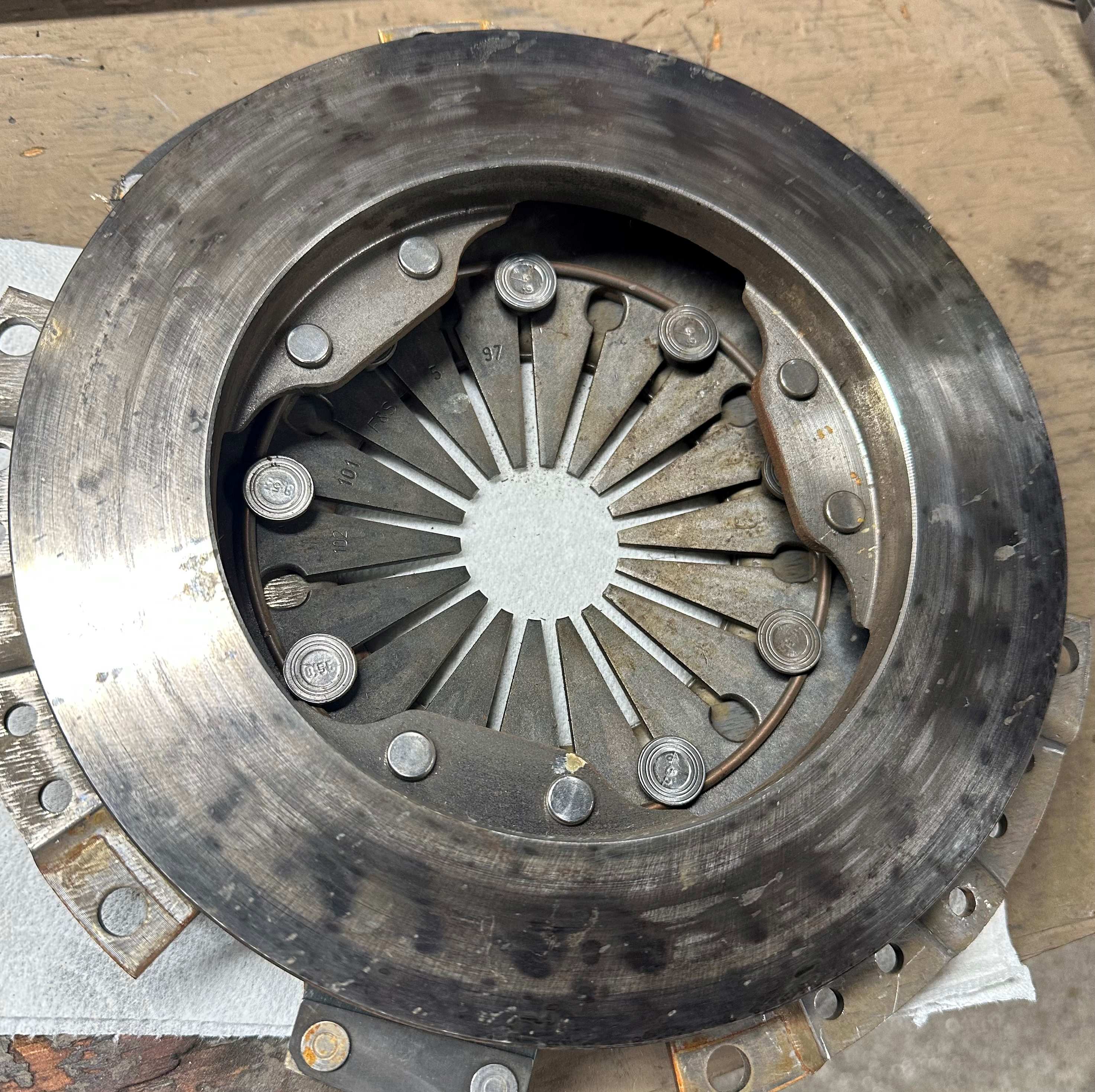

You can most likely reuse that clutch disk but not with that flywheel without getting it ground and resurfaced, post some pics of the flywheel and pressure plate would be handy to help you further, cheers.

post Aug 18 2025, 09:25 PM
Posts: 14
Joined: 14-July 03
From: Danville, CA
Member No.: 909
[/quote]
[/quote]
Certainly. Here is the pressure plate and the flywheel. Thx.
