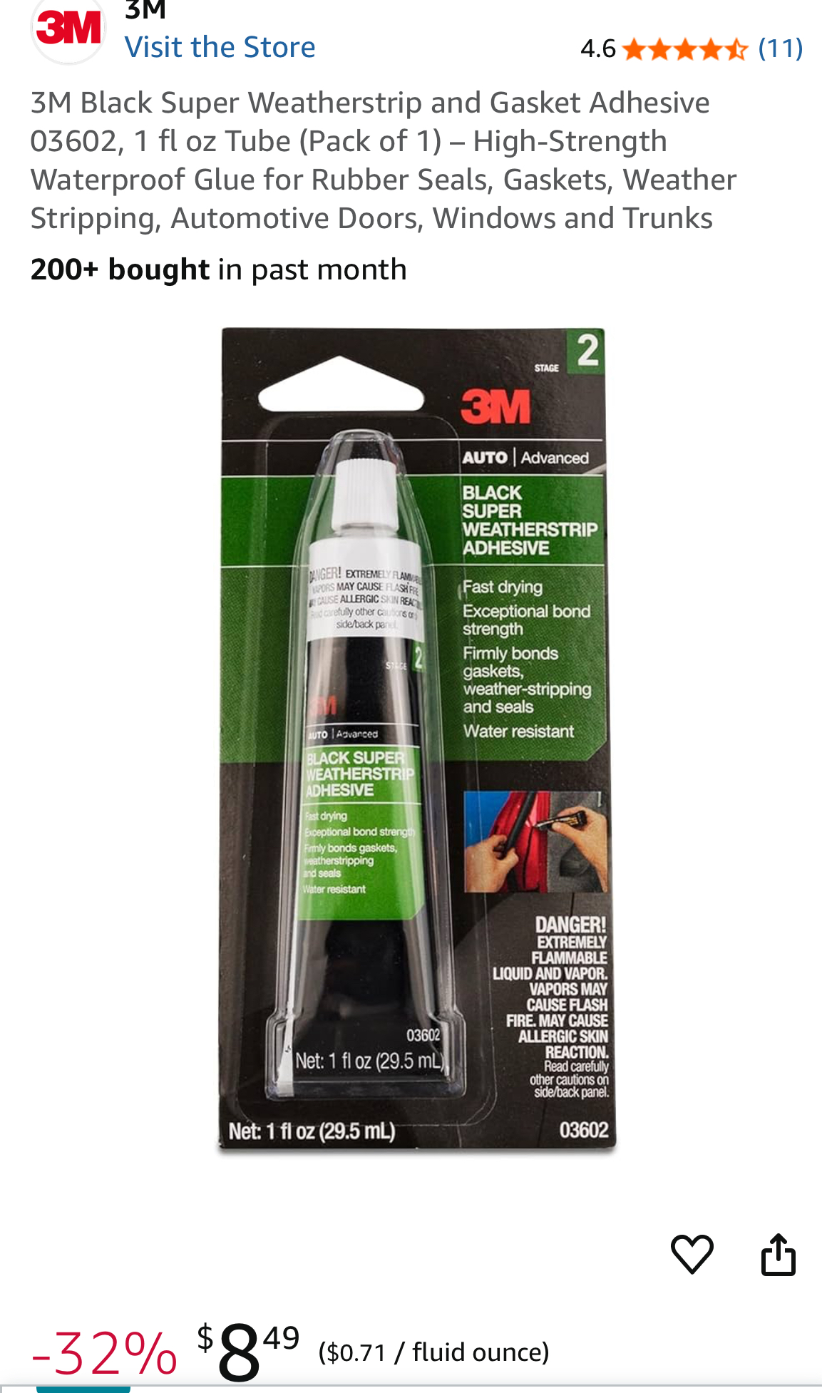

Between the track and the rubber I’d use 3M weather strip adhesive. It flows out of the tube pretty quick so be careful and wear rubber gloves. It sticks pretty good. You should be able to get it at most auto parts.

Thanks Ed: I had watched Ian's video a while back. Watched it again this morning and as I had remembered, the ONLY detail he skipped is about the bottom track rubber installation. The video led me to install mine without and sealer or adhesive, and it came out. Fortunately nothing broke. I may start with 3M between the rubber and the track and see if that's enough to keep it together. I have a tube of it on hand and that's a bonus.
