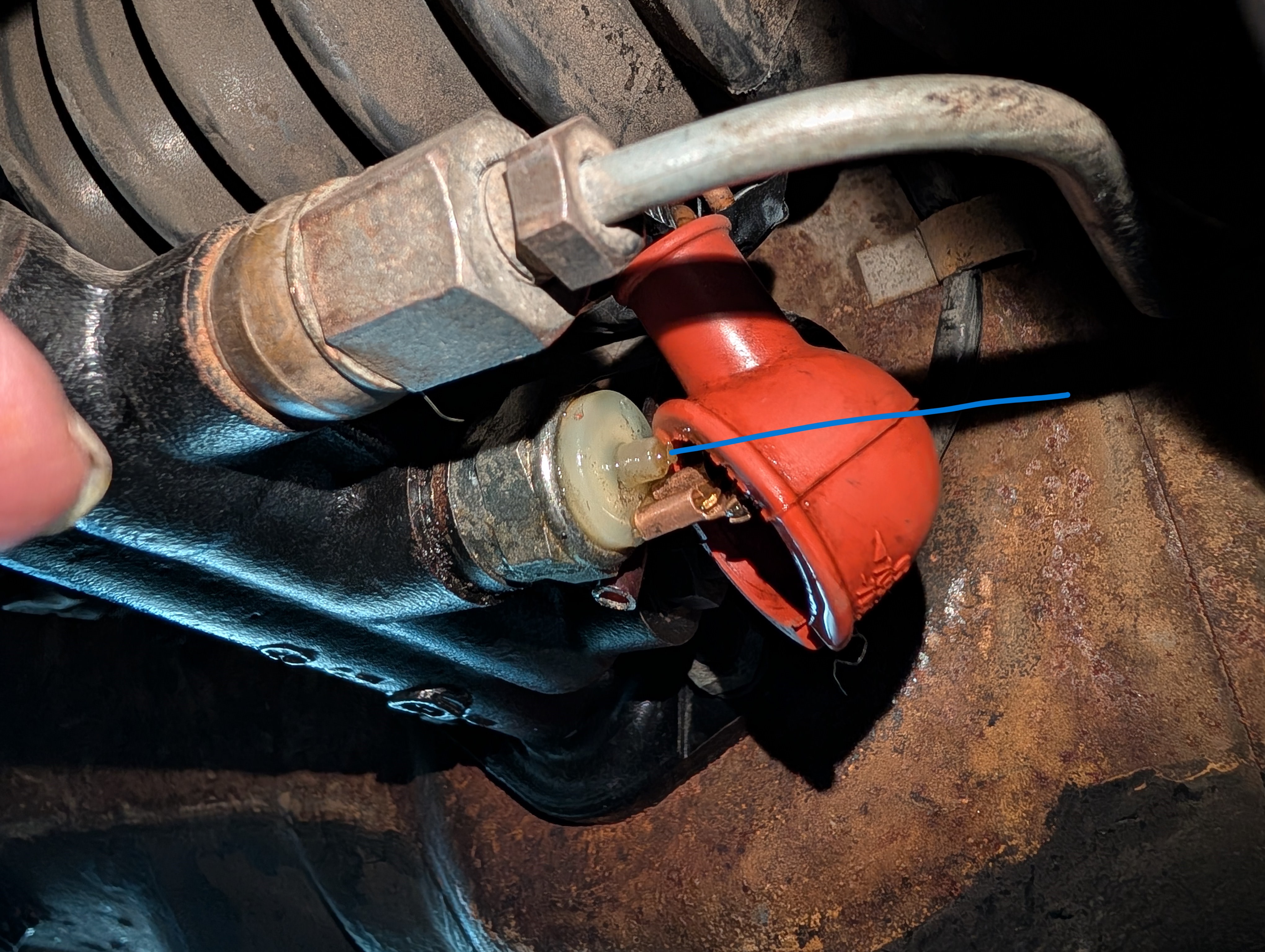

I've attached pic, it's leaking where the blue line is. Felt the top of MC and it is dry as a bone.

I would add, that if you're investigating this area of the MC, and you suspect that there is a leak, you'd probably be better off replacing the MC

I suggest loosening the switch. If fluid drains out, the MC has failed. There should not be any fluid inside the switch cavity.

Thanks for the help and suggestions. I will loosen the switch in the morning and let you know.
