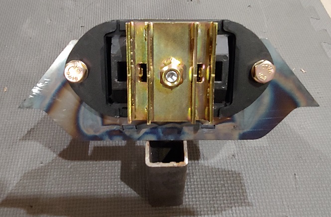

On the front engine mount, there is a shock mounting system, on the top of this there is a plate with a nut welded within, I am confused as to the orientation
I could not find a drawing within the panels at AutoAtlanta,
Can anyone provide a pointer? I need to understand the vertical and horizontal orientation,
Thank you,
CTC911CTC

There's a total of 3 pieces that mount to the firewall mount. The rubber mount, the upper nut plate and the lower plate. Make sure that you have the correct length and pitch bolt for the mount as well.
