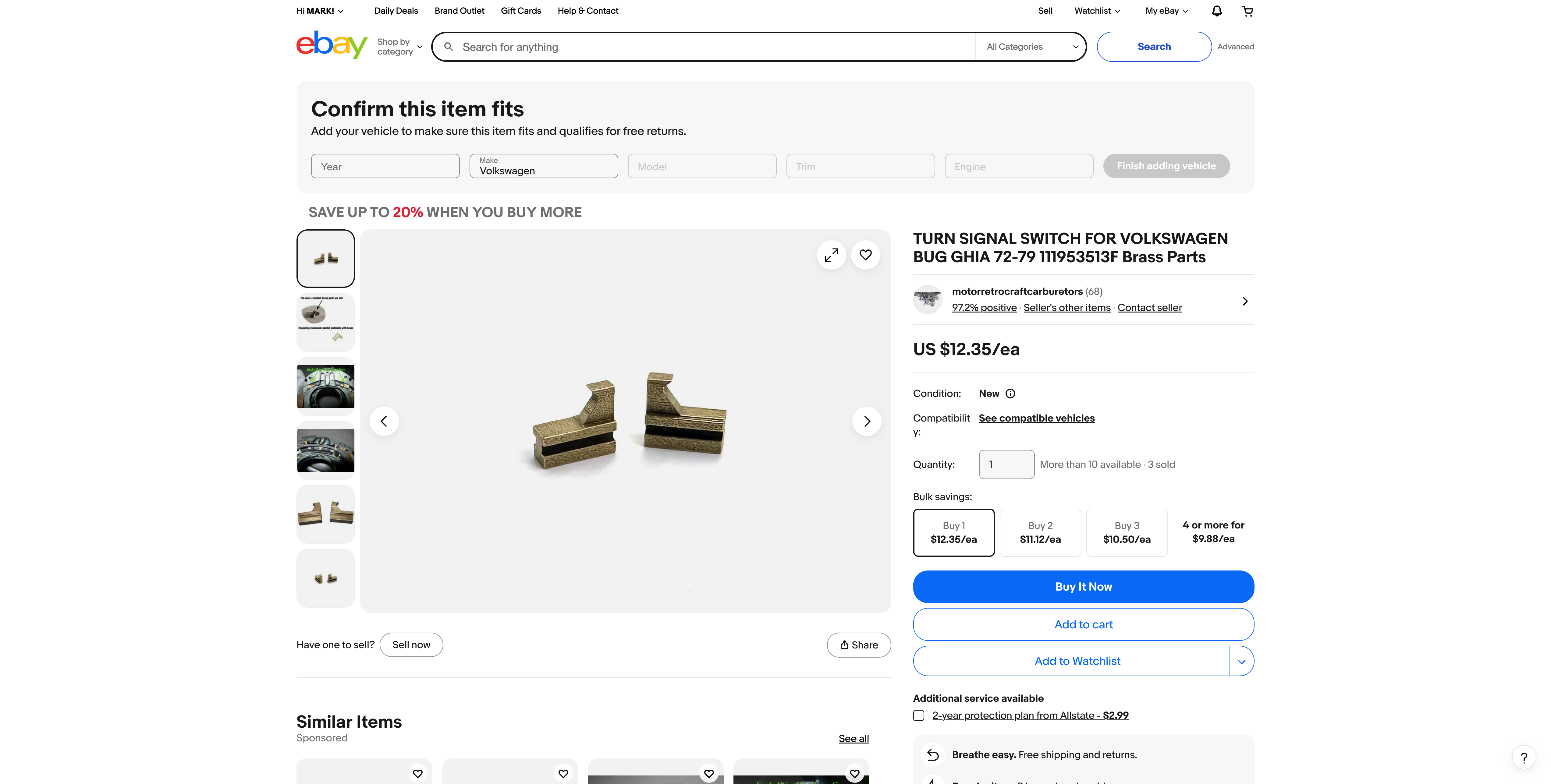

Make sure these pieces are in place in the switch. Plastic pins break and spring falls out.

QUOTE(914Sixer @ Oct 23 2025, 05:28 AM) *
I bought a pair of replacement pieces for broken plastic ones. They’re brass.

jim_hoyland
post Oct 23 2025, 01:35 PM
Get that VIN ?
Posts: 9,920
Joined: 1-May 03
From: Sunset Beach, CA
Member No.: 643
I have a pair of these but not sure how to get them mounted without breaking something else

eBay: See 914sixers post ….
914Sixer
post Oct 23 2025, 04:24 PM
Posts: 9,301
Joined: 17-January 05
From: San Angelo Texas
Member No.: 3,457
Here you go
jim_hoyland
post Oct 23 2025, 05:47 PM
Get that VIN ?
Posts: 9,920
Joined: 1-May 03
Member No.: 643
That’s it; my question is how do you get them in ????
