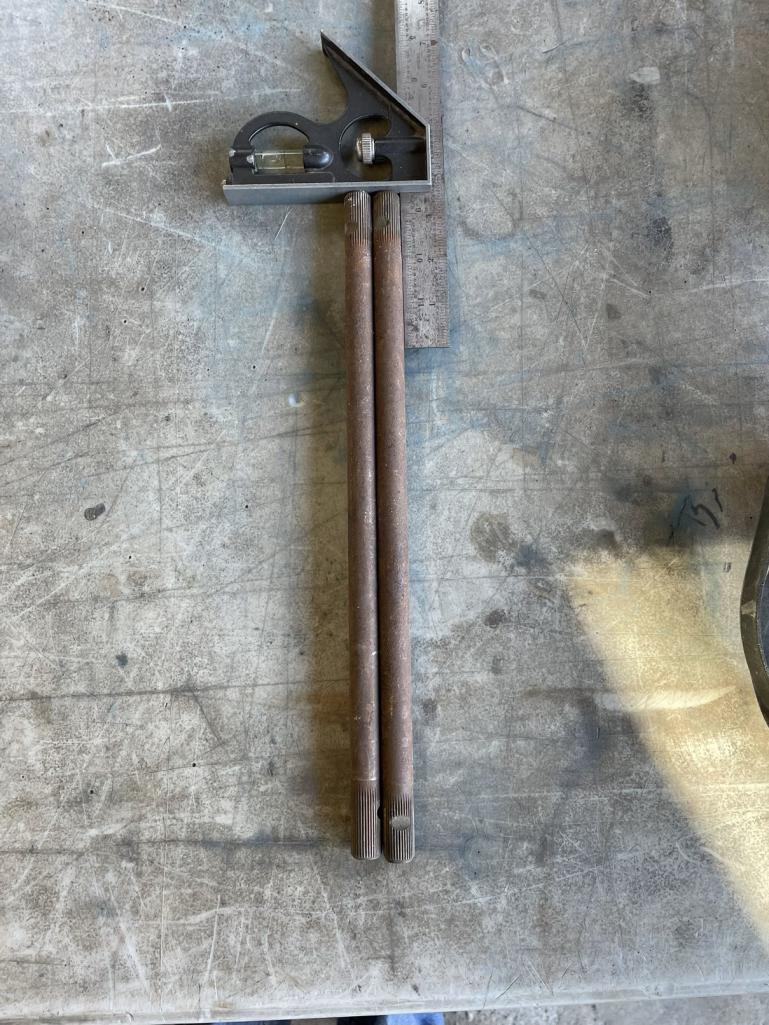

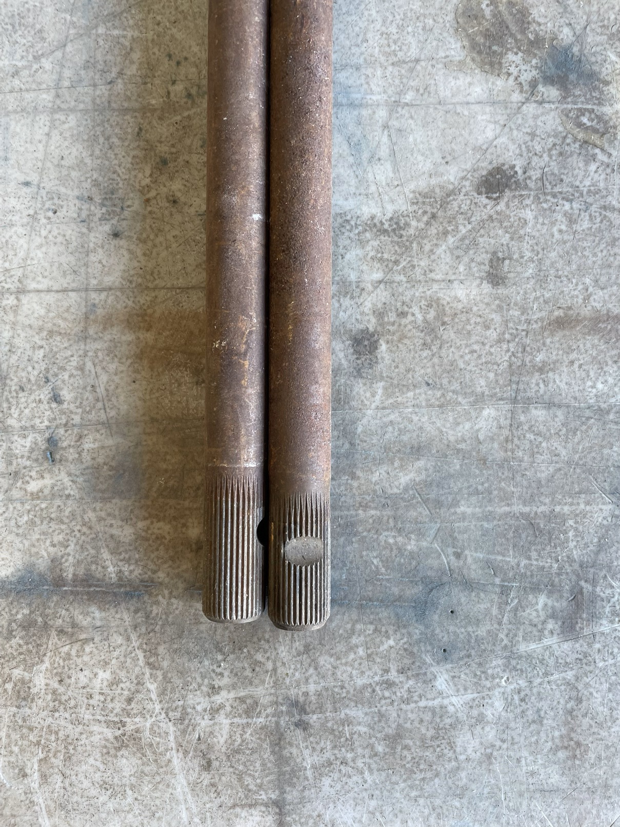

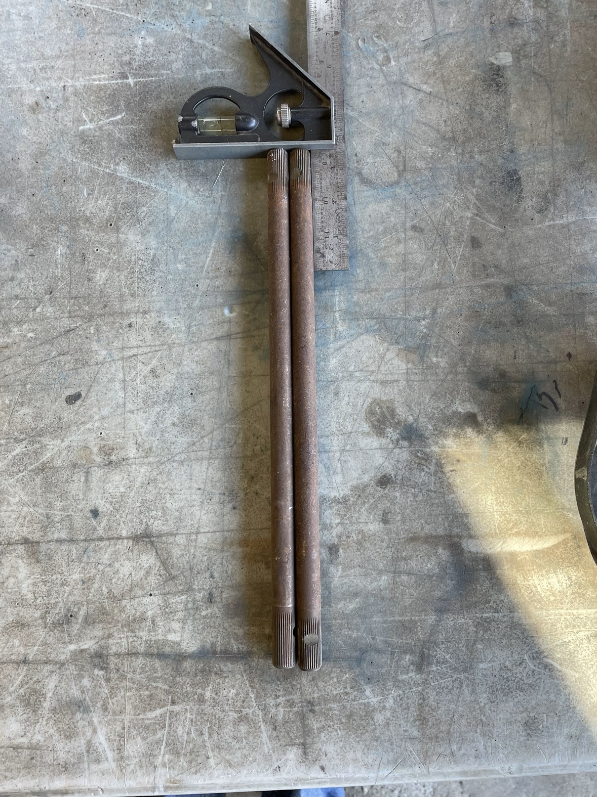

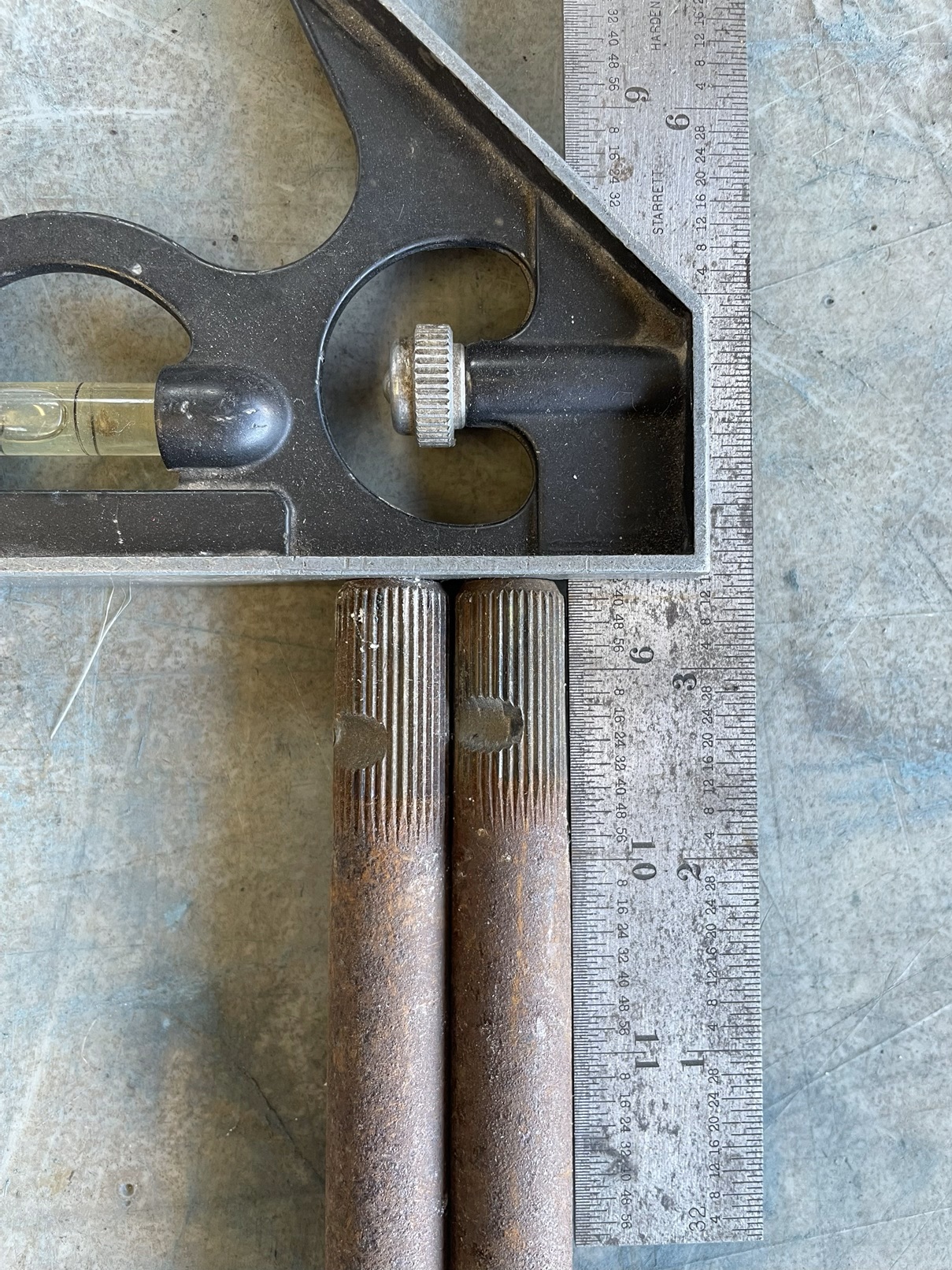

rgalla9146
post Nov 5 2025, 11:06 PM
Posts: 4,846
Joined: 23-November 05
From: Paramus NJ
Member No.: 5,176
Chris don't declare victory quite yet.
There are two versions of the splined shaft between the universals.
One is longer than the other and the recess for the cinch bolt is clocked differently.
I learned this when first driving my 911 column car.
It had a segment of high effort when turning the steering wheel
I'll get a better description of the one that works in my car.
Rory
PS I'm sure you can make either work with a bit of grinding.

tygaboy
post Nov 6 2025, 10:01 AM
Posts: 5,684
Joined: 6-October 15
From: Petaluma, CA
Member No.: 19,241
QUOTE(rgalla9146 @ Nov 5 2025, 10:06 PM) *
Rory
@rgalla9146 Rory - You said "grinding" so I assume it's the short version I want to use?
The splined shaft I'm running is the one that came in the chassis and it appears to position the column in the proper fore/aft location. I'll climb under and take a look to see if the position of the upper universal looks to be in the same spot as it is in the LS car.
Please let me know if you have any additional info. Thanks much!

@SirAndy - Rory was kind enough to send me these pics. I haven't had a chance to look at my LS car's set up but do you know which groove orientation/set up you ended up with?
