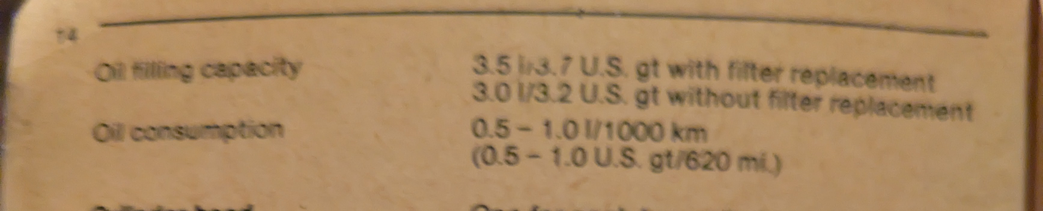

I was just looking through that porsche technical bulletin and it reminded me what they thought 'acceptable oil consumption' was.
Sorry to hear you lost your 2056. Hopefully it isn't bad.

geez.
a genius must have assembled my engine at the factory.
in all the time i have had it (36 years now) - its used precisely zero oil. no joke.
even now post its 16 year hiatus.
for a month or two after i got it going again it would occasionally blow a puff of blue smoke on start up but the rings settled back in again.
its never been apart and i am now pushing 50,000 miles (and they are genuine).
done close to 6000 miles since re-awakening it. a couple of long weekend trips in it too where you would expect to use oil if the engine was inclined to.

QUOTE(emerygt350 @ Nov 11 2025, 01:57 PM) *
That TSB is what I am experiencing. I have about 1,500 miles on my 2056 and I, too, was concerned that my engine was using too much oil.
I keep oil in the frunk at all times. I also place a level on top of my car to be sure it is...so that I get a proper oil level reading. One time I checked my oil while it was parked on the street and it read WAY low. Super important that the car be level.
