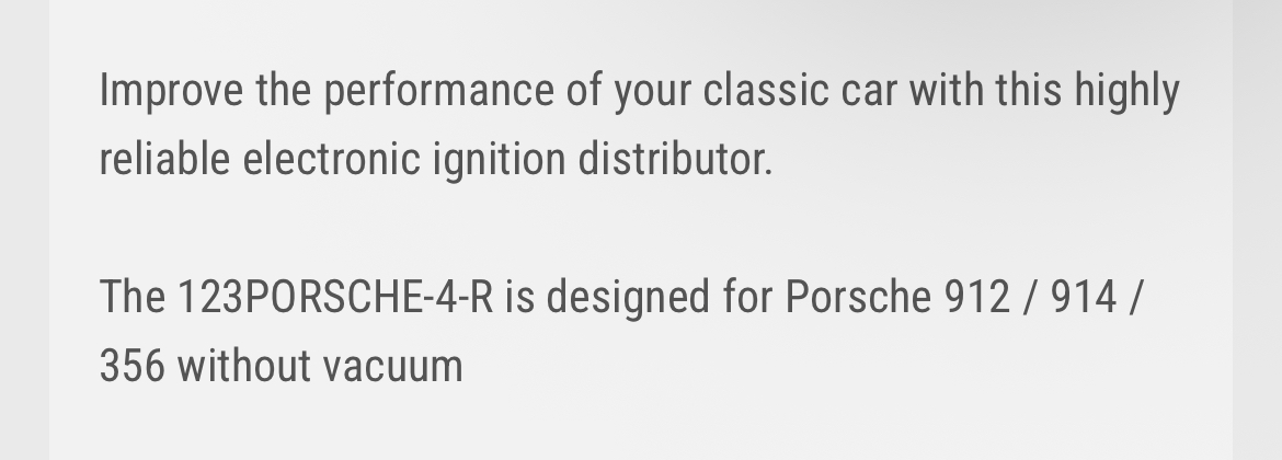

Good info - and no, I’ve got the one without a vacuum line, I believe it’s 4-R
