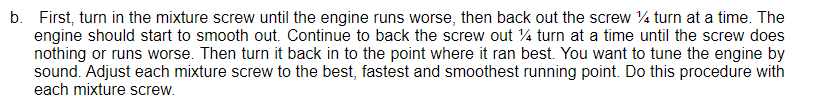

I know this isnt the whole carb tuning process but ive done the official weber guide start to finish like 3 times now so.. just going with it... I know carbs are synched by this point.
To fix the closed throttle position I backed off the idle speed screws from where they were and turned them in 1/4 turn just to keep it from dying. Thing ran like a tractor, but ran. As i turn the mixture screws in (clockwise), the idle kept raising until I screwed them all the way in - as in it never started running worse.
specifically this step:
Does this mean it's still too rich? I think tomorrow when I take it to the local P-car shop I'll ask them to try their hand at tuning them, whatever they can do - just to make sure I'm not missing the mark totally - if they can't do It either I'll know I need to change something in the setup. Would that still indicate the venturis are too big - I have the 28mm stock ones on but wouldn't that decrease air to the engine?
