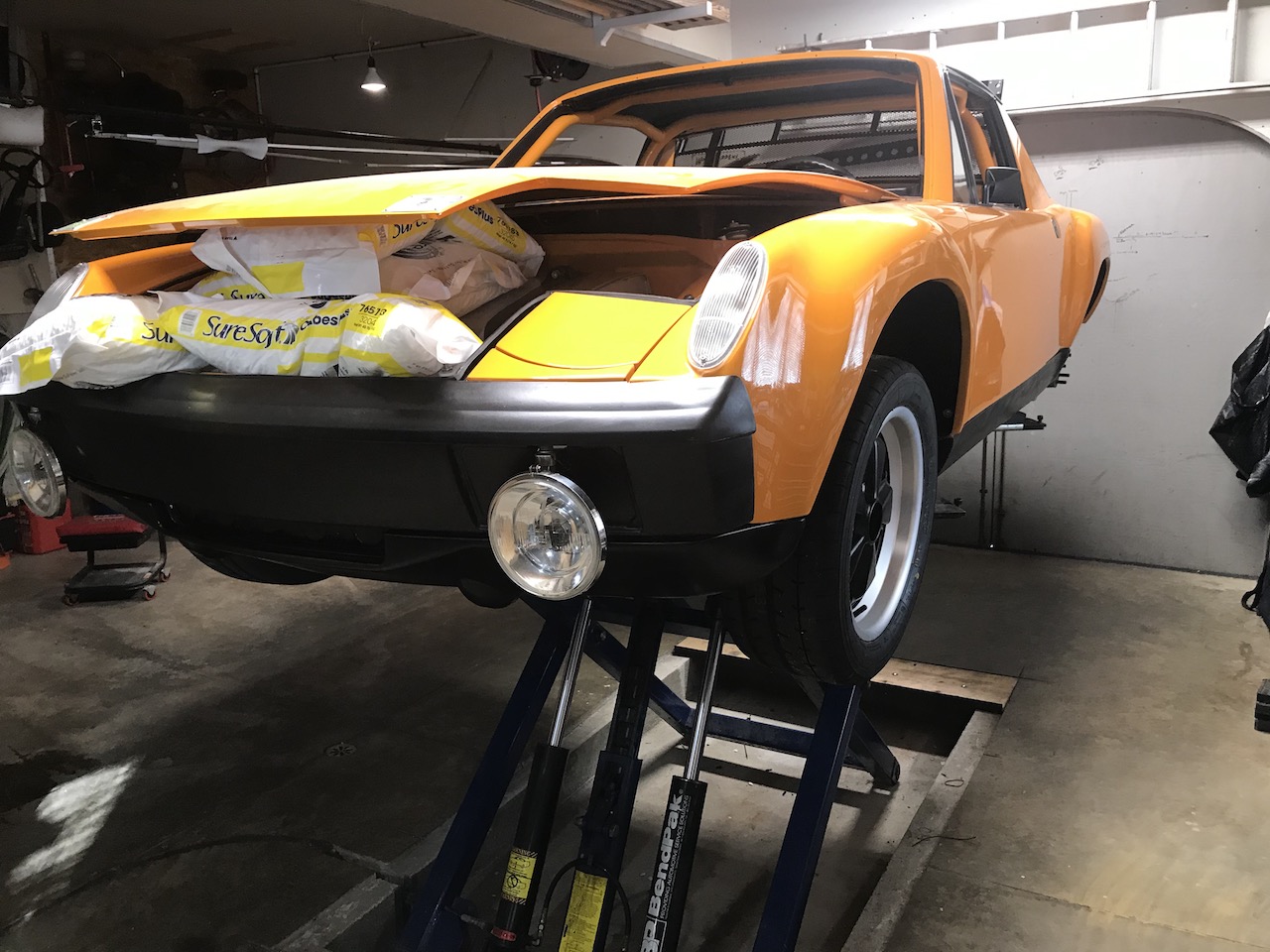

Yup, Perry Kiehl for a engine harness...just the best. I would also recommend starting with the basics. In Wisconsin, heated A/C garage, some kind of lift, build box to roll motor and trans into position. Your going to do this a few time to get everything right. And Ben McFarland has all the knowledge as to oil, exhaust, mounting. Then you go to PMB for all the brake upgrades you will want. And 914world will have the rest. Best, MarkAttached Image Attached ImageAttached Image

QUOTE(mlindner @ Dec 7 2025, 02:35 PM) *
Show off!!
wish my /6 conversion was this sweet
are you toting bags of potatoes for hire these days?
