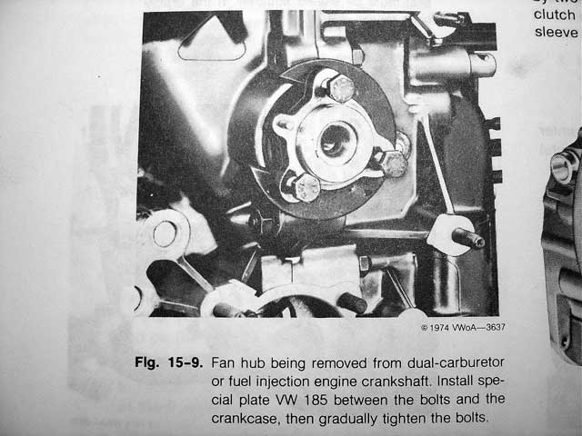

The keyway damage may have been caused by a previous removal. Some take a punch to that area. If it's interfering with reinstalling the fan hub or otherwise bothers you, they are inexpensive to replace.
There is a tool for removing the fan hub. Before I made a tool, I found that three jaw pullers are very difficult to use, mostly because there is relatively little space between the hub and the engine case. Maybe your puller fits better. But, this tool also doesn't tear up the hub or case when used to remove your hub.
You can make it yourself by cutting a rectangular slot in a stout piece of sheet metal/steel. I'd post a photo of mine, but it's hiding somewhere in the garage at the moment. (IMG:style_emoticons/default/smile.gif)
How to use/make a fan hub puller (you can ignore the rest):
https://youtu.be/DZU_-BLDNAU?si=NqYMaEUr_Ievvi78
Edit:
Assumed the case was still assembled and you haven't removed the crankshaft from the case. Of course, if you've taken the crankshaft out, you can use an appropriately sized puller and do t need to make a tool.
