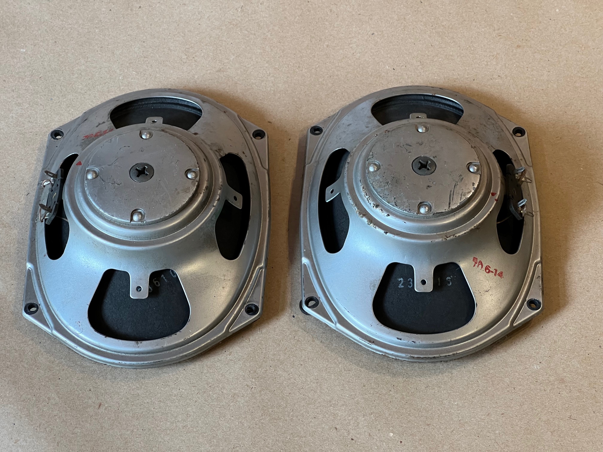

These were in my 73. Thought the room might like to see a set. Still work!
I thought they were supposed to be 4 OHM at the time.

Hmm... Coaxials?

As far as I remember, 8 ohm was pretty standard for automotive speakers back then.

I did some brief research on this. There is some evidence to suggest the early 70s radios are meant to have 8 ohm speakers. Later cars 4 ohms.
Thanks to Radiomuseum.org, I found a manual for our specific model 1970 Frankfurt US 7639670. It it indicated 5,8 ohm. The Zenith speakers in the car measure ~6 Ohm.
