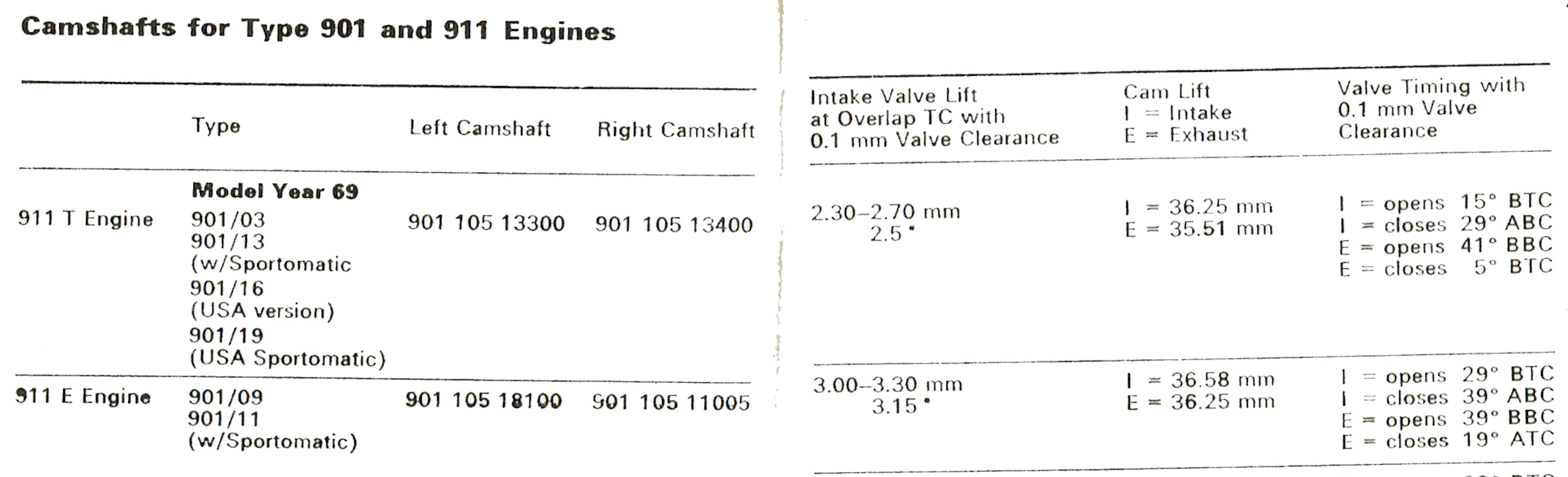

I hear E cams get nearly the same perf as S but do it more smoothly
I wish I could say from personal experience.
When I had the cams for our mostly stock 914-6 engine done by Dema Elgin he also recommended E grind. This is for spirited street driving. It has slightly higher valve lift than the standard 911T cam. If you go this route don't forget to adjust your cam timing to match.
I haven't put this in the car yet, nor do I have another car to compare against. I can only pass along his advice and specs. FWIW.
