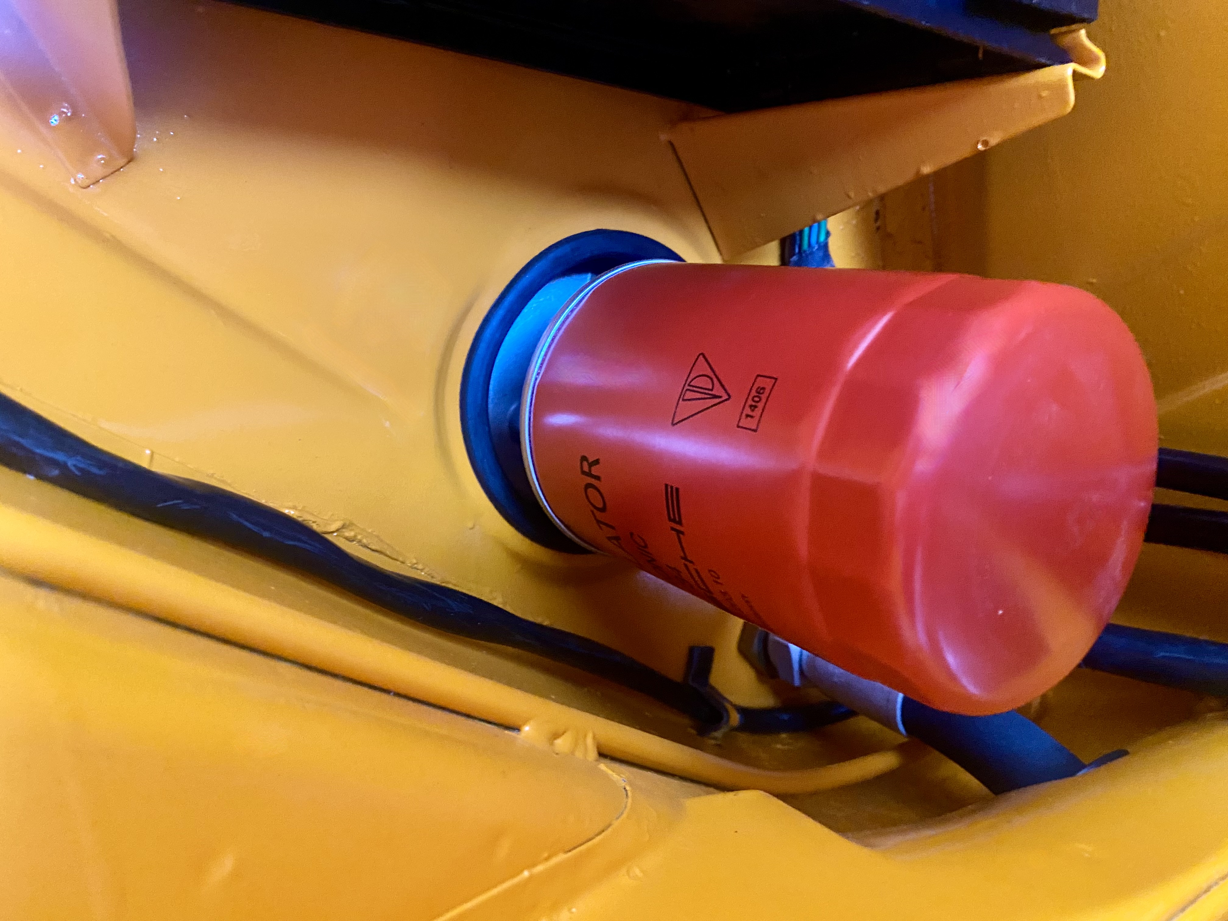

This is correct data. Here is a original 6 with the factory Purolator filter referenced. The car is running a 3.2. The stock oil tank dictates the filter needed. Recommendation is to use only Porsche filters, they have an internal bypass many aftermarkets do not.
QUOTE(smg914 @ May 8 2026, 08:44 AM) *
From what I understand either of those filters OC54 or OC61 will work on a stock 914-6. I use the red Purolator PC 34 (901.107.203.10) sold by Porsche Classic
