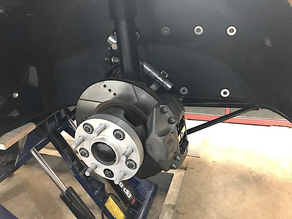

I've also not been a fan of the adapter style spacers that have a second set of studs. With those, you're basically depending on an aluminum, second hub to carrying all the forces from the drivetrain and the road. Porsche never put aluminum hubs on a rear of 914 or 911 to my knowledge - so I'm not sure how it's a good idea to have adapter/spacers made of aluminum. Perhaps for street use they'd be acceptable. No way I'd put them on anything that hits the track.

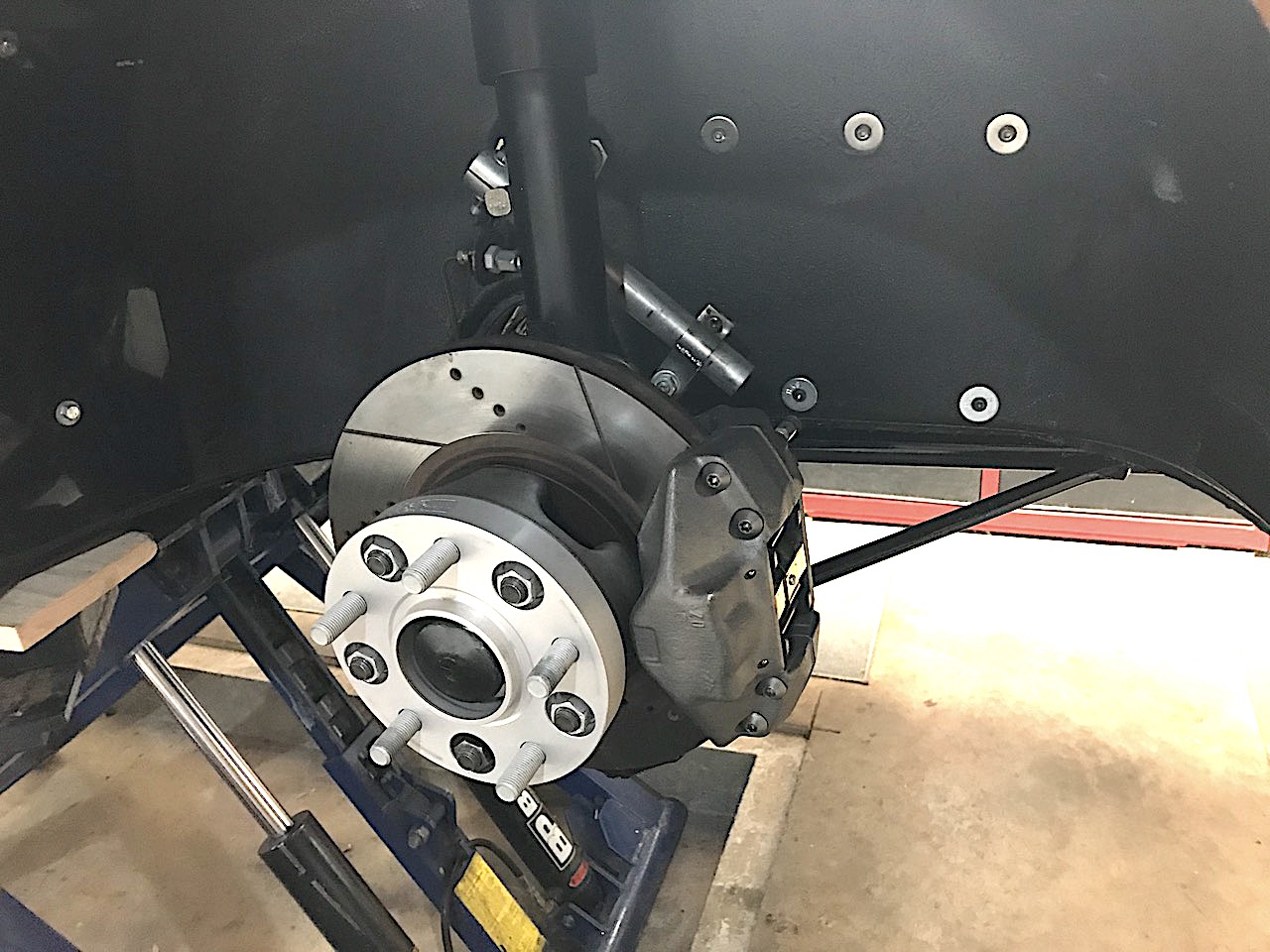

Yes Porsche did. This is my 1998 Carrera S, wide body with Spacer and lugs. Not a problem in 18 years of hard driving...Many DE Road America and Sebring. Best, MarkAttached Image

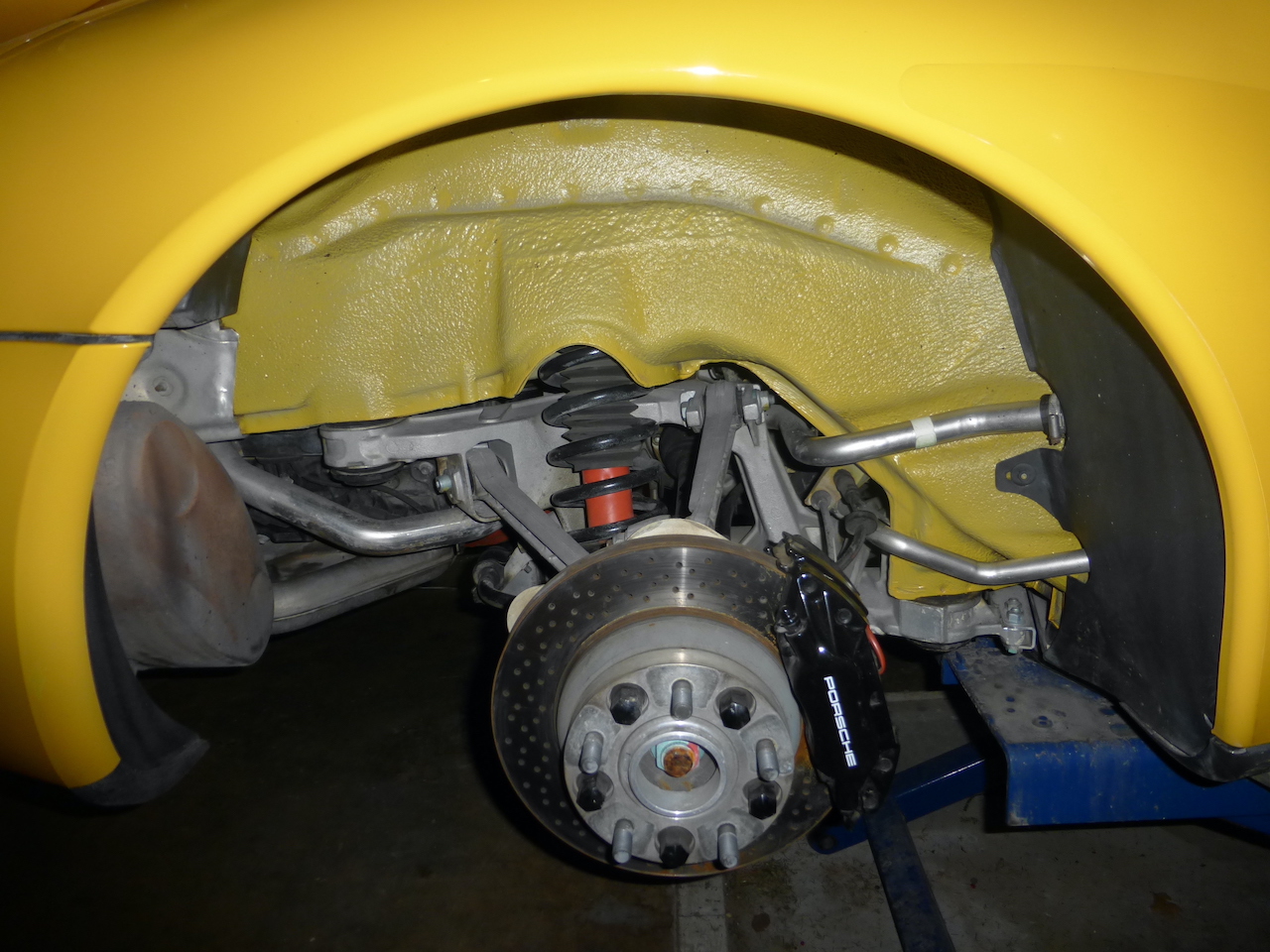

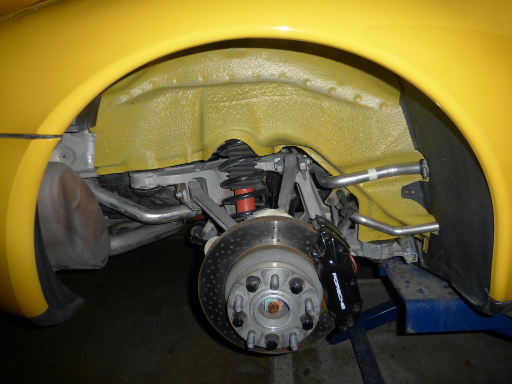

Just FYI, also have them on my 914-6 GT Tribute fronts for the last 5 years. A few auto-x, hill climbs and lot of high speed runs. Not an issue. Attached Image

Spacers, regardless of material, are not in and of themselves a problem. As long as all spacers have hubcentrics to keep them from shifting/fretting, then all of the wheel tension loads are carried through the wheel studs/bolts themselves and the spacers only have to manage the compressive/clamping loads.
Done properly, the use of spacers is no different than using wheels with a much larger offset.
The real issue with spacers/larger offset is that it's placing bending loads on suspension/bearing components that were not originally designed to handle it. I'm presuming that Porsche's 911 suspension bits were better designed to handle these larger offset wheels in the over-fender cars?
