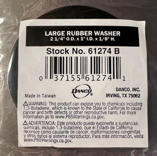

In lieu of better options, the closest thing I could find at local auto parts or hardware stores was this. ID and thickness are pretty close. OD I trimmed with some shop scissors. Found at Ace Hardware plumbing aisle.
