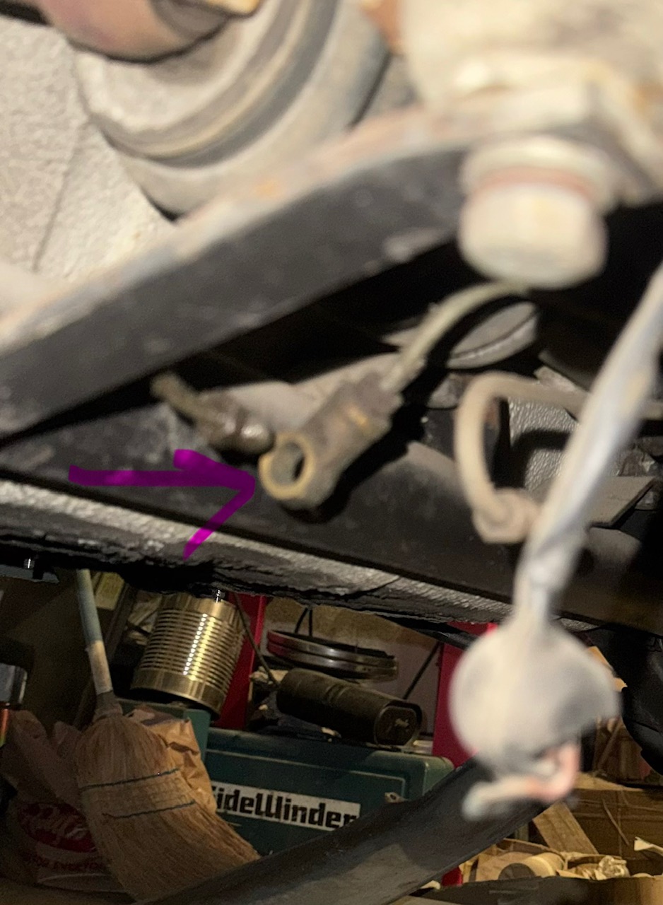

Hi Dennis, could those two washers be for this fitting? Right color...
