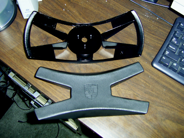

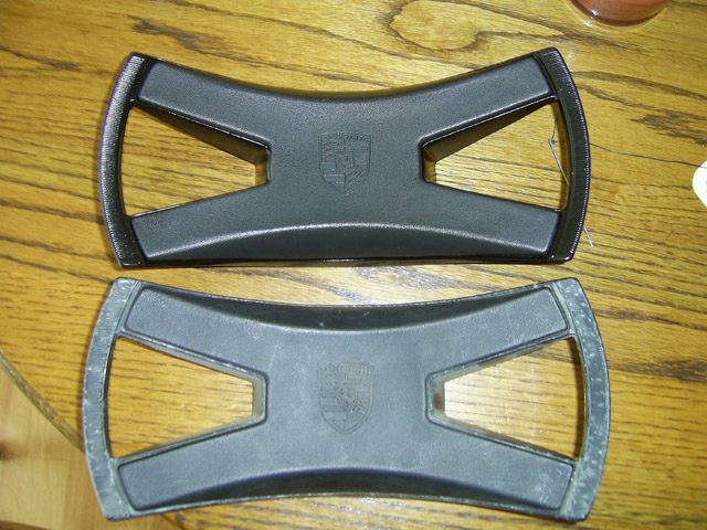

Here's a quick one of the horn button, not a before and after per se, but an example of the condition the restored one prior to refurb (actually, the rubber part of the "refurbed" button was in much worse condition filth-wise, than the "un-refurbed" one shown). The paint on the refurbed one isn't really as shiny as the pic shows (it's semi-gloss), must've been the flash.

Okay, here's a quick rundown on what was involved:
1). Separate the rubber center from the metal.
I used a metal machinist scale (a thin metal 6" ruler), but a hacksaw blade with the teeth ground off would work good also. From the backside of the button, work the blade back and forth between the rubber and metal to release the glue.... take your time, if you put too much outward pressure, particularly towards the outer end of the rubber, it will crack. (IMG:http://www.914world.com/bbs2/html/emoticons/headbang.gif) . It's hard to tell from the photo, but in the lower righthand spoke of the horn button, there's an alignment post cast into the metal about 3/4" in from the edge (and corresponding hole in the rubber button). So when doing that particular section, keep in mind you'll have to go to the right and left of it to get to the glue. Narrowing the hacksaw blade a bit will help in getting to the outer part of that section............Wah-Lah.......rubber is off.....take a swig of your beer that's been getting warm while you were messing with it. (IMG:http://www.914world.com/bbs2/html/emoticons/beer.gif)
2). The metal part.
DO NOT REMOVE THE OLD PAINT MECHANICALLY!!
The reason for this is that the tiny ribs on the outer part of the horn button will be gone before you'll get paint between them removed, and if you leave any paint inbetween them, they'll disappear when you go to prime and repaint (read: look like crap when you're done). I used Aircraft Stripper (from the FLAPS...absolutley wear protective gloves, and a face shield....wicked stuff), and it worked fantastic, it even got the old glue residue off. A small brass brush also helps get the stubborn bits of paint out from between the little ridges. Thoroughly rinse the stripper from the horn button (garden hose and brass brush), let dry completely, lightly prime, and paint semi-gloss black (I fed bailing wire through two of the screw holes in the center of the button so I could spray all sides at the same time, and hung it to cure)......another swig of beer is in order...you deserve it! (IMG:http://www.914world.com/bbs2/html/emoticons/beerchug.gif)
3). The rubber button was filthy, but uncracked...
...so I thought that a good scrubbing in liquid detergent and water would do the trick. Scrubbed it three times, and it still looked dull and dirty when it dried (IMG:http://www.914world.com/bbs2/html/emoticons/headbang.gif) . I finally got it clean by using GOOP handcleaner and a toothbrush to get down into the grain (what I use on my Nikes to get the work grime off of them). I was absolutely shocked by how much more crap came off with the cleaner, even after 3 scrubbings in soap and water (IMG:http://www.914world.com/bbs2/html/emoticons/ohmy.gif) . I got a clean rag, and buffed it like it was Aladin's Lamp until all of the cleaner was removed, and Shazam! Looks friggin' new, but not ArmorAll shiny. (IMG:http://www.914world.com/bbs2/html/emoticons/smilie_pokal.gif)
Note: Keep the GOOP off of the backside of the button, you don't want the lanolin in the cleaner to interfere with the glue when you put it back together.
4). After the paint is completely cured, apply a thin coat of rubber cement to the bottom contact points of the metal and rubber pieces. You don't want any glue on the sides or you may get "sqeeze out" of the glue, and ruin the beauty of your newly refurbed horn button....crack a new beer, 'cause that one you opened at the beginning of this refurb is piss warm by now (IMG:http://www.914world.com/bbs2/html/emoticons/icon8.gif) , and you deserve a "cold one"

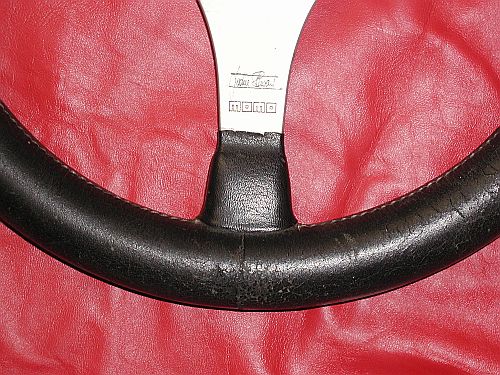

The stitching should be approx. 1/8" back from the edge of the leather, and 3/16"-1/4" apart. When you measure the circumference of the grip, subtract about an 1/8" from that measurement and "stretch" the leather together with the stitching, or you'll end up with a much nicer looking seam, and no puckering.
