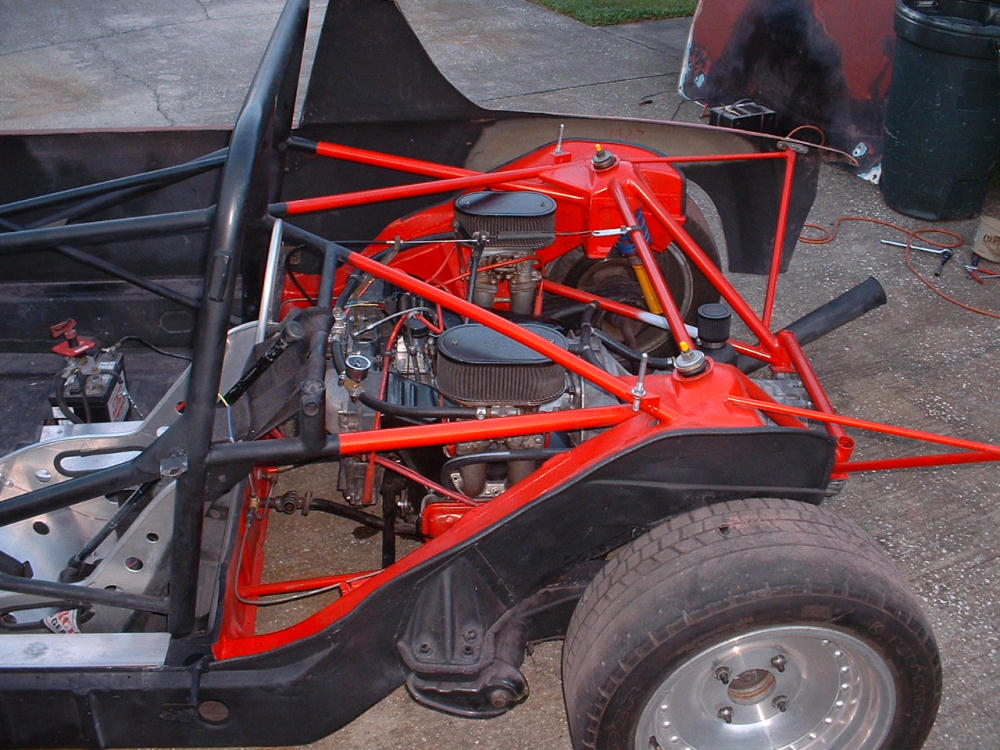

I built the lightest 914 in the history of mankind. ![]() ![]() ![]() ![]() ![]() ![]() ![]() ![]() ![]() ![]() ![]() ![]() ![]() ![]() ![]() ![]() ![]() ![]() ![]() ![]() ![]() ![]() ![]() ![]() ![]() ![]() ![]() ![]() ![]() ![]() ![]() ![]() ![]() ![]() ![]() ![]() ![]() ![]() ![]() ![]() ![]() ![]() ![]() ![]() ![]() ![]() ![]() ![]() ![]() ![]() ![]() ![]() ![]() ![]() ![]() ![]() ![]() ![]() ![]() ![]() ![]() ![]() ![]() ![]() ![]() ![]() ![]() ![]() ![]() ![]() ![]() ![]() ![]() ![]() ![]() ![]() ![]() ![]() ![]() ![]() ![]() ![]() ![]() ![]() ![]() ![]() ![]() ![]() ![]() ![]() ![]() ![]() ![]() ![]() ![]() ![]() ![]() ![]() ![]() ![]() Group: Members Posts: 134,966 Joined: 3-February 03 From: Jacksonville, FL Member No.: 222 Region Association: None |
Any flex in the car is force that is not being transmitted to the ground.
You need to stiffen the car to allow the suspension to react to the loads being placed on it by the track. |

it comes down to a rules/class versus weight issue. 1st, you'll find that only highly modified classes allow you to tie into suspension points, and you had better be wanting to play in those classes before you do it. 2nd, you really don't need it unless you cut out the factory metal. ie: if you cut out the entire rear trunk floor pan and firewall between the shock towers then you need bars to replace the strength you've taken out. 3rd, weight....... the way I interpret JP's comments about picking with care are exactly the way I chose what to brace and what not to brace. Bars can get heavy. I wanted my car to be light. I added as few braces as possible to get the maximum cost=benefit from the weight penaly. thats my story and I'm sticking to it. plus I'm happy with my car weight when I got done. brant |

You crack me up, perhaps a bit much for a street car though. How much does it weigh with the body on and you sitting in it? (Nice tire, BTW) |
