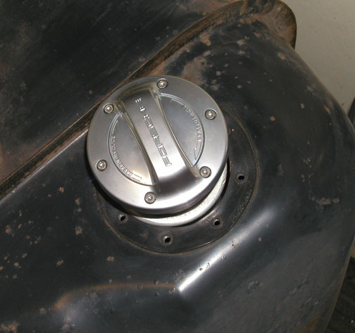

Take a look at this one.
I think with some reall good measuring, you could make this work...not the way it works on a motorcycle tank, but the idea...
Im thinking that the cap should be accessible from the outside, but look flush...try to blend it in.
Hotch Gas cap
Rich

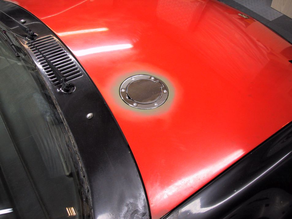

neo914-6
post Dec 15 2005, 10:42 PM
neo life
Posts: 5,086
Joined: 16-January 03
From: Willow Glen (San Jose)
Member No.: 159
This fits my theme better (IMG:http://www.914world.com/bbs2/html/emoticons/wink.gif)
