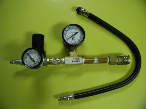

I made this one out of $20 dollars worth of Harbor Freight & hardware store parts.
Did you do the test w/ the engine cold? I got a reading of 12% leakage cold. That reading went to 3% w/ the engine warmed up.
