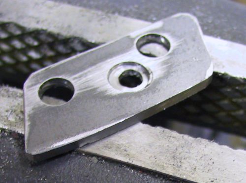

So, I took the spacers from the front calipers that I have, but they're 7.5 mm thick.
michel richard
post Jan 15 2006, 08:41 PM
Posts: 1,291
Joined: 22-July 03
From: Longueuil, Québec
Member No.: 936
I figured it might be easier to simply add a second thin spacer, rather than build a thicker one. Not sure it's going to be the final solution, but I had the thin stock handy. This is really a test piece:

and bolted up.
As far as I'm able to measure, the two spacers clamped together end up being 10.3 mm thick. Close enough.
