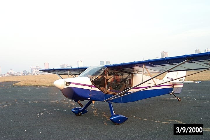

We made these...
very easy technique great results.
