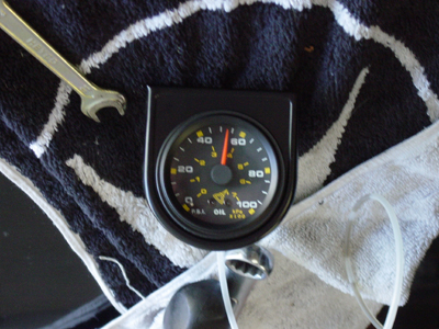

I had the same problem a week ago! I went out and purchased a mechanical pressure gauge and installed it! There was plenty of pressure so it is the sender that was bad!

The gauge!

Keep in mind the photos are of a 6 so it will be a bit different on a 4! It cost me $19.99 to check it!
